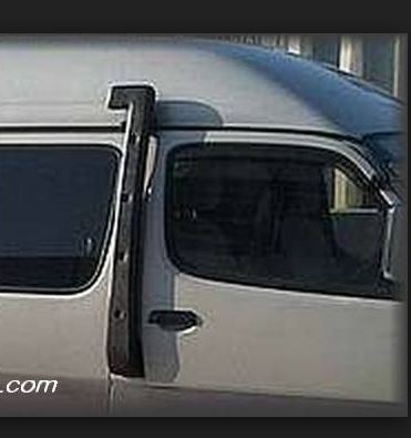

You can get snorkles for these but cannot find the part number. I looked overseas but never found a source for one.
