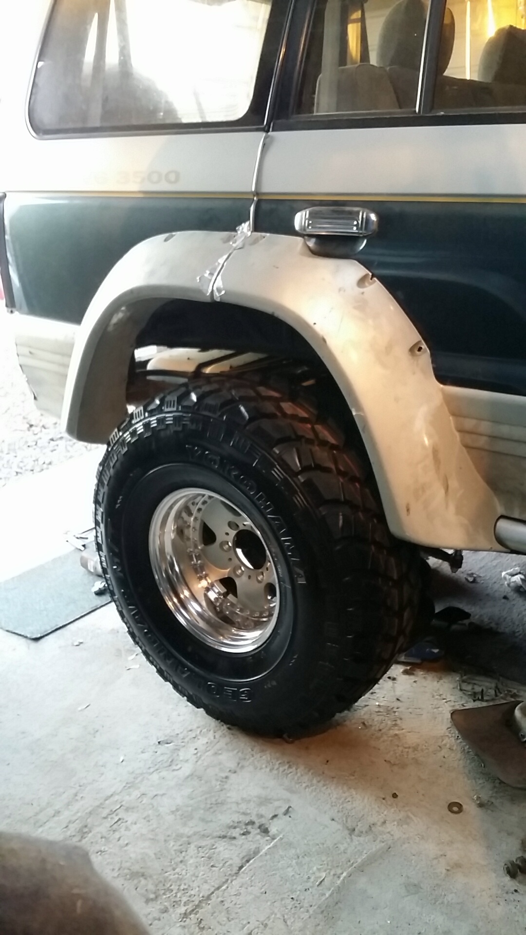

Bit more progress this weekend. Got the winch cradle half complete, its looking good but ran out of argon for the tig so will hopefully do some more next weekend.
And mocked up the new geolanders with the big flares.

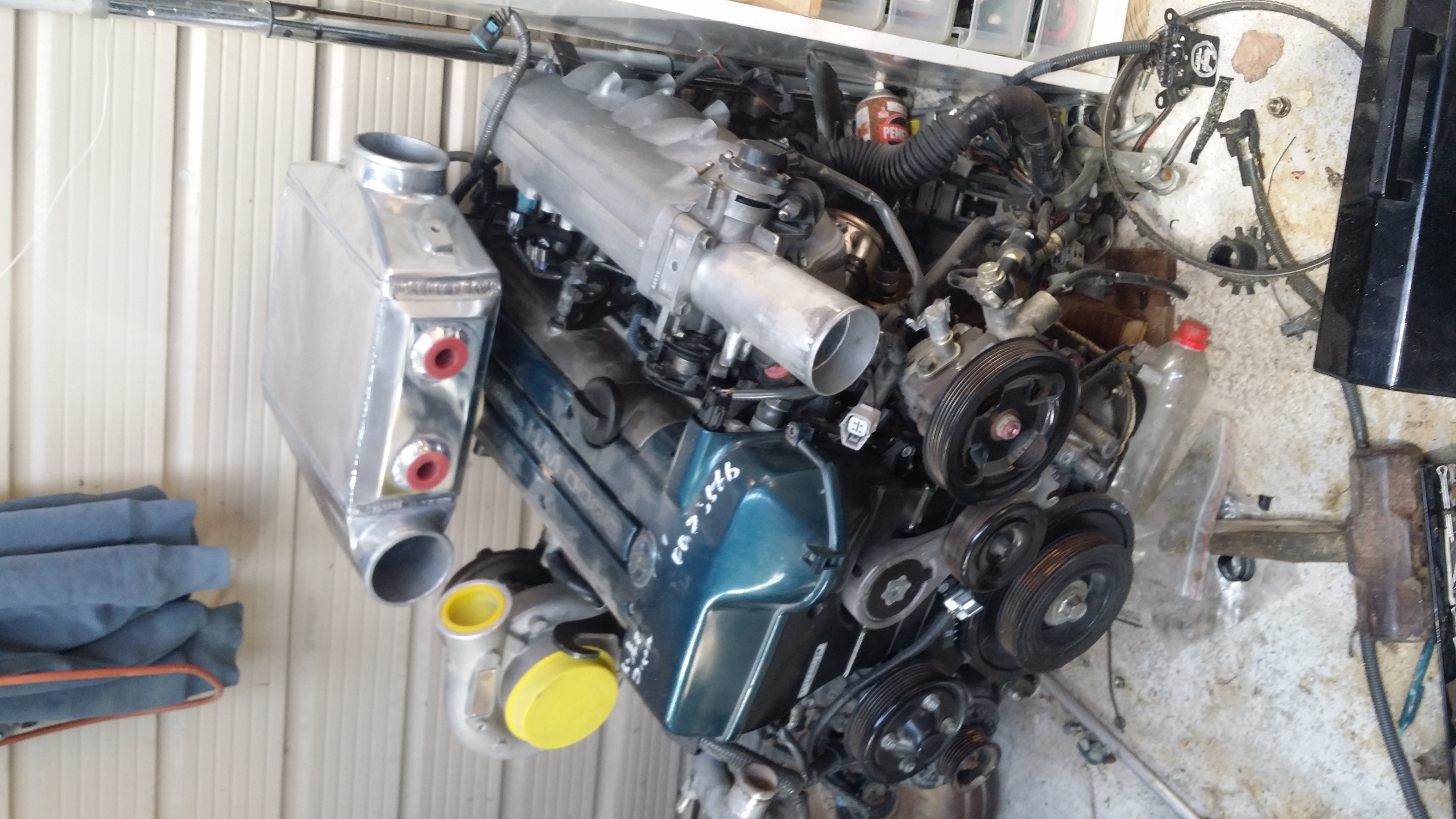

The motor with its water to air intercooler, and non vvti inlet manifold, to delete the fly by wire throttle body.

Chris443 wrote:Hey that setup of yours looks pretty promising so far! I like what you have done, is it still factory track width?
Thanks mate, standard width currently, Running 7" rims really deep backspacing that hug the hubs and 33x9.5 BFGs, rebuilt 8" 4-pin front Nissan LSD with solid pinion spacer. Final drive ratio 4.875:1. And transfer 2:1. So no where near low enough.
Upper a-arms are about 10mm longer but will be extended 50mm from the centre of the upper BJ mount with brackets made from same strength material as arms, very little leverage then use massive lower balljoint as upper because it will be load carrying.

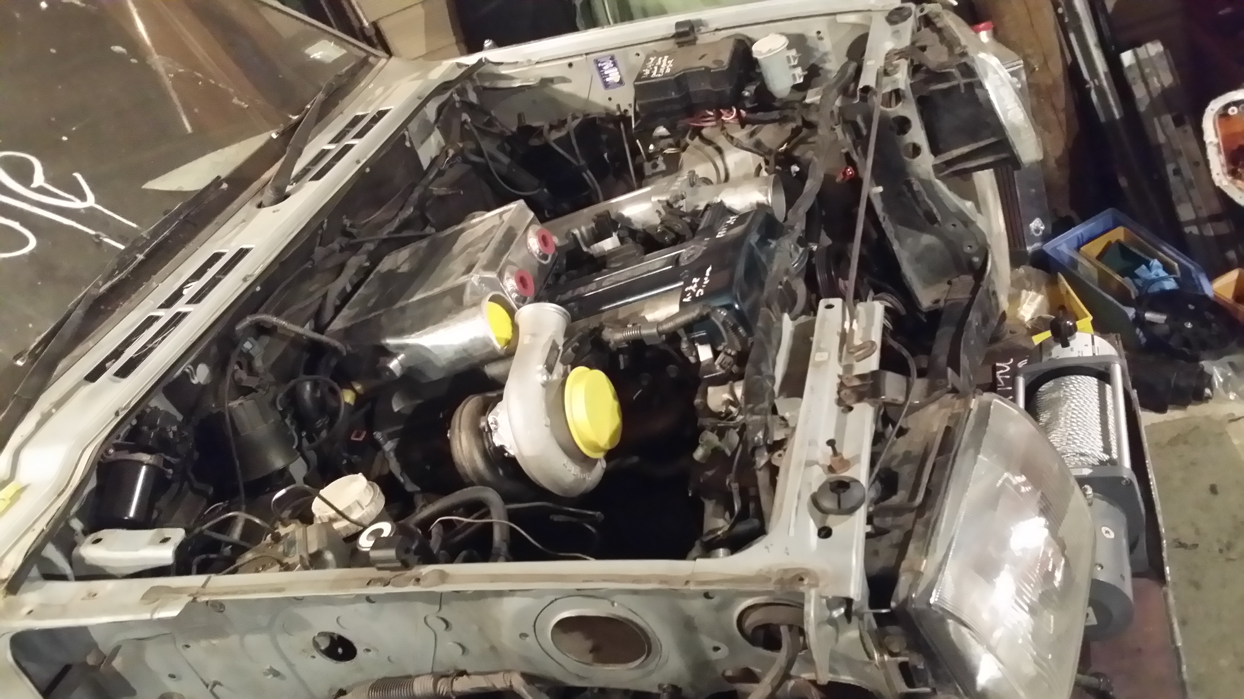

Managed to get some time to work on the truck this weekend. First up my sump pan is all notched and finished to clear the diff, and sump bung relocated to make oil changes easy as

Postby Chris443 » Fri Mar 25, 2016 10:12 pm
Productive day today, the motor is in!

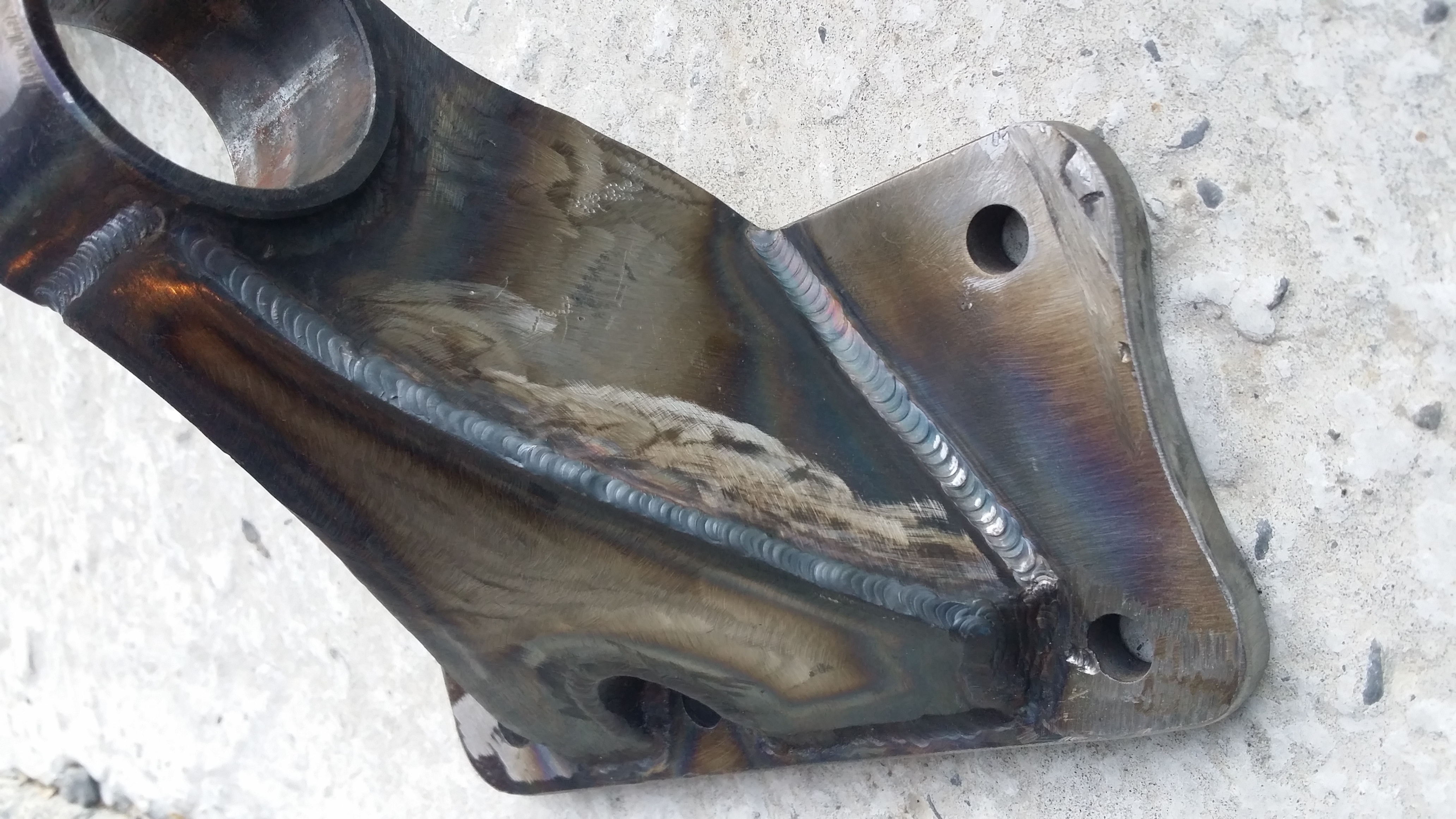

Postby Chris443 » Sat Apr 16, 2016 10:16 pm

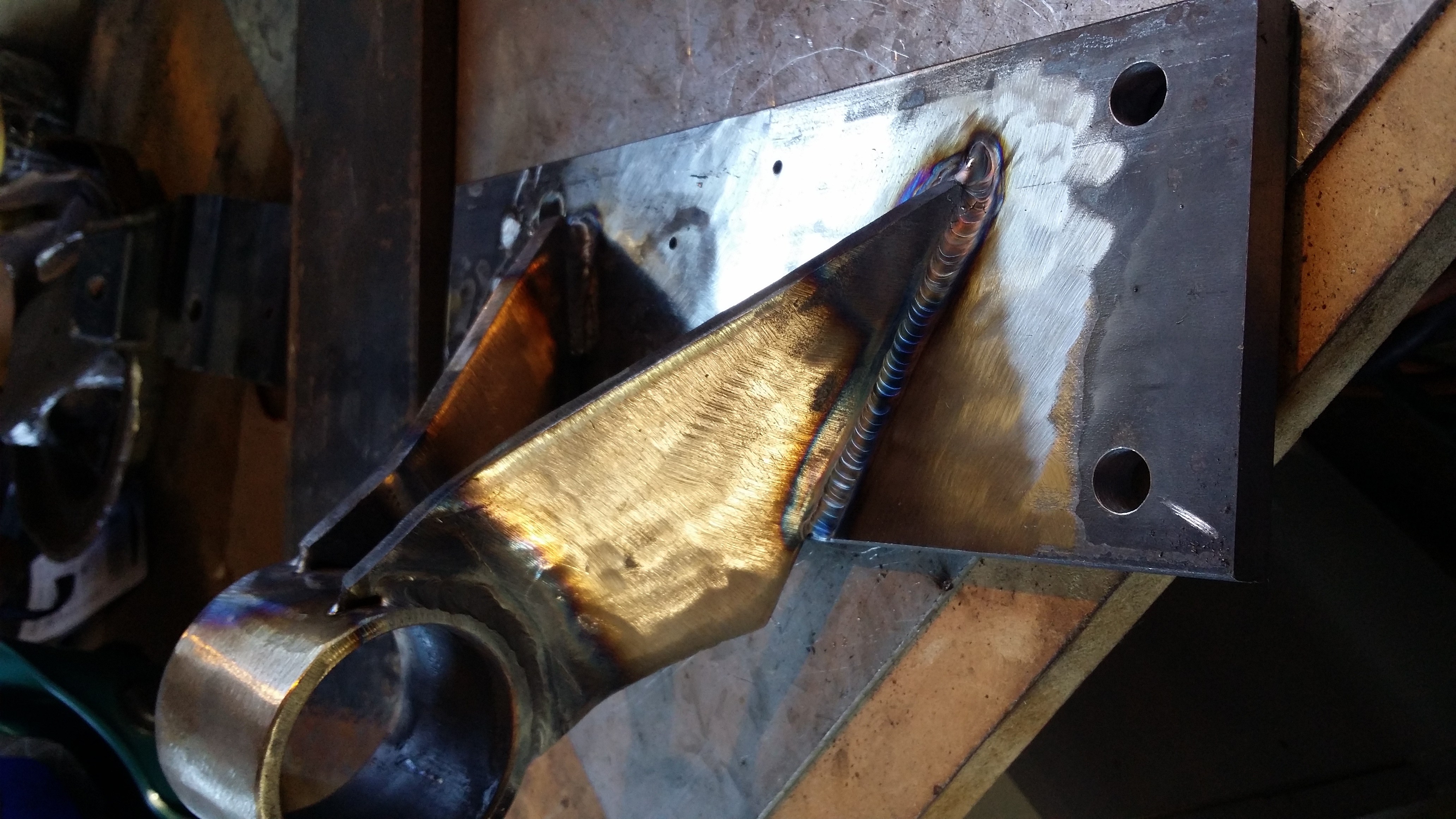

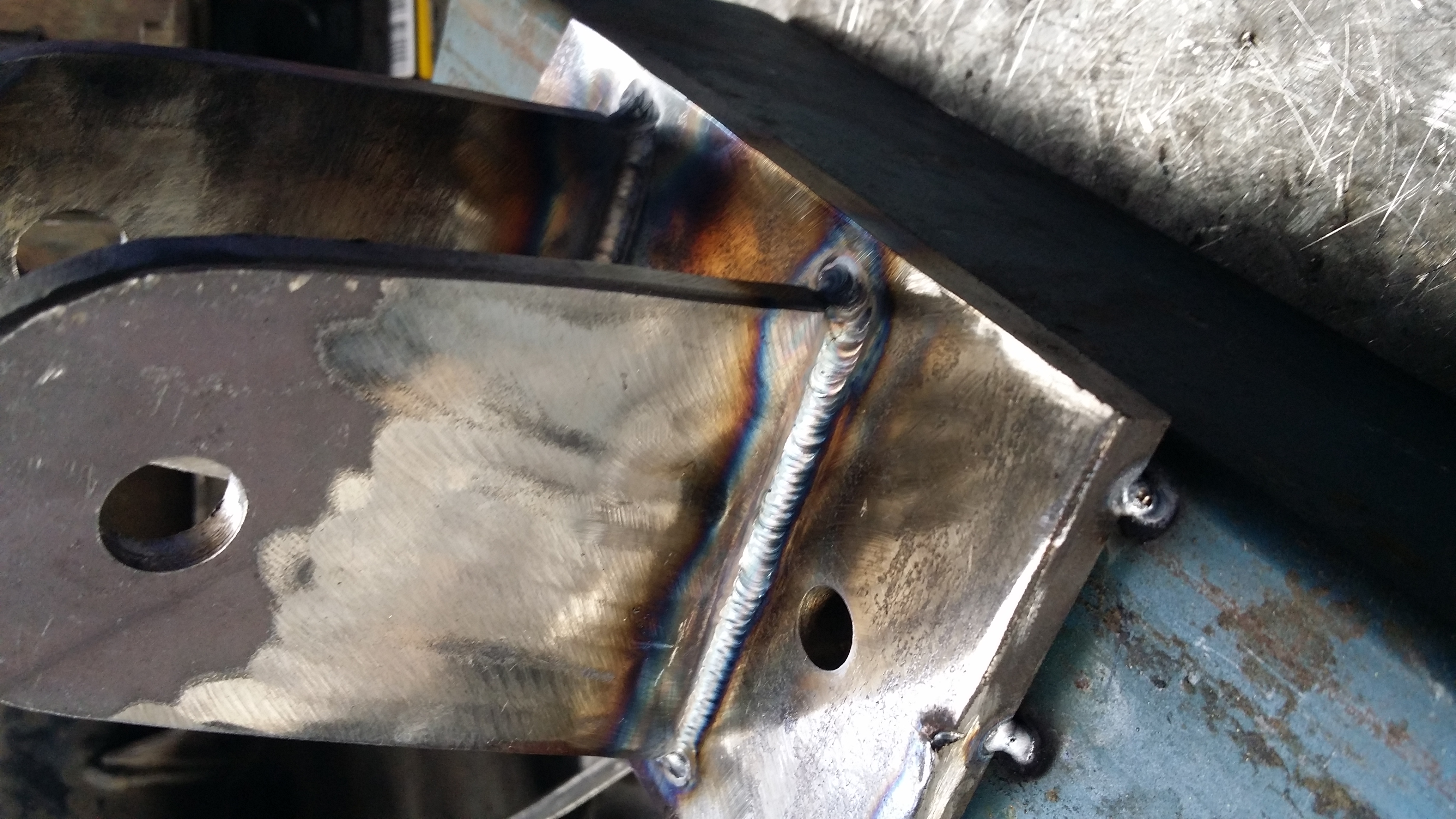

Time for an update,many hours have gone into the truck in the last few weeks, but my engine mounts are now all finished. The motor sits exactly where i want it, and its looking really nice in the hole!!
It dosent look like much work but that lot took me around 40 hours to make. Base is 10mm, sides are 7mm and backing is 3mm. Using y60 safari rear control arm ends and bushings for the mounts. They have come out well, fair to say I bloody love my tig!!!

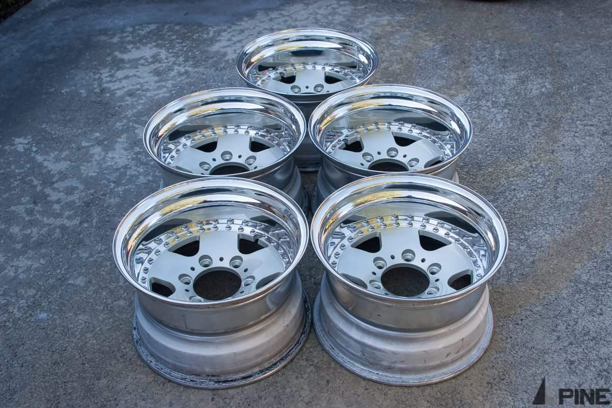

Postby Chris443 » Sun Apr 17, 2016 7:44 pm

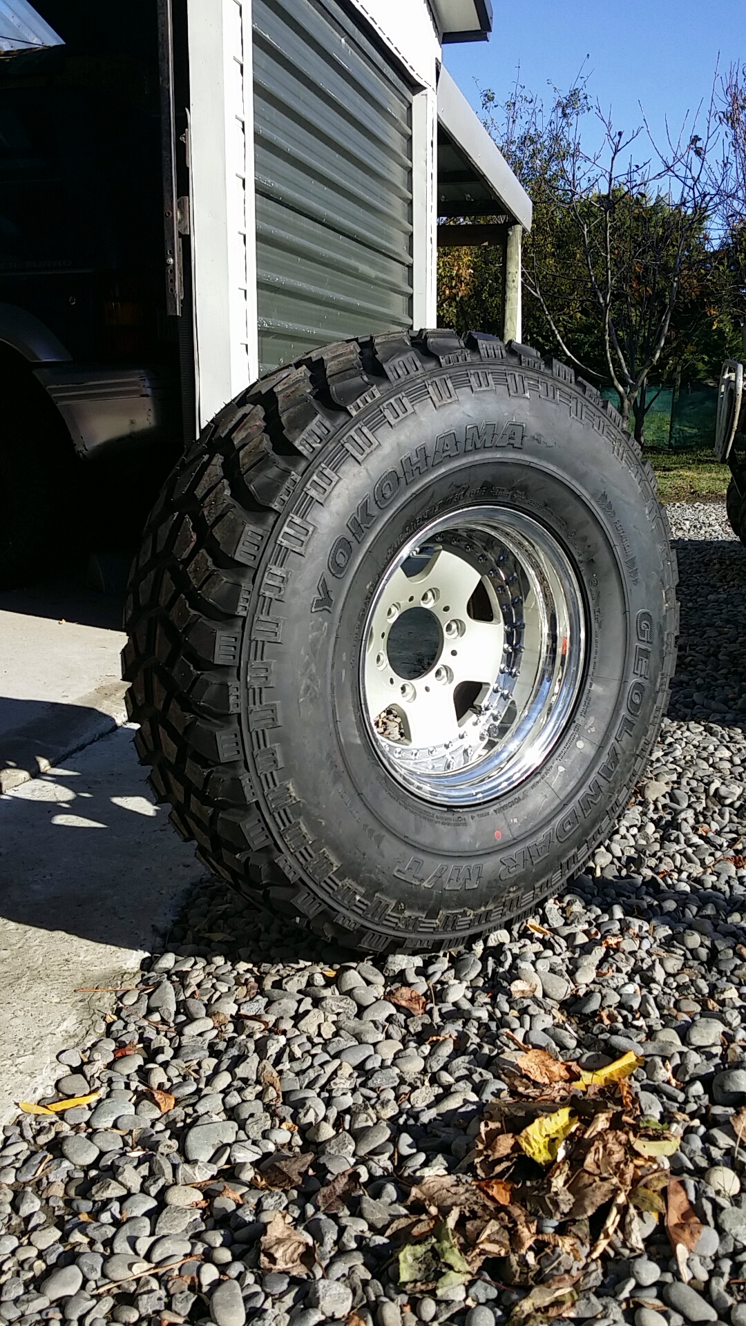

Got my wheels back from pine engineering a few weeks back, they look amazing, very pleased with them. Now to fit up the tyres.

Joined: Fri Nov 27, 2015 8:28 pm
Re: My Pajero build. The Whale mk2.
Postby Rusty » Sat May 21, 2016 10:38 am
Neat TIG welds there fella!
Chris443
Posts: 41
Joined: Thu Jan 28, 2016 10:37 pm
Postby Chris443 » Mon Jun 13, 2016 8:07 pm
Rusty wrote:Neat TIG welds there fella!
Thanks Rusty, slowly improving, I really don't get as much time on my tig as I'd like but getting there.

Tyres fitted to rims last week. Getting these dirty for the first time is gonna make me cry a little I think haha.
