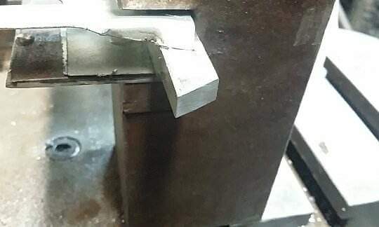

Postby Mattrade » Thu Mar 08, 2018 11:28 am
Made a key way to lock out the cam on the brake shaft. Now there is no force applied to the c clip.

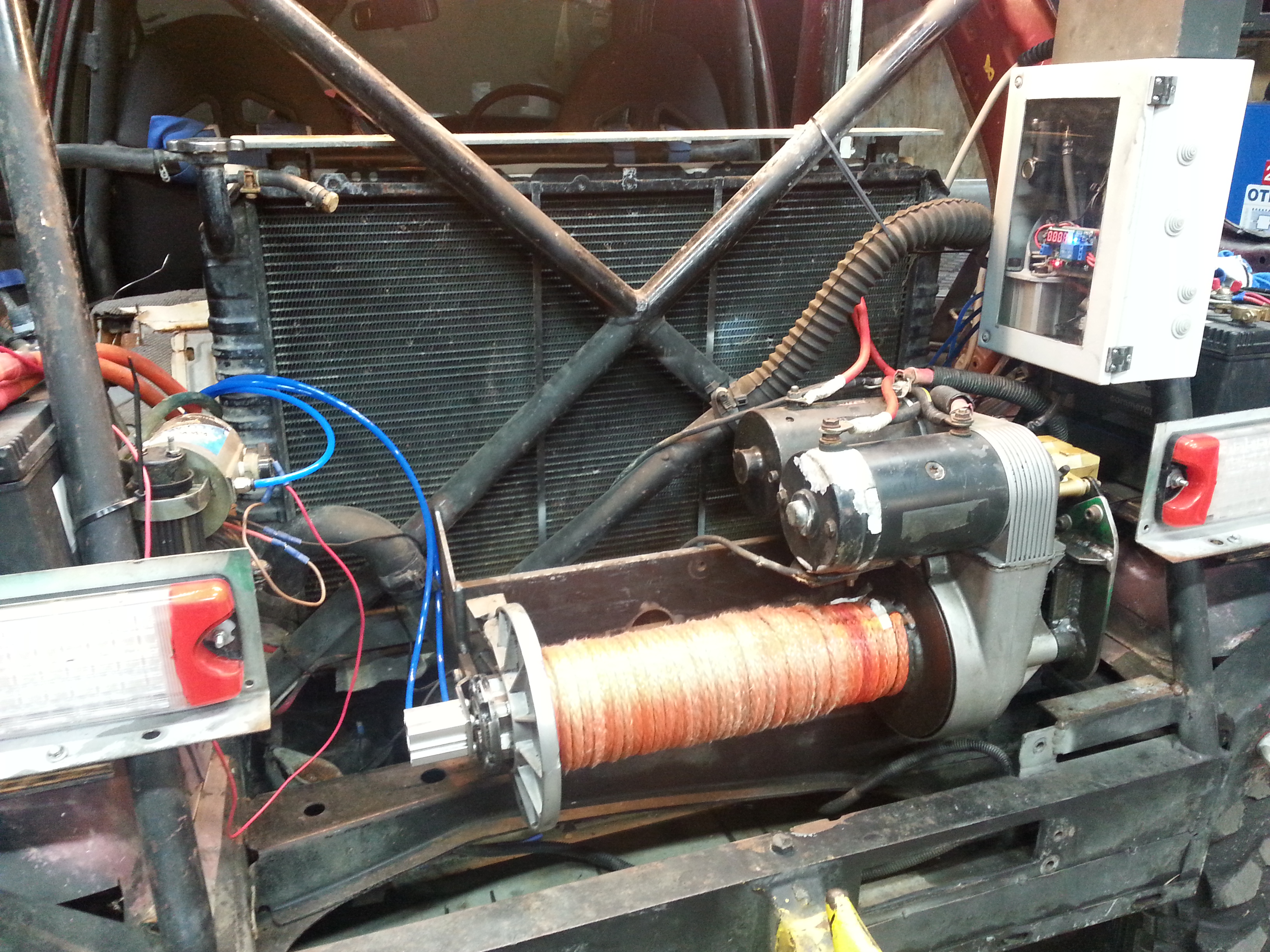

Postby Mattrade » Thu Mar 08, 2018 12:37 pm
Used a bit of tube to gusset the brake master cylinder bracket.
Mounted the brake cylinder, air solenoids and control wiring in an ip 56 rated box. Cut a perspex window out to keep an eye on it.

Clever guy. Couldn't you have mounted the freespool controller etc in the cab & just run the hydraulic hose to the brake?
keithal
Posts: 387
Re: Warn 8274 DIY upgrades
Postby keithal » Wed Mar 14, 2018 3:26 pm
mudtroll wrote:Clever guy. Couldn't you have mounted the freespool controller etc in the cab & just run the hydraulic hose to the brake?
Looks like it's mounted in the back of the truck as it is so out of the shit anyway
Mattrade
Posts: 377
Postby Mattrade » Thu Mar 15, 2018 8:48 am
Its stays clean out the back and nice and high to keep it out the soup. Could look a bit better but works for now.

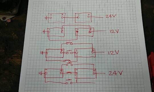

Postby Mattrade » Mon May 14, 2018 5:15 pm
I used an old warn solenoid pack to make the 24v supercharger. Works mint.....but burnt out ha ha to be expected.
