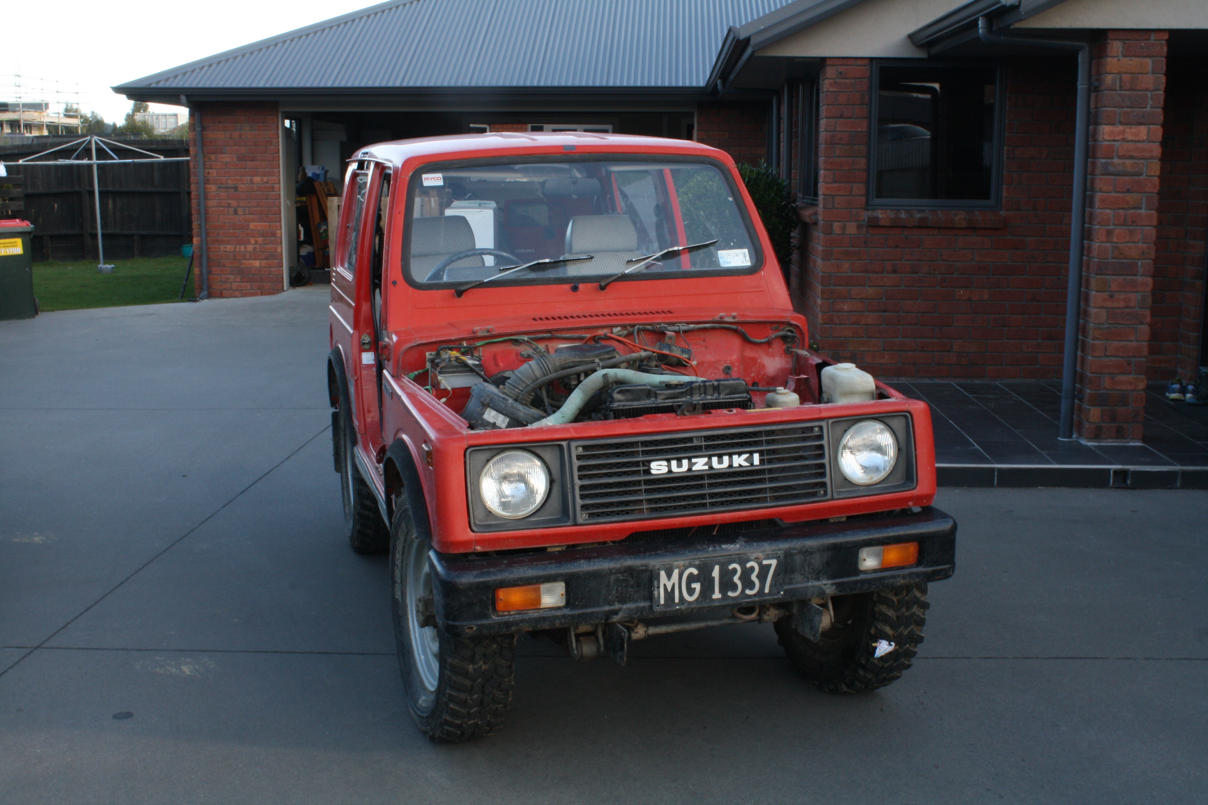

G'day all.
At about the end of August last year I got a 1987 model SJ413 Samurai.
What its got :-
Standard 1.3 N/A engine
30in Dunlops
16 inch steel rims
As I have only just turned 16 :shock: I haven't been able to drive it on the road yet (legally LOL).
Its not really mine but I call it that :mrgreen:
So far I have : -
Changed oil & oil filter
Reset leafs
New water pump
Reconditioned the radiator
(I know that some of these things are maintanence but all the same :roll: )
So after getting more and more depressed with its condition sitting in the drive after a few outings I drove it into the garage and got to with a bit of work on it.
We got it off a guy at work that had gotten it for free but it just ended up sitting on his land doing nothing. A tree fell on it so there are a few dents and for some unbeknown reason the rust on the right side is worse than the left, but anyway.

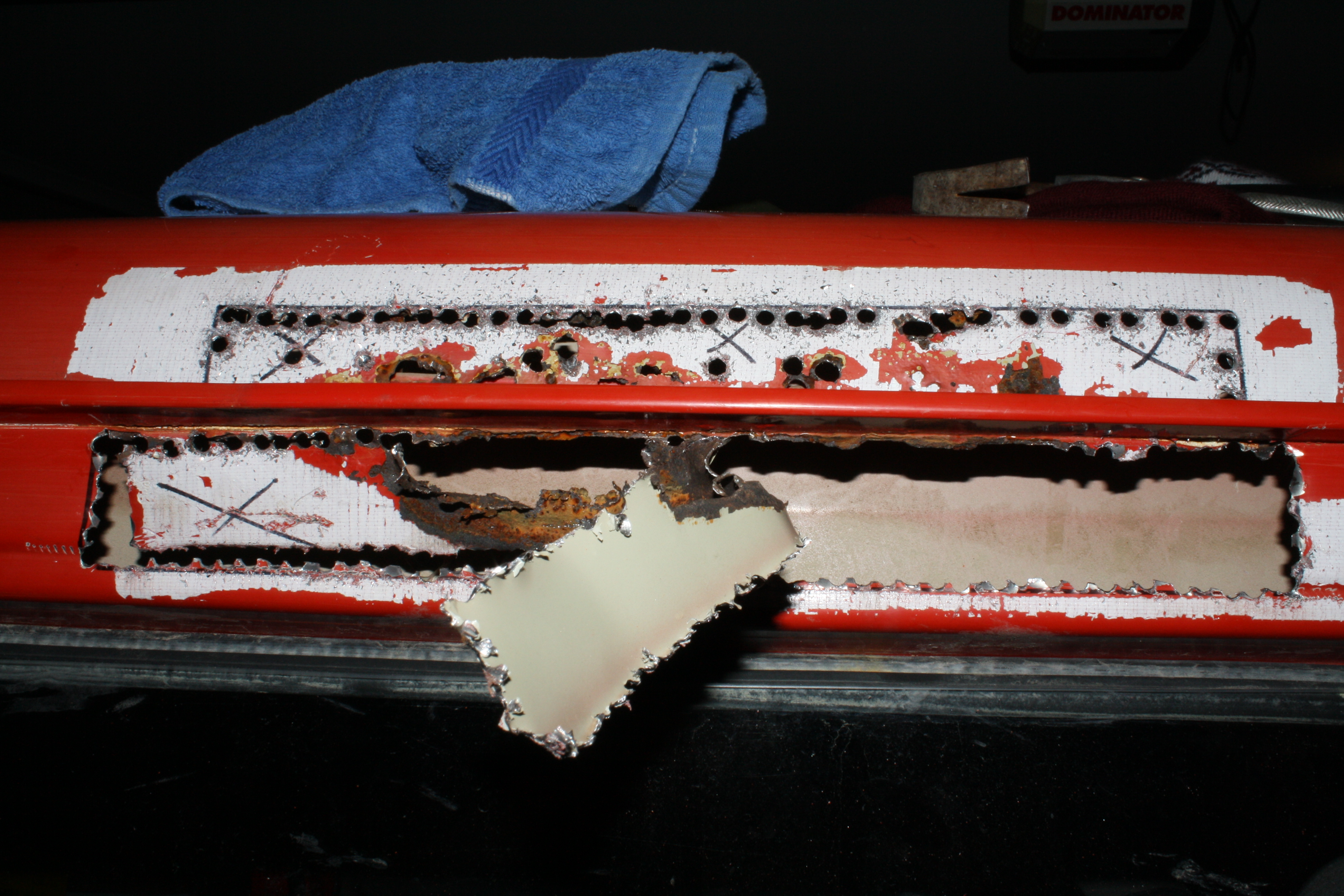

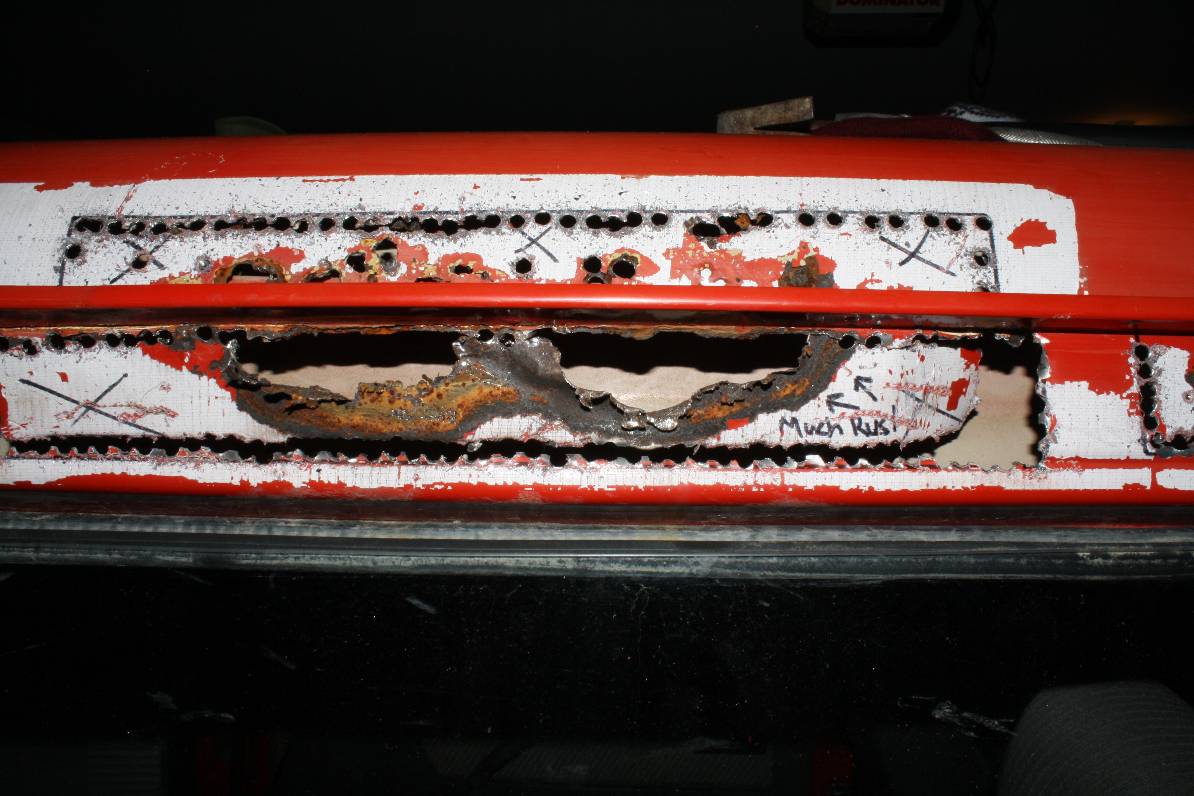

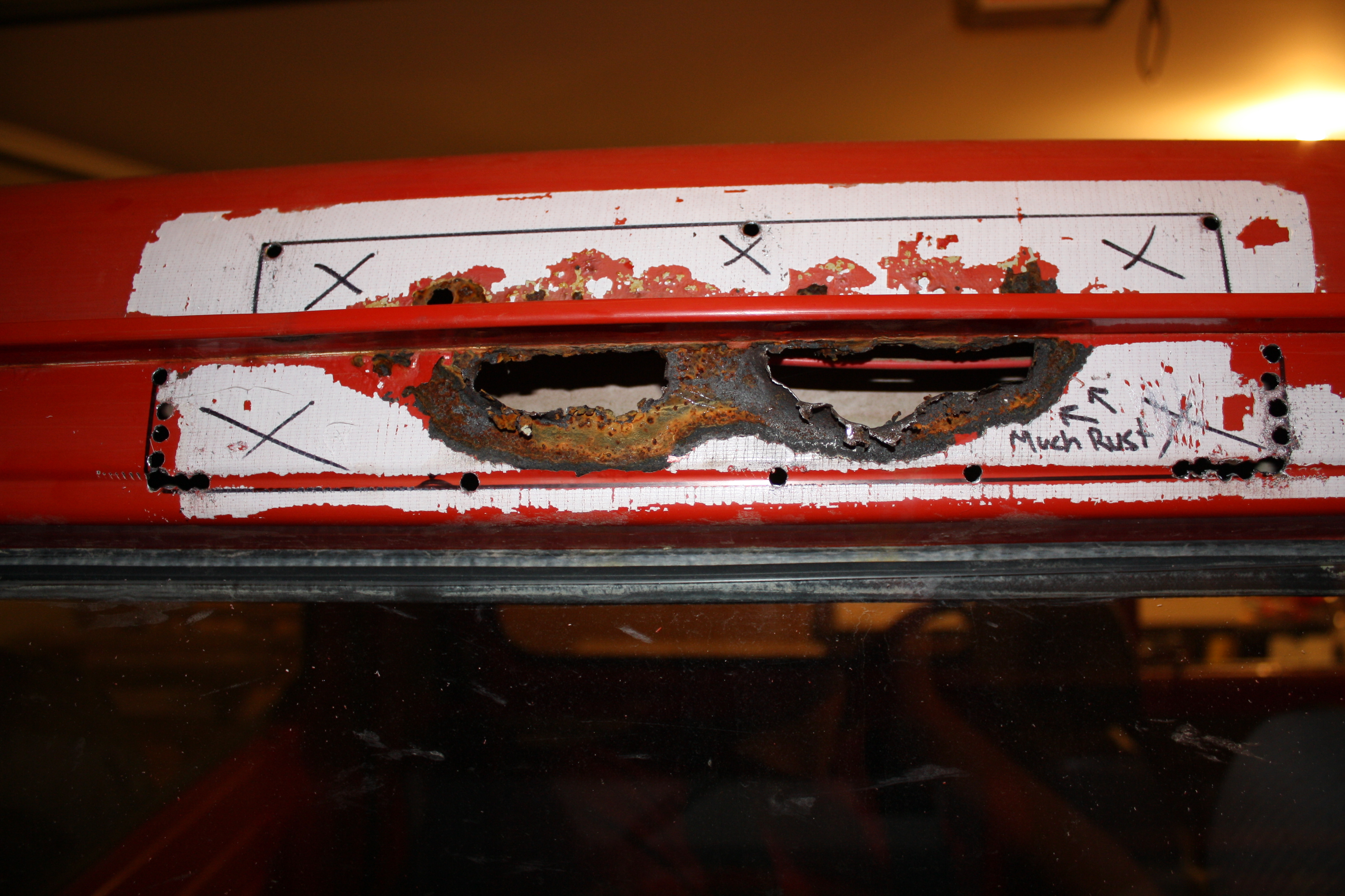

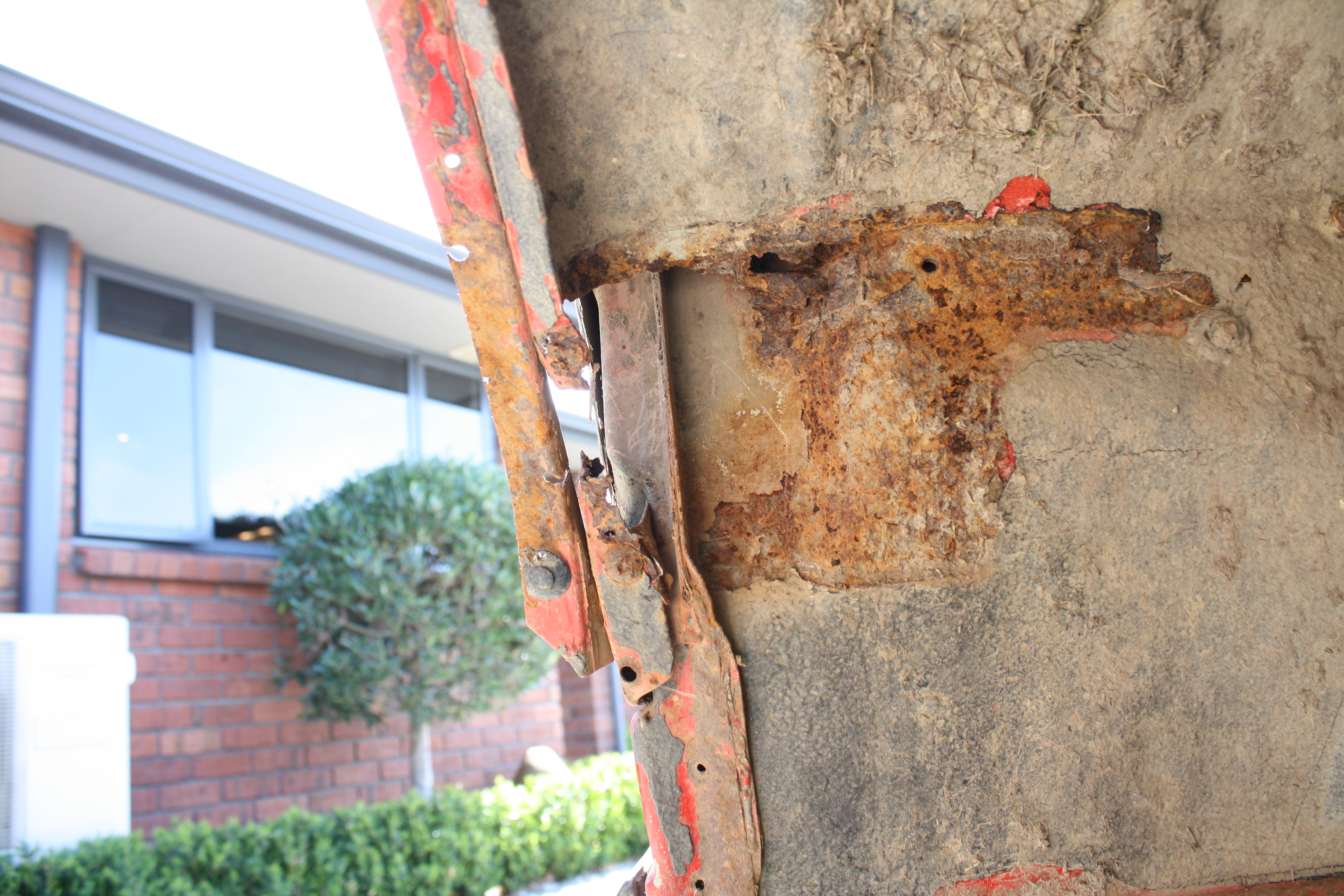

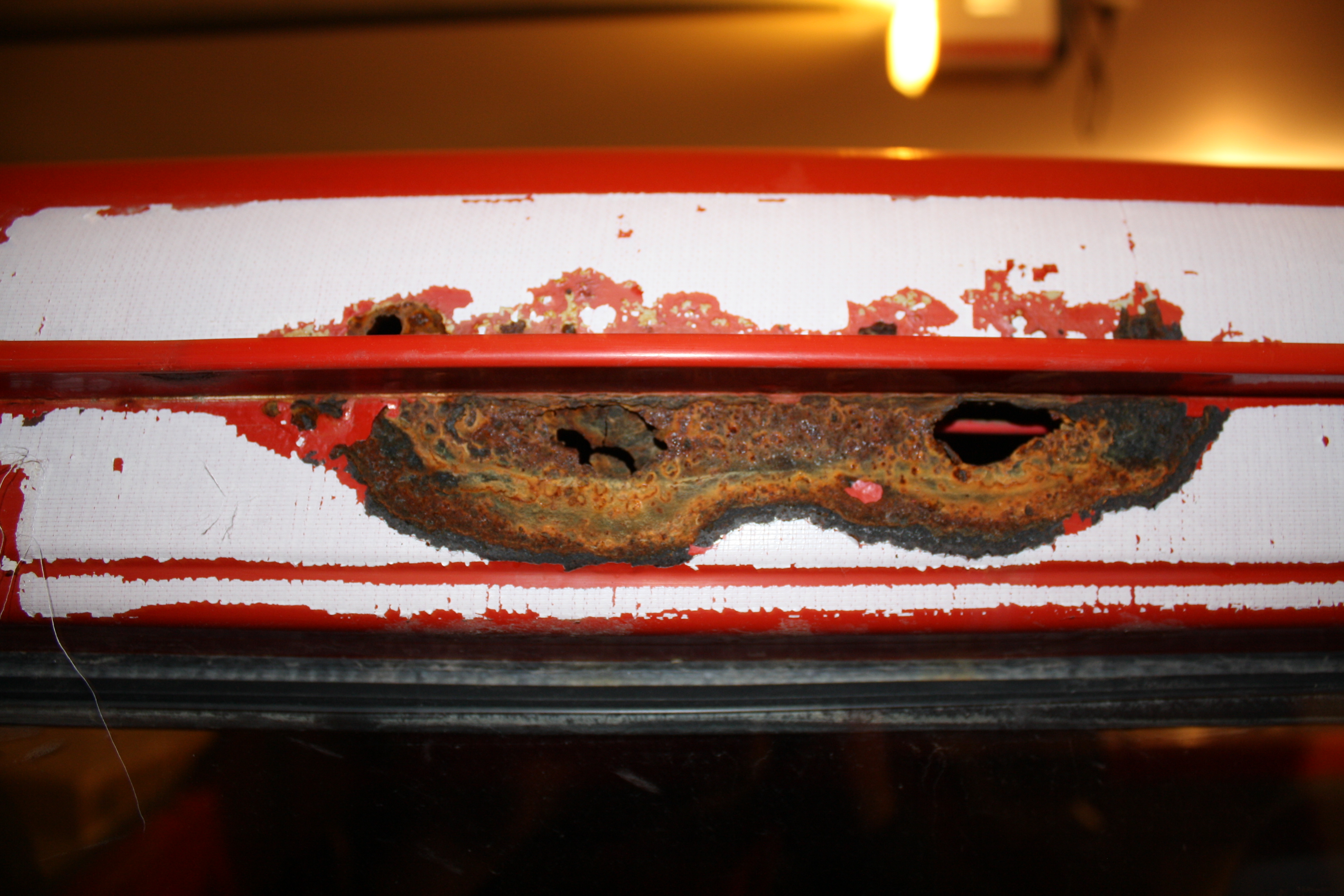

Most of the rust is along the roof line and in the right wheel arch.
So here are a few pics of the rust before and after.
As you can only attach 5 pics at a time Ill put some more up in another post.
And a bit more reading for you all.

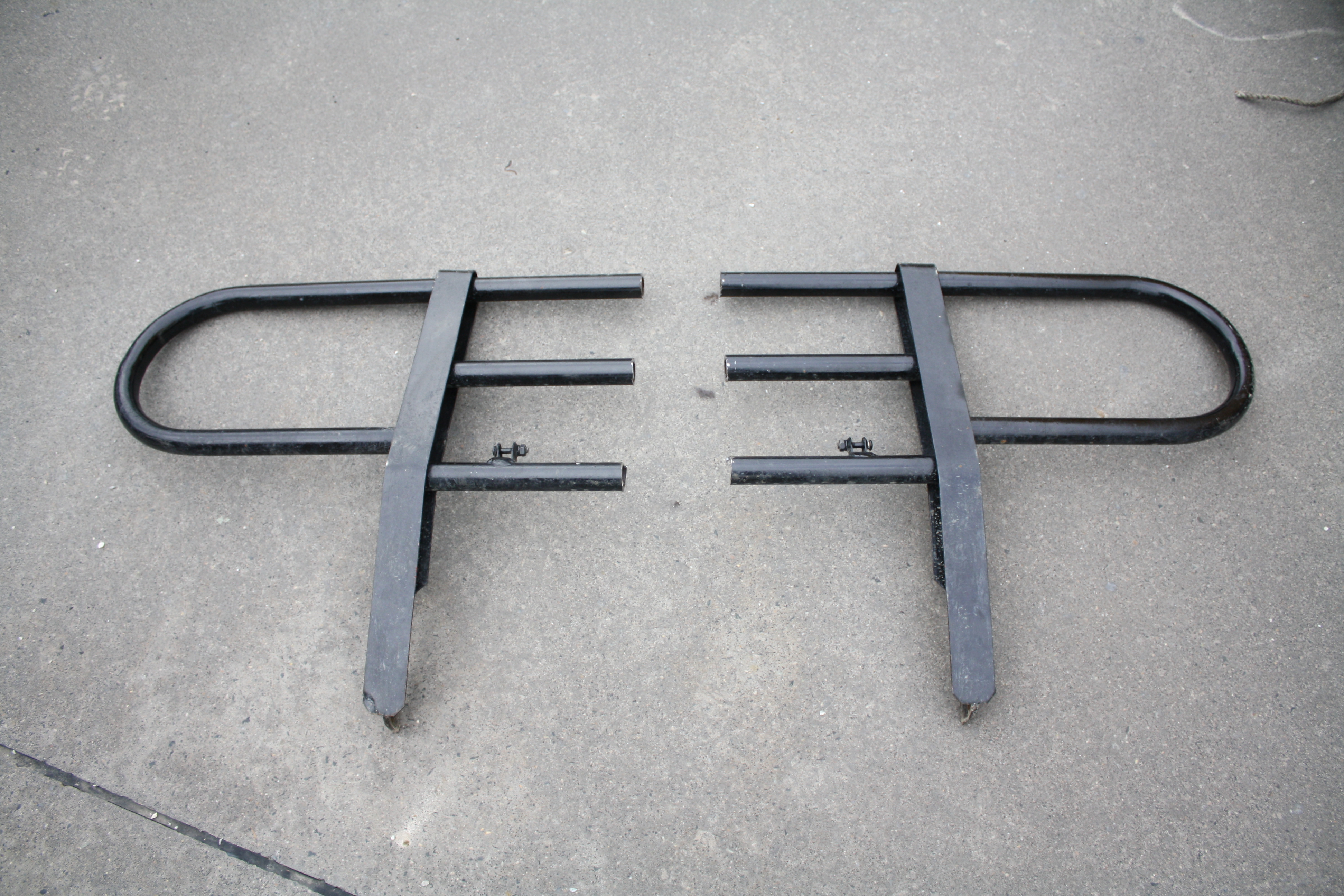

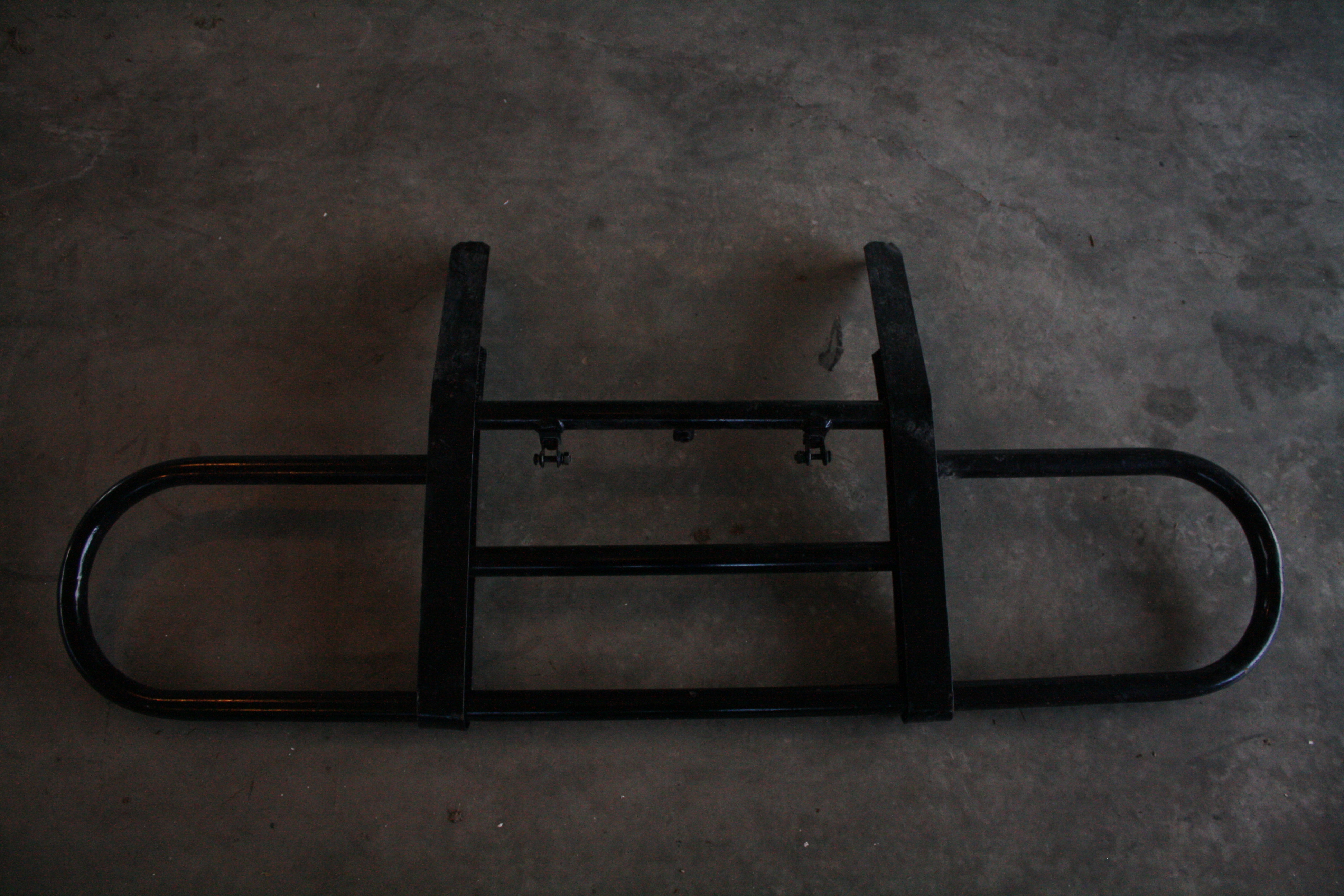

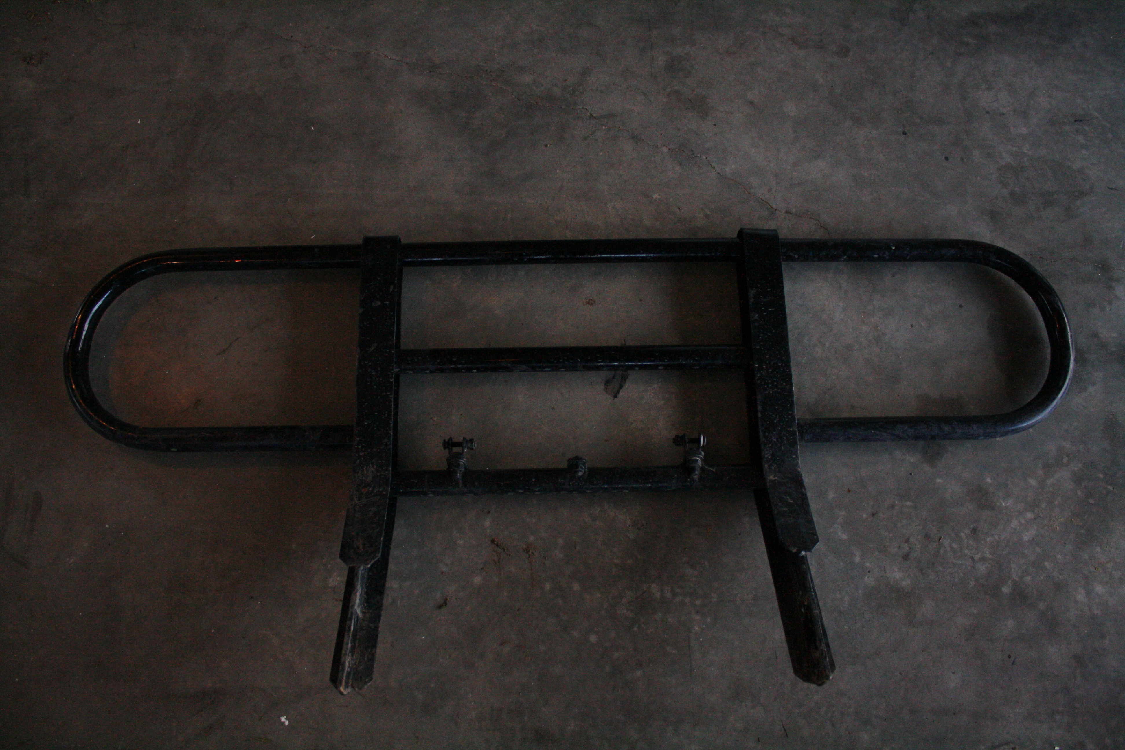

- Front and rear bar work. (Probably try and make something like the attached photo for the rear bar. I do have my own arc welder and grinder and can get steel cheap through dad's work)

Rearbar
Rearbar

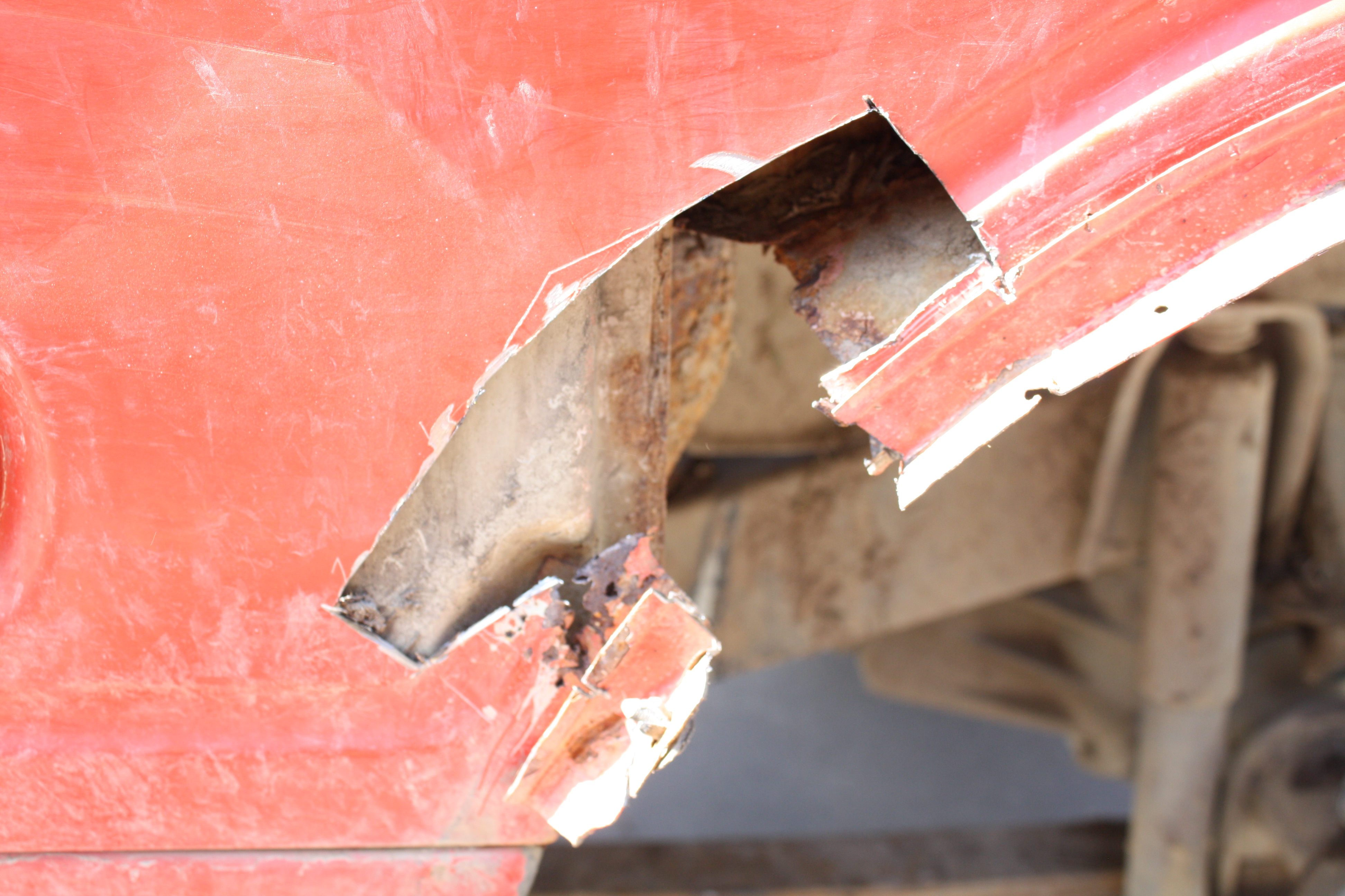

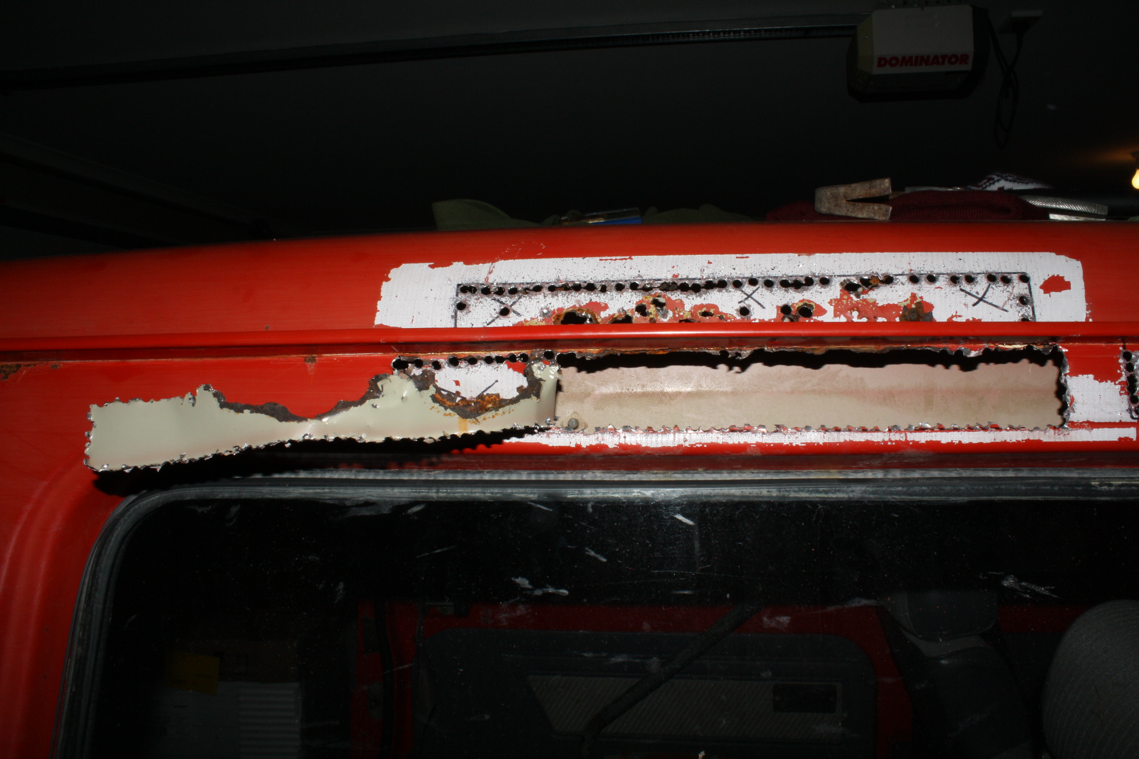

Rust in the wheel arch and a bit of fixing
And some others

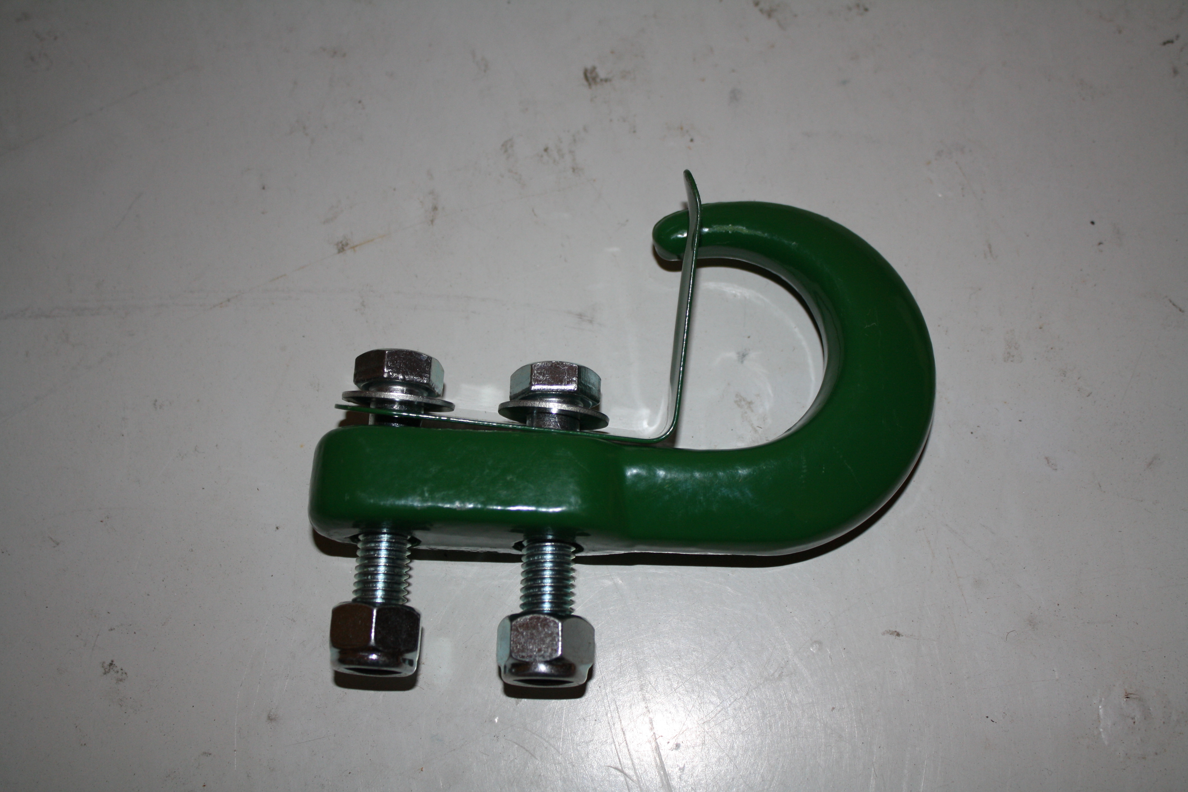

I also spent last weekend in Ashburton (more on that soon) and my cousin has an Sj that he's turning into comp spec (also more on that soon) so he has a lot of standard Sj bits. I was looking through some of it with him and he found some Superwinch hubs. He was like "Shit i didn't know I had these, these are bloody strong. You can have them for 70 bucks if you want, or you can just have them. Yeah, just have them" I was stoked. So I was the proud new owner of a pair of Superwinch hubs :mrgreen: .

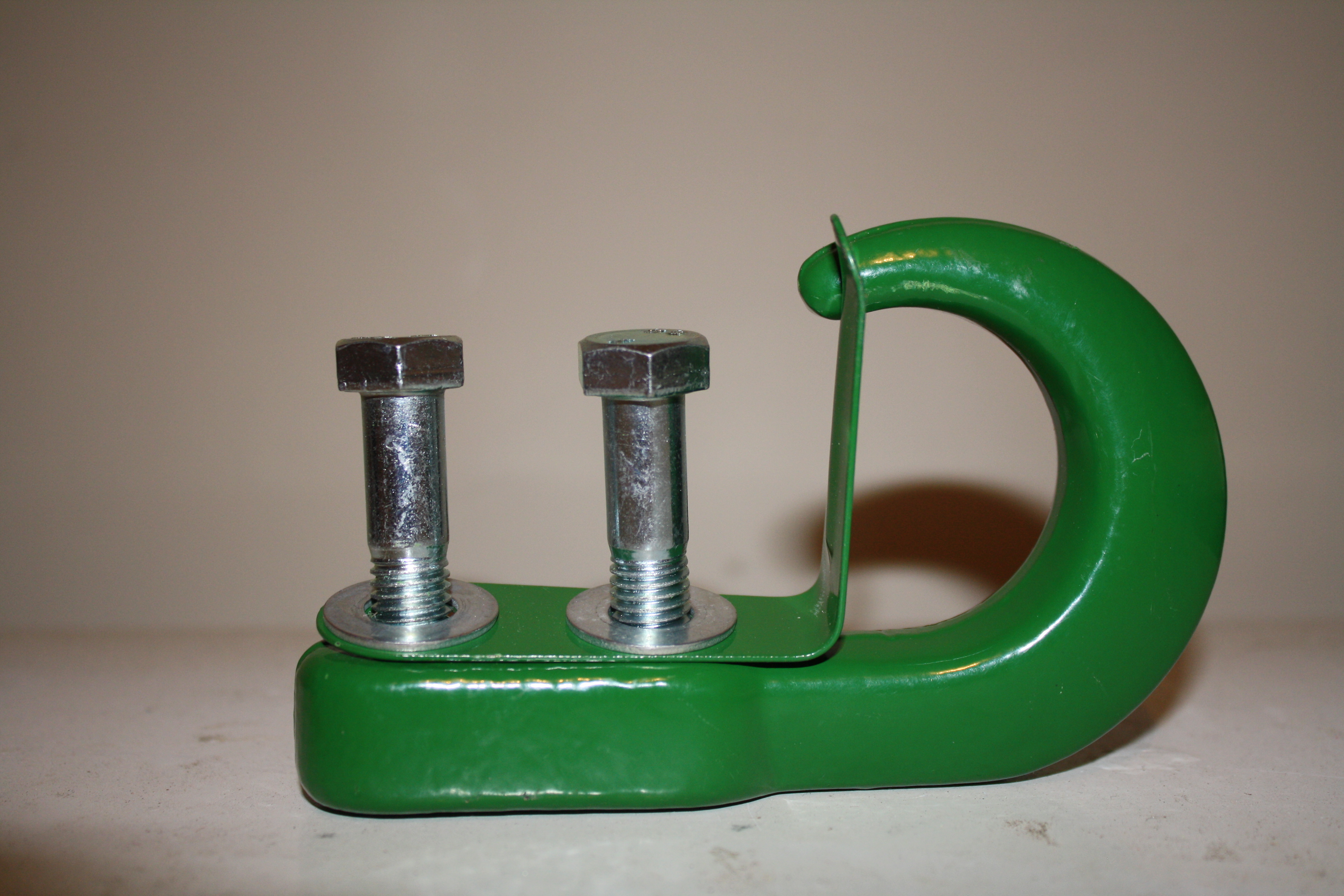

A few weeks back I also brought a couple of recovery hooks off 4wdbits. Yet to install.
Next post to come with pics of last weekend and a bit of an explanation.

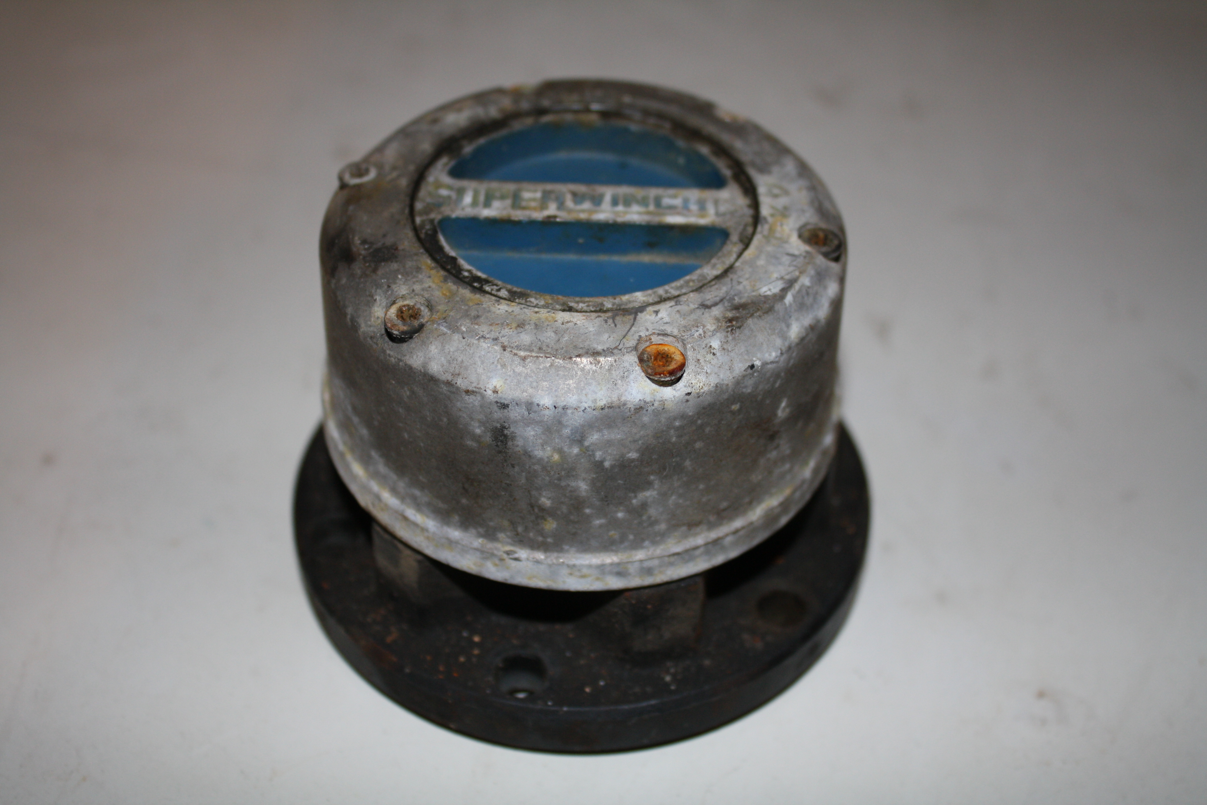

Those hubs seem to last. Just removing them can be a pain in the ass if they have those weird long tapered head screws. Unsure if theres a way to prevent them seizing but have had a couple hubs real hard to remove.

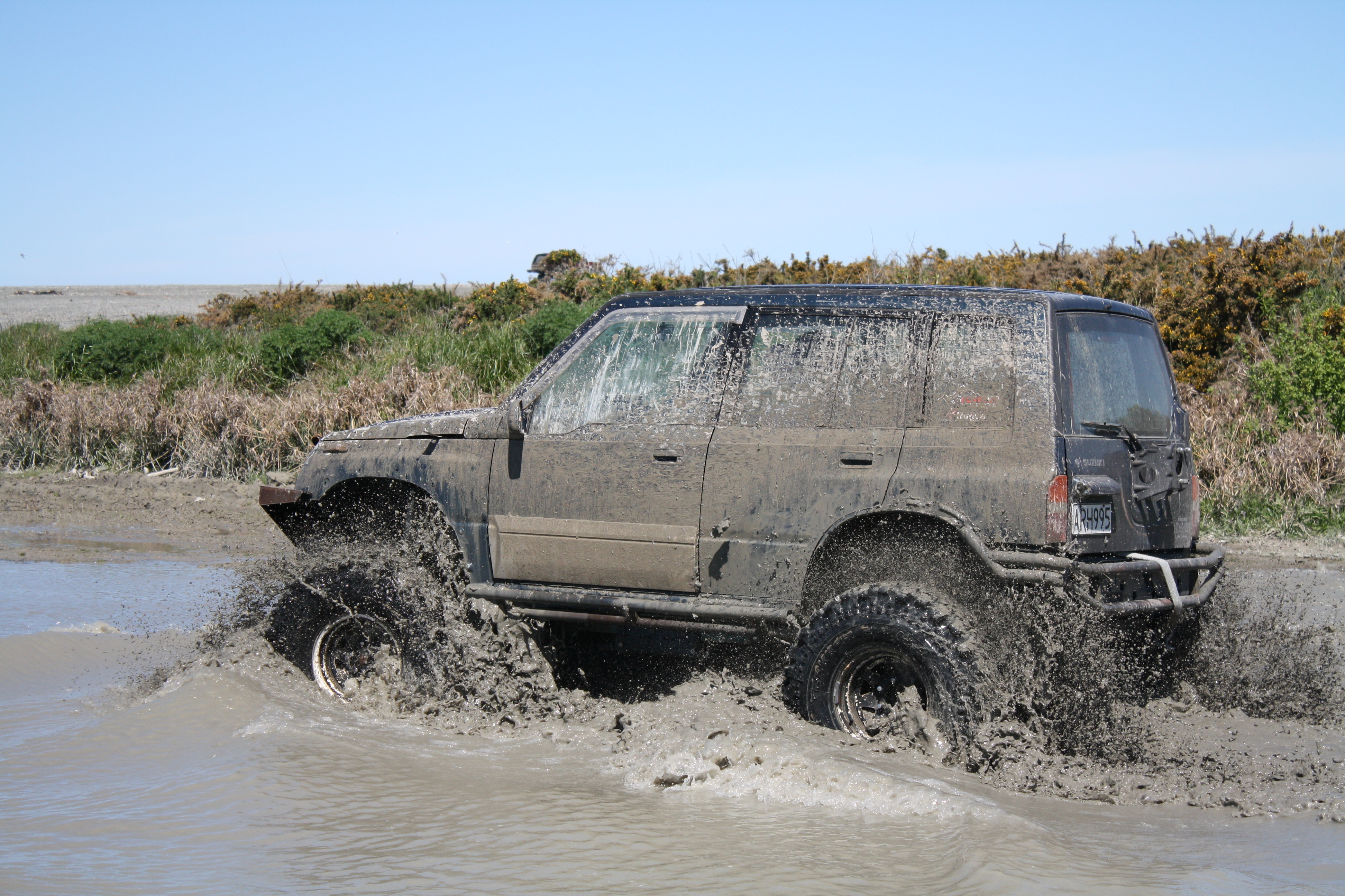

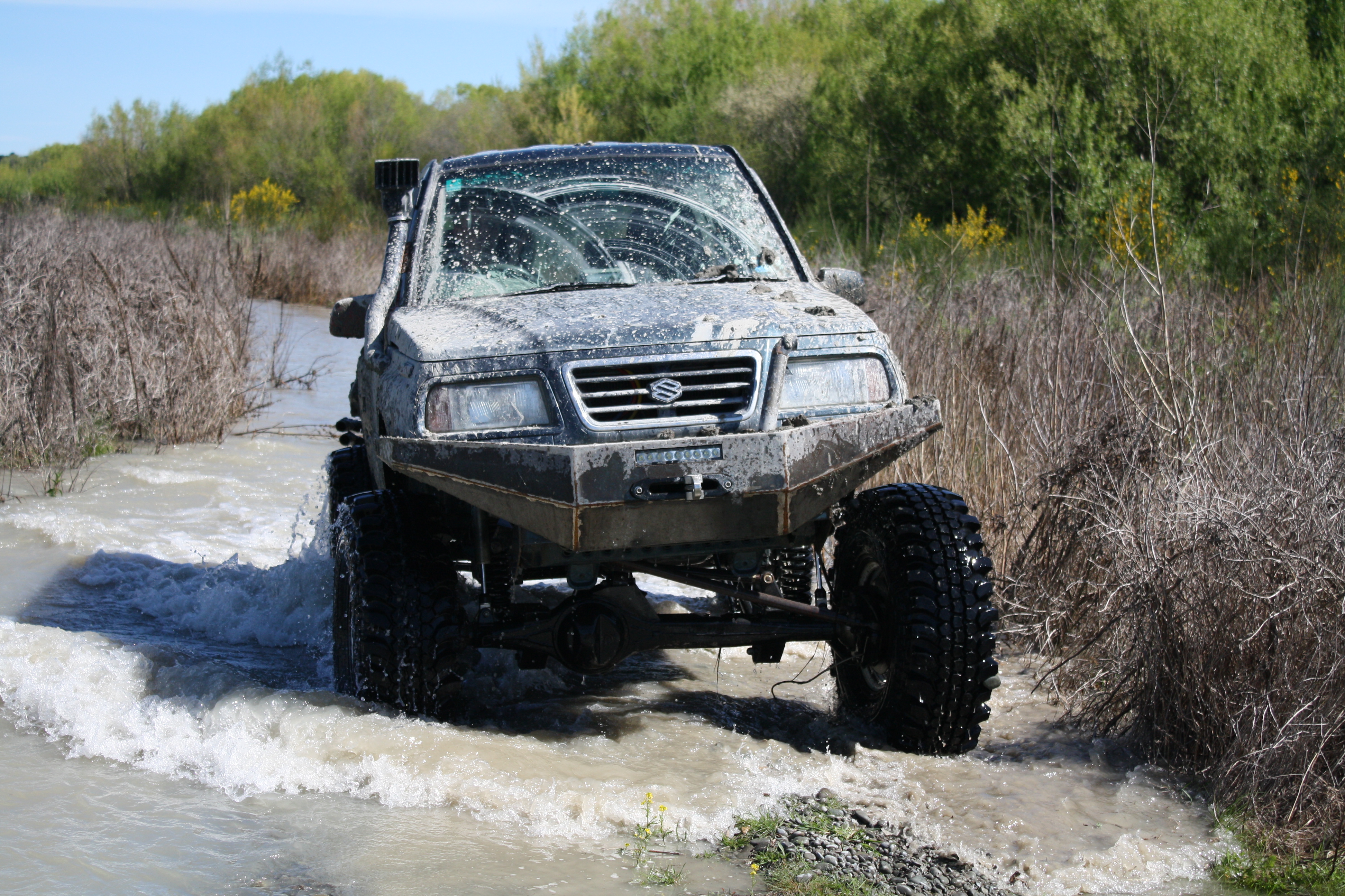

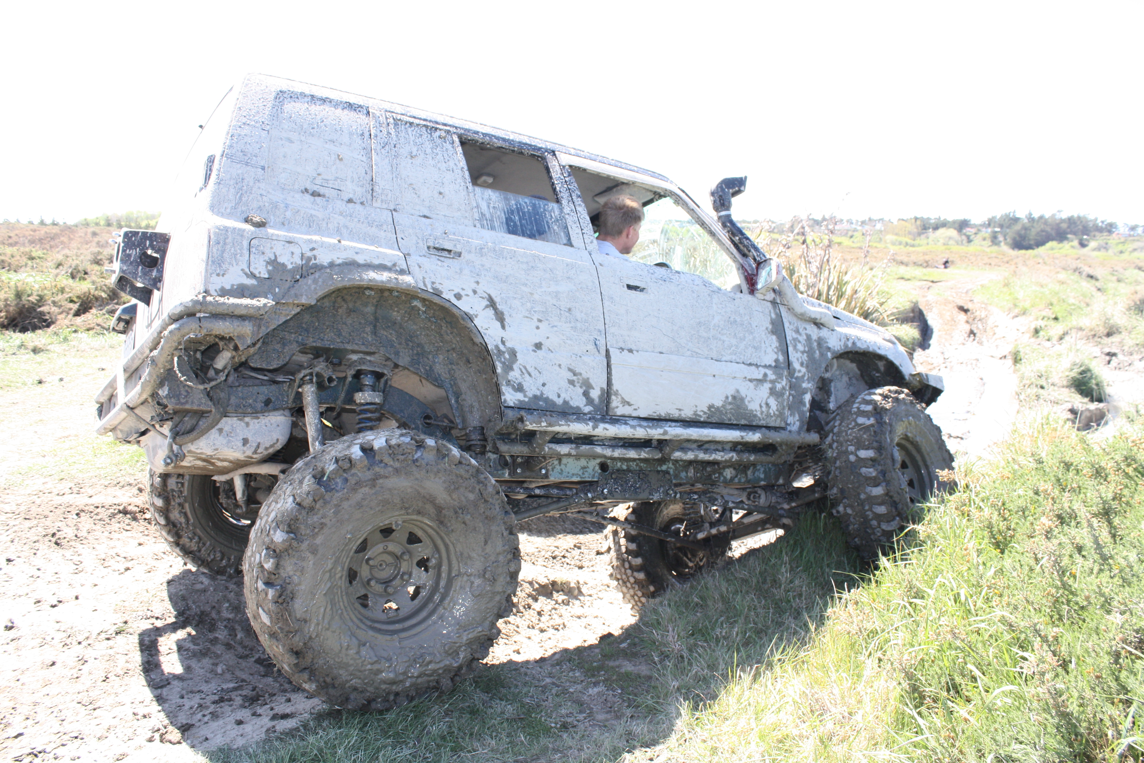

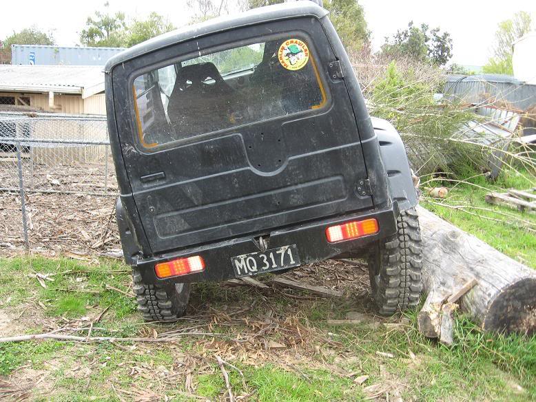

-----------------------------------------------------------15/10/16 (Weekend spent in Ashburton)------------------------------------------------------------------
Over Friday night we (me and cousin) fix a few problems with his crazy-ass vitara.
Then Saturday we went 4wding (Attached pics)
I was fortunate enough to be allowed to drive it as well :mrgreen: :mrgreen: :mrgreen: :twisted: :twisted: :twisted:
A few specs:-
Brought stock off Trade Me about 8 months ago.
Now on its 4th set of tyres
Had three different suspension setups
And is now solid axle swapped (SAS)
80 Series front axle with ARB air locker
Prado rear axle with 2 inch wheel spacers to match front width also has welded diff.
Custom suspension set-up. 10 inch shocks on the rear. 12 inch shocks in the front.
2inch Bodylift
36 inch Simex extreme tyres
Stock 2.0L V6 with half stock exhuast, other half 2inch with highflow muffler.
Custom front bar with 11,000lb Runva winch
Custom rocksliders
Custom rear bar
Custom snorkel
10in LED light bar above winch fairlead
Stock auto box
Not sure on what the diff gears are, but are aftermarket. Might be 5.29s or something he said they were the second lowest available.
Maybe Supercharge and most likely swap out the sus. for 16 inch coilovers
Think that is all.
The comp-spec to be Sj is currently in bits but this is what he wants:-
Ute-chop
Coilovers
Already has CA18 1.8L Nissan engine
35s
80 series axles
Twin locked
Exo cage
Lots of custom stuff
Winch
More custom stuff
I don't think he's 100% sure of somethings he is going to do to it at the moment. He isnt going to start on this until the Vitara is Finished.
Crazy-ass cousin 1
Crazy-ass cousin 1
Crazy-ass cousin 2
Crazy-ass cousin 2
Crazy-ass cousin 3
Crazy-ass cousin 3
Crazy-ass cousin 4
Crazy-ass cousin 4
Crazy-ass cousin 5
Crazy-ass cousin 5

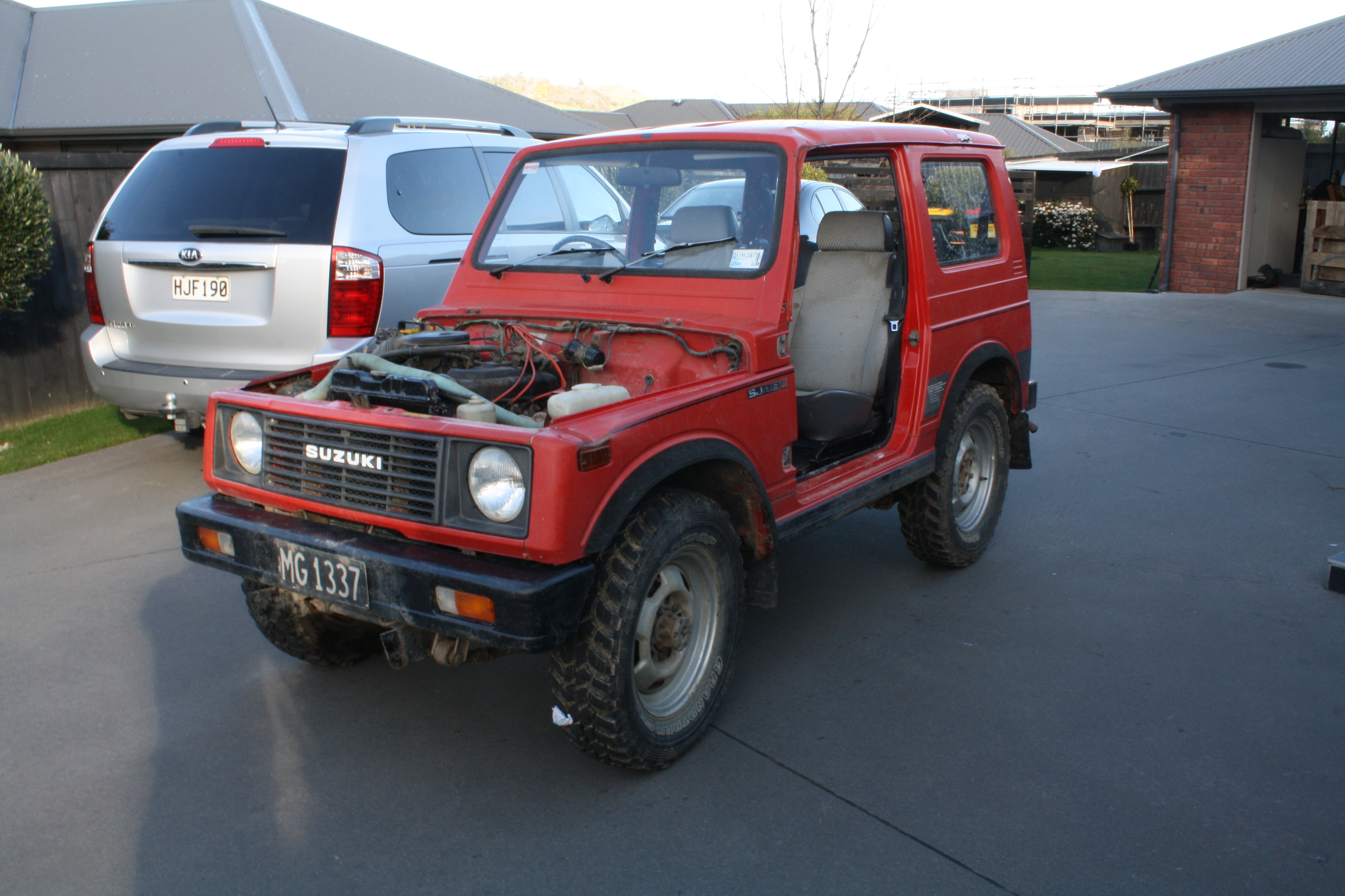

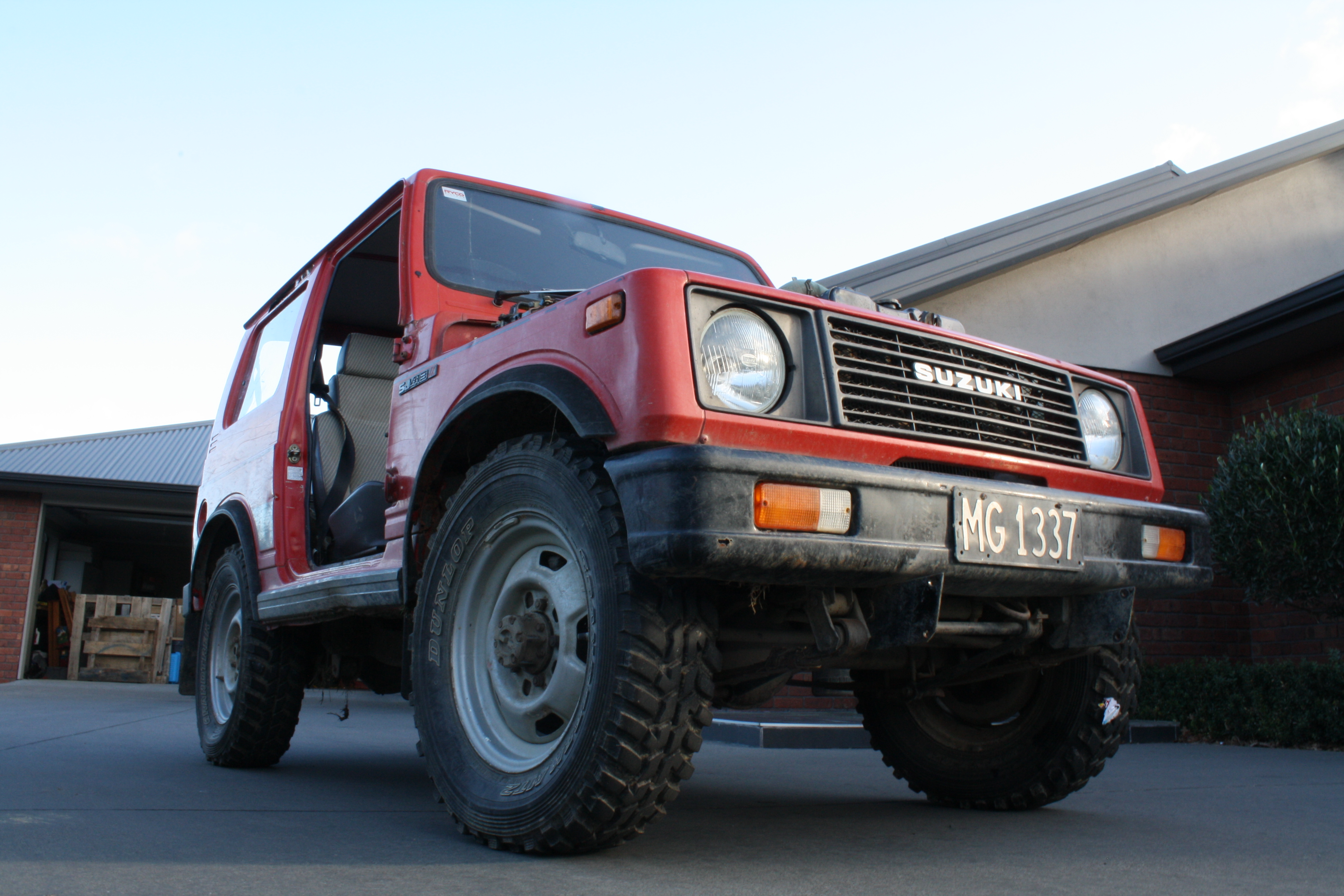

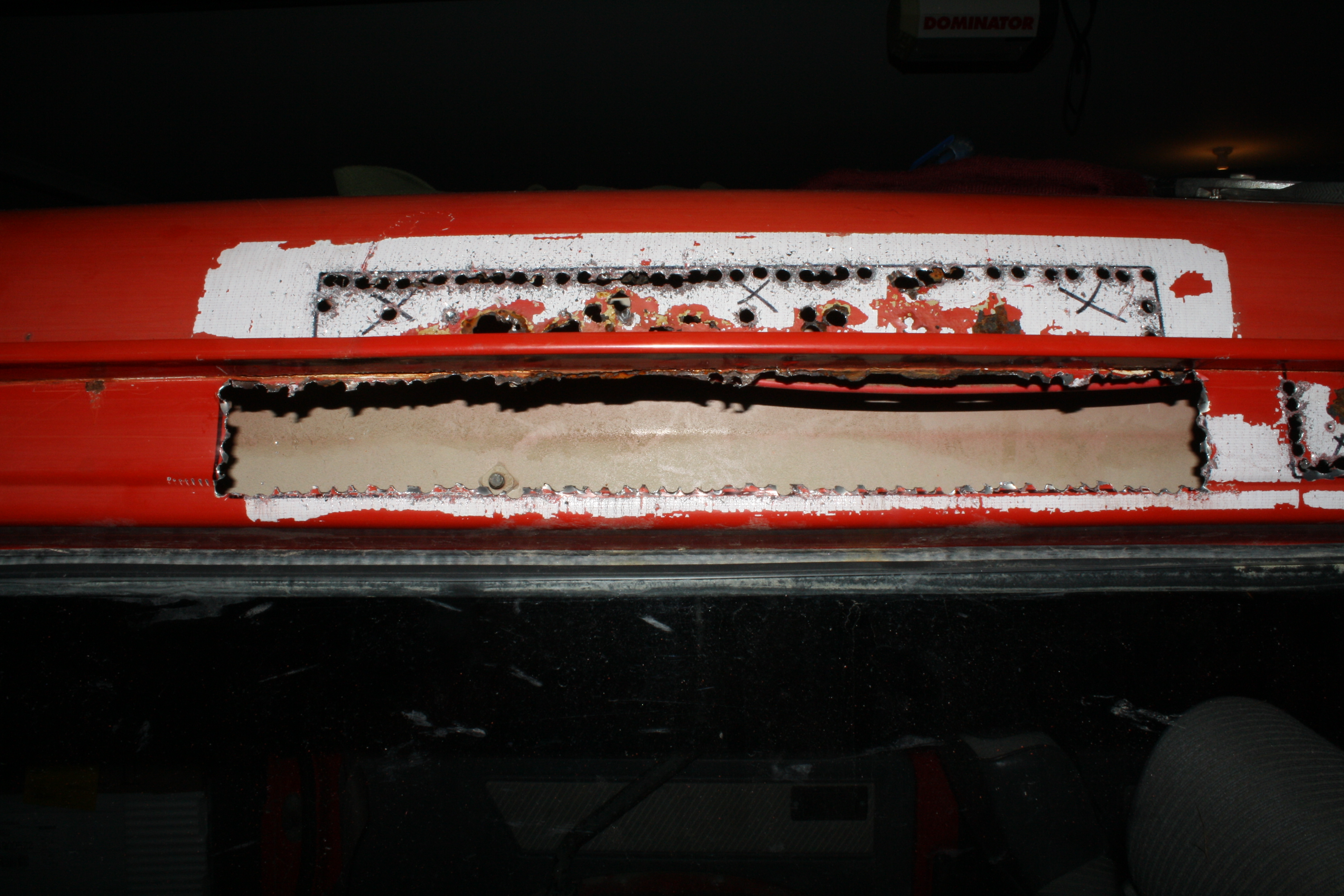

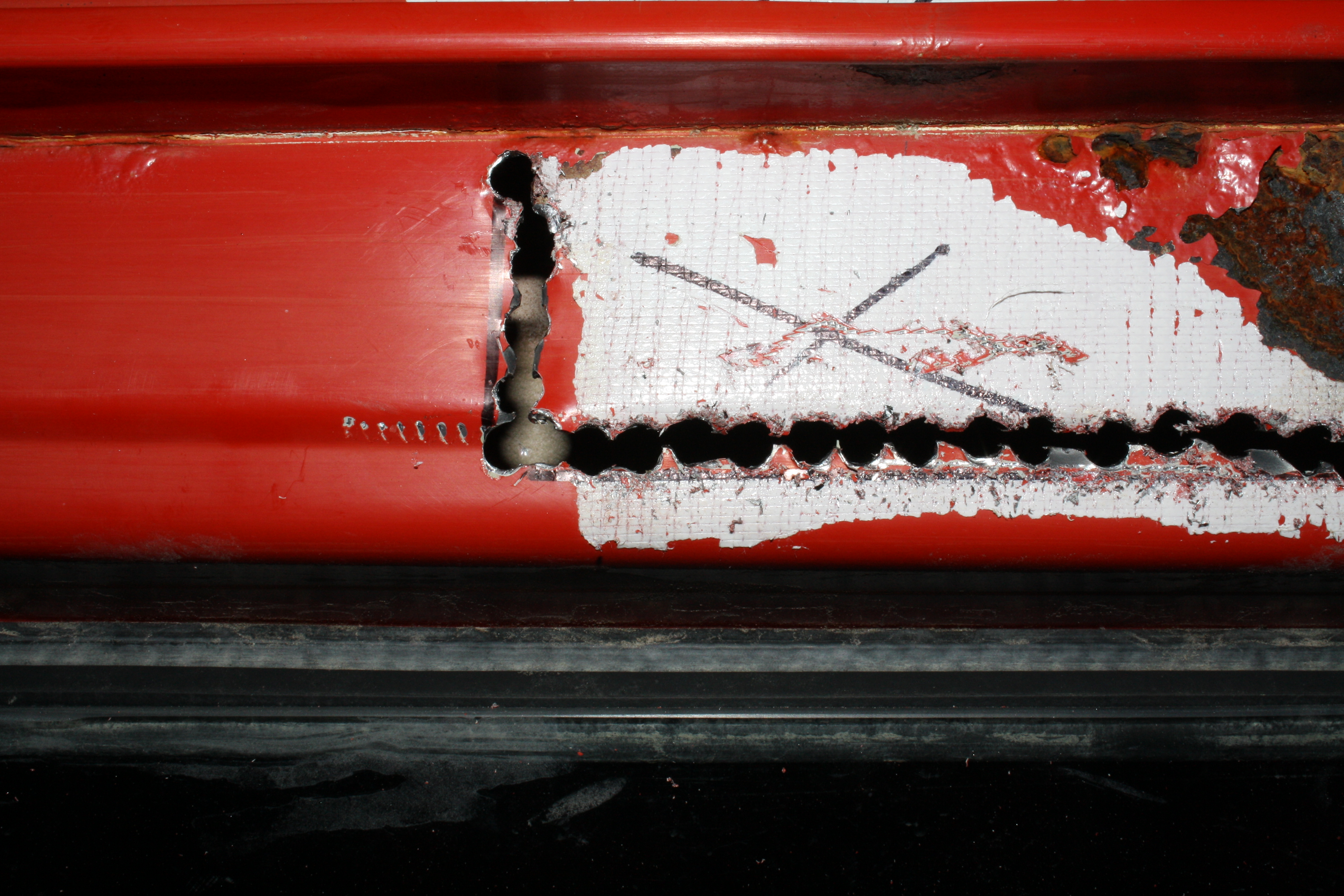

Few pics of mine now :lol:
Does have doors and bonnet. Just off for something to do and to get at the rust

some comments.
It will take a bit of work putting 33 inch tyres on a SJ ( but hey your crazy cousin runs 35s on a Vitara!)
Have you thought about putting a cutting disc in your grinder- would save all that drilling you do, and is fast as!
Is your Registration on hold? (don't let it lapse!!! otherwise your truck may never see the road again...)
From my (limited) experience , Arc welder fine for your bar work, but far from ideal for putting in all that replacement body panel patches where the rust is being removed.
thanks for the photos. Don't ever lose that enthusiasm ....

BlakeNZ wrote:some comments.
Yeah I know it will take a bit to fit the 33s, but it has been done, and never say never :mrgreen:
I do have a cutting disc. I just wasn't sure what was behind the panels on the roof. Otherwise I would've. As you can see I did use it on the wheel arch bit.
Not sure, but I will find out. Although I doubt it.
I wasnt going to use the Arc for the body panels. Dad has a few Migs at work so I will be using them. But I might try and use my Arc for the bar work.
Cheers.

Update time
- I have chopped the standard "bullbar" in half and planning on adding a couple of solid spacers type things in between to widen it to the width of the chassis. Ill modify the mounts so they are stronger. I'll probably take the centre bar out as well so I can add some big arse spotlights in there sometime. (few pics attached of the chopped bar.)
I am going to take it to the sandblasters to strip all of the paint off. Then get my uncle to machine up a couple of solid tube to slip in the hollow part of the bullbar tube with the same OD. Then weld them in; then take the whole thing to my other uncle to get it electro galvanised and powdercoated. :mrgreen: :mrgreen: :mrgreen: :mrgreen:
- I have another thread under winches about the Ruva I was looking at. One guy said that his dad just had a 2" receiver at the front and the back with the winch mounted on a compatible cradle. Quite seriously thinking of doing this now.
- Not thinking of doing it anytime in the close future, if not at all, but I have heard of a couple of people putting a 2.0L SR20DE/DET Nissan Silvia engine in a Samurai. Wondering what people think of this. I know that there would be a hell of a lot of work to do, but you would end up with a small 4wd with a lot of power. And I like the idea of that. :mrgreen: :lol: :twisted:
Before the chop (1)
Before the chop (1)
Before the chop (2)
Before the chop (2)
After the chop
After the chop
Life is better off-road
