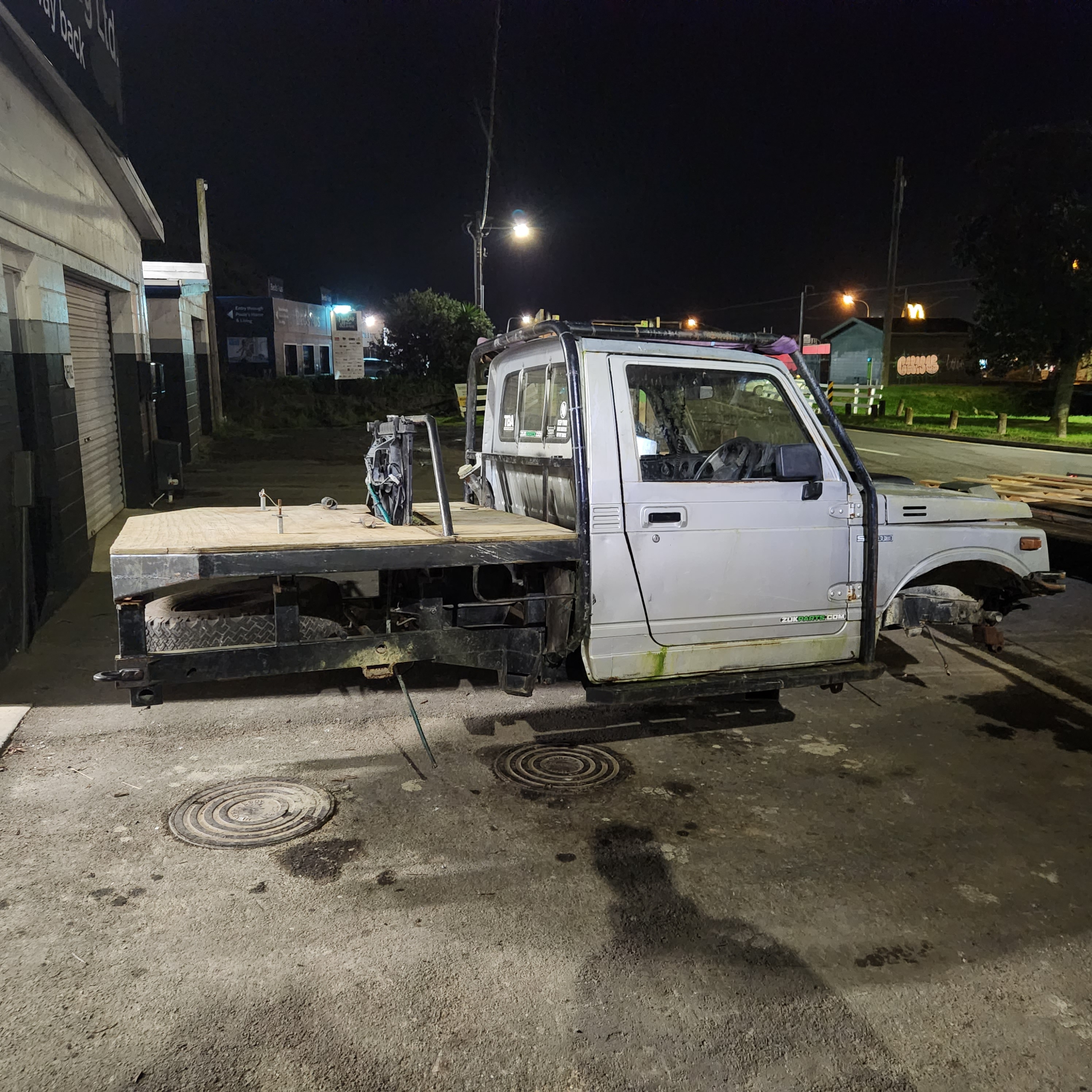

As we were painting our house to sell I get a snapchat of my old sj for sale still live rego and as crap timing as it was had to have it back so I brought it
It was delivered to my work on a trailer with no diffs ,gearbox ,t case ,steering ,shocks, springs etc but....it had live rego and I get it back

As I had no where to put it I had to get it semi pushable and into storage while the house was on the market

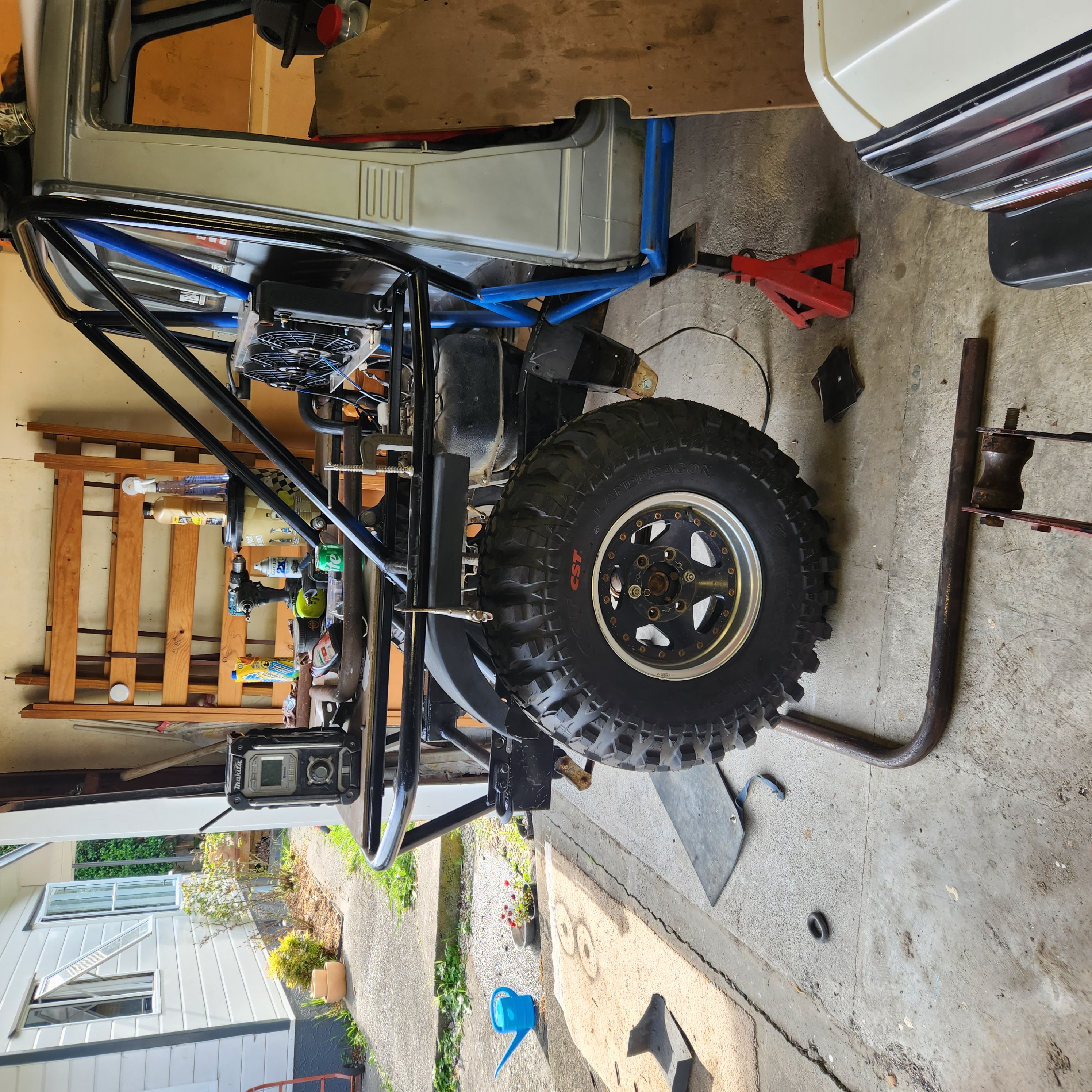

A month later we moved into our new house and that same day I grabbed the sj and put it in the garage and started tracking parts down
A tubbed / virtual lift front clip came up so I grabbed that along with a set of wide track axles complete with air lockers and rcv cvs ,I managed to get a few sets of old leaf springs and make a set
Fitting was super easy and totally worth it
The front diff got a rebuild and shave with knuckle gussets ,4.3 gears, tre locker , rcv , solid pinion spacer and I used the samurai pinion flange (more on that soon ) ge uine asin hubs and studs with cone washers etc lwb vitara brakes
Rear was shaved and trussed, 4.3 gear set and solid pinion spacer with arb air locker ,zuk parts disc kit
I had been sitting on a set of 6 stud axle bits from a weird jap import 660cc jimny that I used on my W/T axles
Leafs are bastard packs front and rear and I've got Ultima shocks at the moment done my lengths to cater to the set up
I did a deal and ended up with a tubular tray so on that went and mounts to suit etc
I added a xj jeep radiator with 3 electric fans and a shroud I folded up along with a Davis craig waterpump

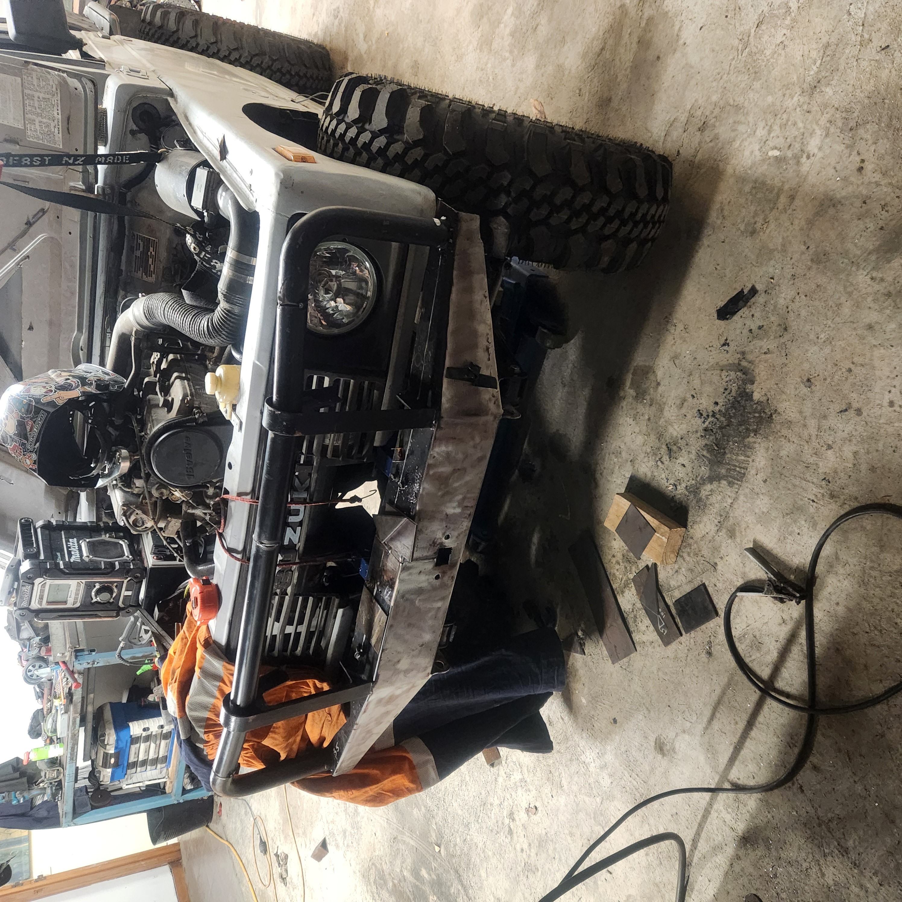

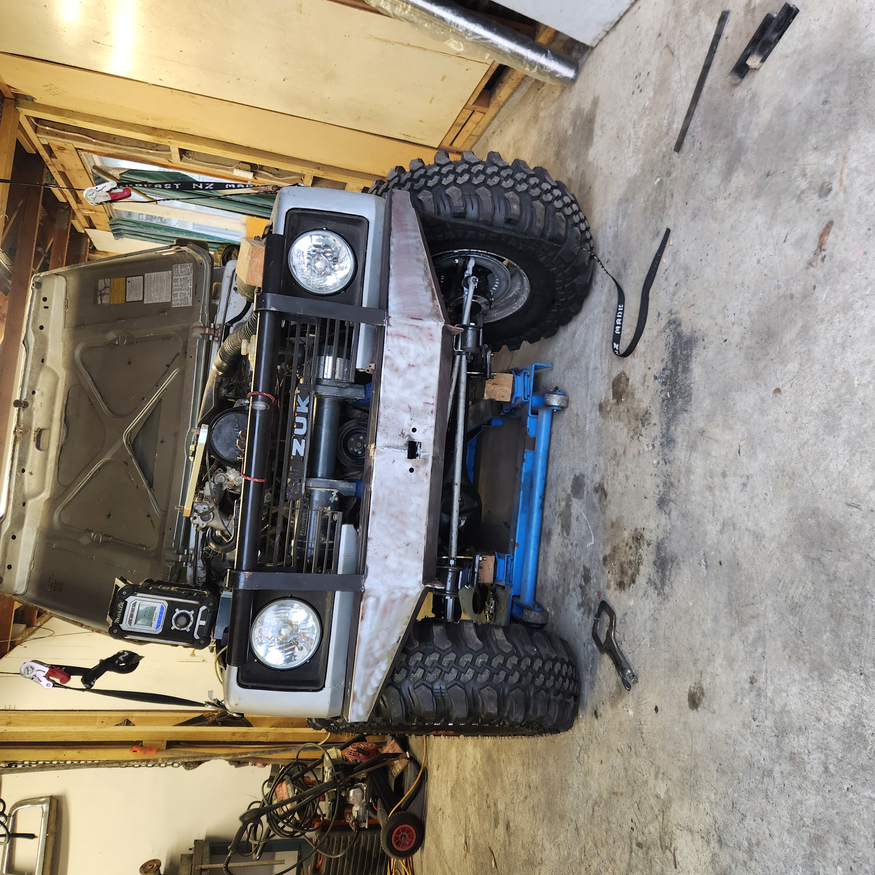

Touching back on the samurai (wide/ big pattern pinion flanges ) I have chosen to run these as they are the same patten as vitara so yolks / uj and later on drive shaft tube will be easy to sort
A nice dude came past work and offered me a arb style bull bar from a range rover classic free he just wanted it gone so that followed me home and the saga of that began making it fit the sj
And being the over thinker I am i decided while doing a bar let's mount a winch and hooks ,so I dusted the runva evo off the shelves and use that finding the chassis width of the sj limiting I made a winch plate that steps the winch up 100mm and got it up above the steering box since I'm running rear radiator the front is pretty open
Chopping the bar was fun but would have been easier to start with fresh material rather than making one work and change every aspect of the bat to suit me
