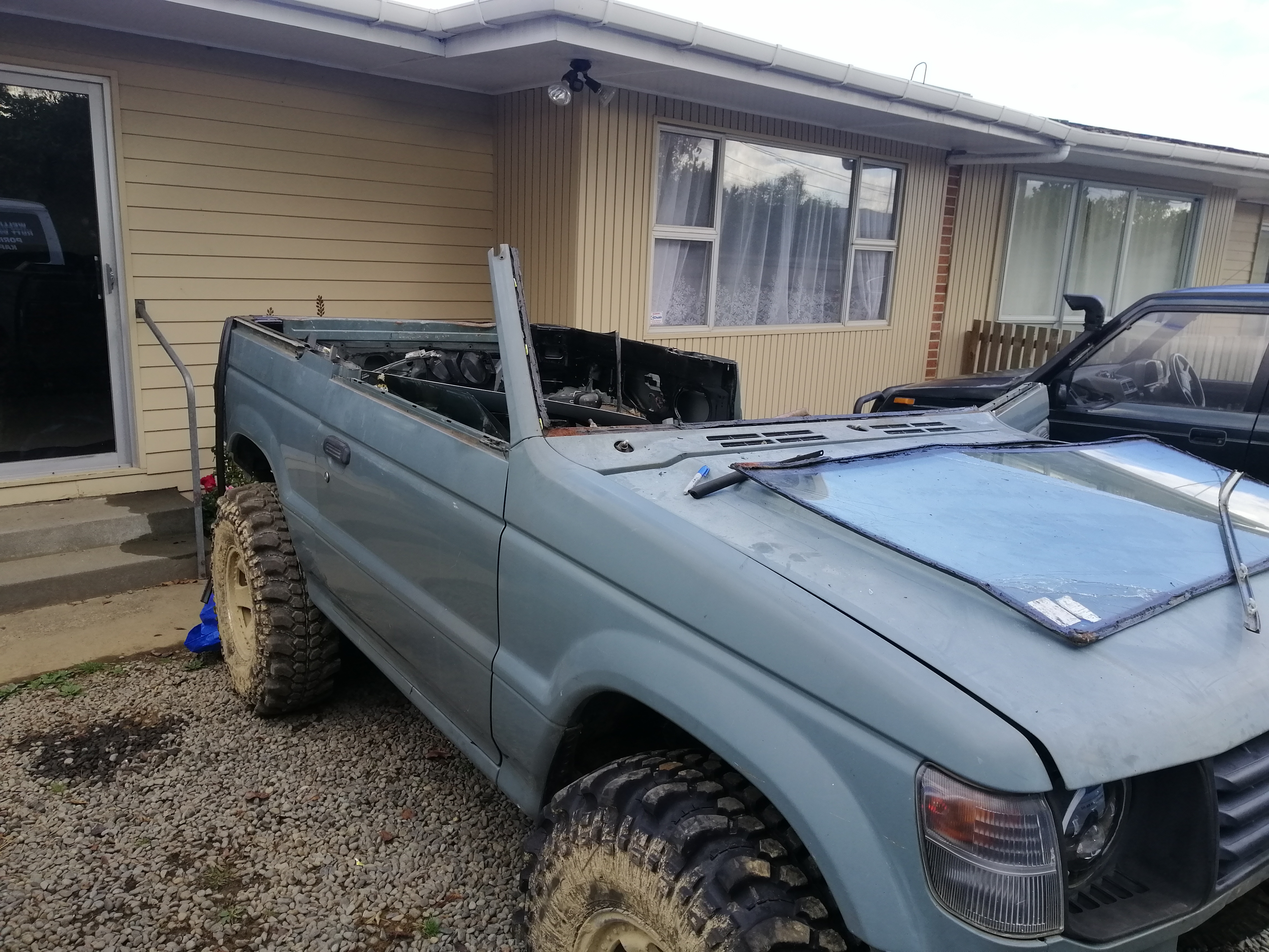

Plan is stripped out (I've stripped the inside some what more to come tho 17kg out already) gen 2 with a internal cage
Pto winch set back in the engine bay and the warn high mount I have in the back as a second winch facing backwards so I can winch both foward and back
4d56t has had the timing advanced and it goes a lot better after some further tinkering
I plan to run a fuel cell in the boot as well as the large battery's I have and the winch and radiator all crammed into the back... Some how

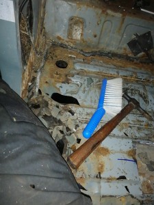

Brought a ex trials cage and seats cheap so sawed the roof off and fixed the rust in the floor

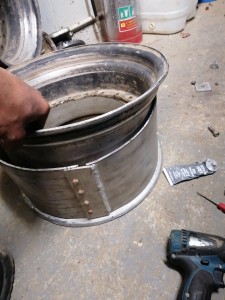

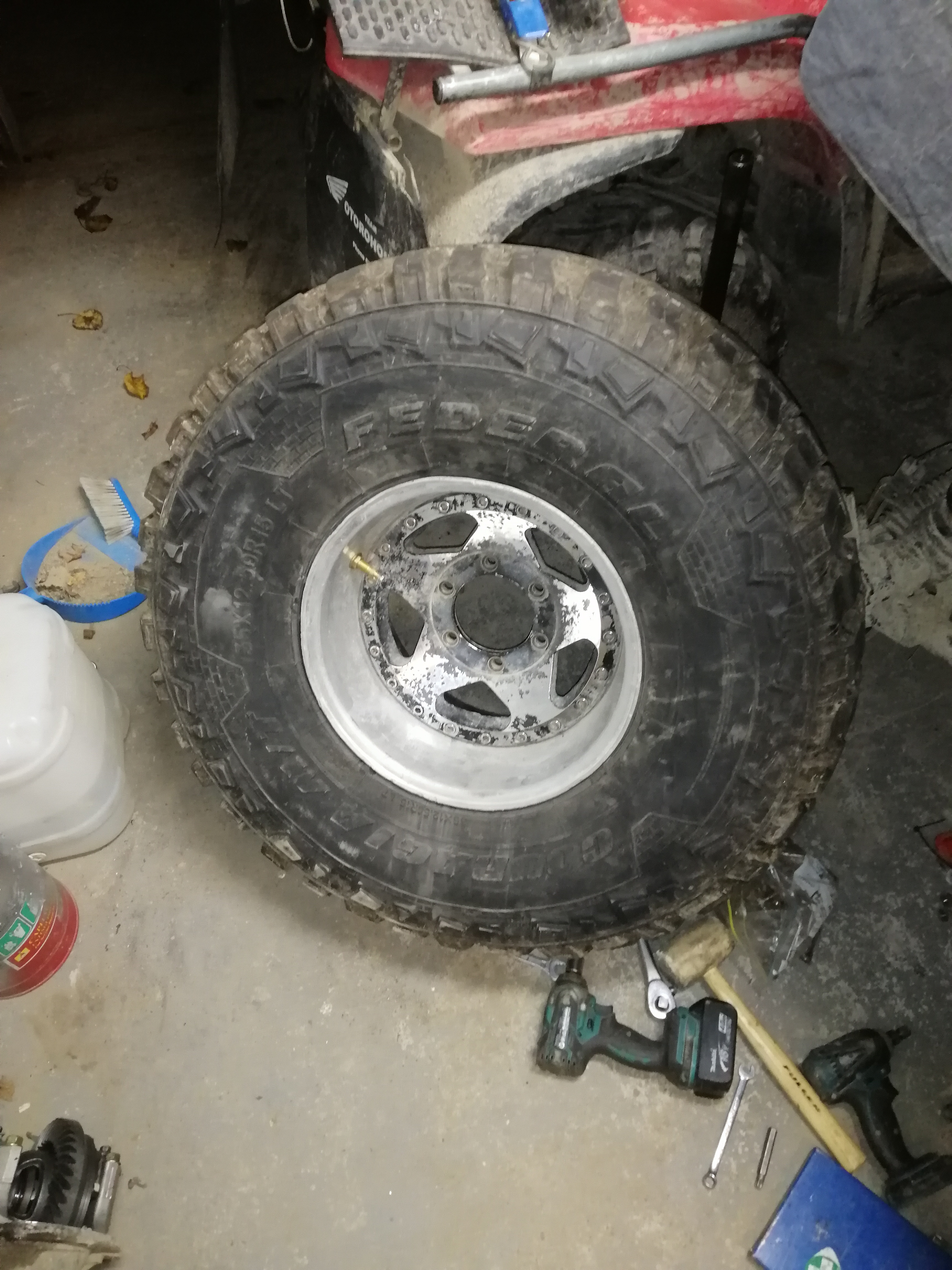

I've also scored some cheap 35s and dual beadlock rims so have been sorting them out
