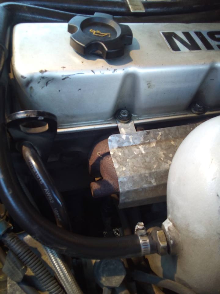

ok so see the casting at the very front... can I drill that out tap a thread and fit the thermastate for a pyro meter in there???

You can, however that will only give the temperature of cyl no 1 and not the entire system. I would recommend installing it just before the turbo inlet for the most accurate reading
