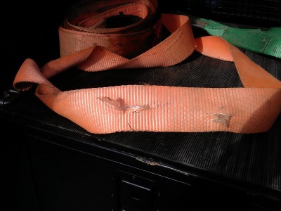

Doing a double hook pull over the weekend to reduce the length and my strop rode up and got pulled into the edge of the hook and penetrated it.
Are these repairable or just chuck it and replace it?

I would definately say replace it.
Save the damaged strop for something else which isn't quite so critical.
Re: Strop repair or replace?
I had downward pointing hooks, got holed the same ,change hooks to side wards mounting ,replaced the strop

Cut out the damaged section and get Cookes or similar to put new eyes in the ends, giving you two shorter strops.
Then go buy a new long one. :-)

Cut it in half and buy a new one

It still looks in good nick. Take it in to cooks and get them to chop it and sow in a new eye as short ropes a real handy

Thanks for the replies guys, new strop it is....
