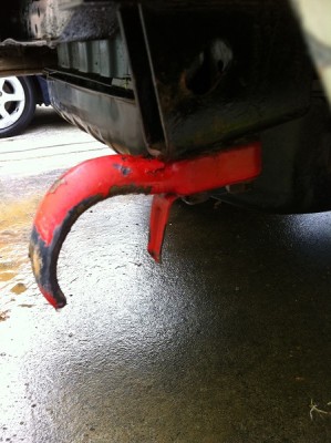

That one on the left ain't factory, it is a proper rated recovery hook....how much, you'll have to look at it and see for yourself.
tallsam66 wrote:Im sure the factory hooks have "dimples" between the bolts & are cast...So being cast aren't suitable as will snap rather than bend to release rope like forged hooks do.
stu_71 wrote:I took some of those off a Prado 90 series. Look identical to yours. The proper rated hooks are cheap as really. I dont know whether Mr Toyota designed them for "NZ abuse" so I just swopped them for piece of mind.
derk wrote:cant say I've ever heard of or seen a Mr Toyo hook fail there must have been millions of them out there on luxes and old cruisers over the years
polaarbear wrote:I don't know how good the Toyota ones are but as for the Supercheap ones, they will bend when used in anger.. A few years ago when we didn't know much better we were using a rigid strap to snatch with and managed to bend a Supercheap hook. Quite lucky it bent rather than breaking the bolts holding the hook on. So if a hook is too rigid it may not bend and could break the bolts or mounting instead resulting in a missile.
