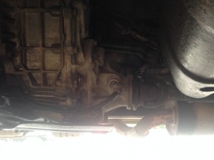

ok ive been talking to a few lads about the upcoming conversation and it was mentioned that i may be running the viscous center diff, how would i be able to find out which center diff that im running?
my trans code is.
A442F auto
K295 Transfer box center diff?? or just the axle diff set up??

Re: 80 Series part time 4x4 conversion
the viscous centre diff has a long rear out put housing on the transfer case.
one way to tell for sure is to get all four wheels off the ground, transfer in neutral and turn one out out shaft on the transfer. if it's viscous the other will turn in the same direction, if its open the other will turn in the opposite direction or not turn at all. it's the same method as to determine if a diff is a clutch and viscous lsd. keep in mind if a diff is torsen lsd this method won't work but the center diff is viscous so this mehtod will work unless the viscous centre is stuffed... then use the transfer case rear out put length.
cheers Churchill
i will roll underneath and take a few measurements and take a couple of photos at the same time..

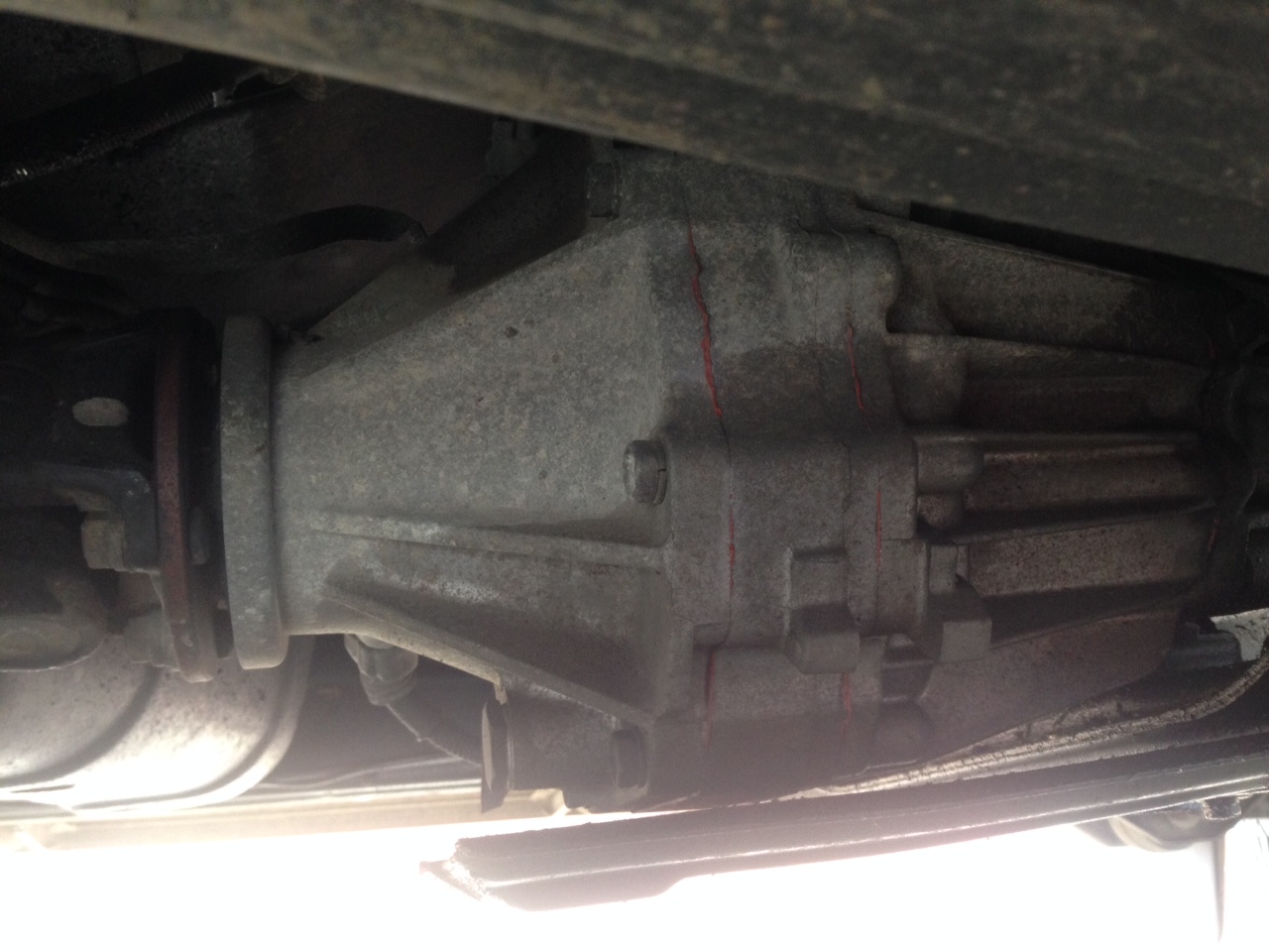

ok this is my c/d
imho i think its a std c/diff not viscous
thoughts
thoughts
any thoughts on whether this is a std c/diff or viscous?
Sorry must have missed this. Doesn't look like it has a viscous coupling from the photo, however even if it does it can be removed pretty easily as they are prone to seizing. Here's a tutorial
They still have the center diff, the viscous coupling is more of an additional thing to help with traction in high range
http://forum.ih8mud.com/threads/tutoria ... os.124794/
ok from reading that link and doing some on road testing im reasonably certain that my c/d is std not viscous.
viscous c/d is described as scuffing when doing hard look turns much like a lsd can do. as i've got an lsd in the rear i would of thought that a viscous would show itself relatively early into the turn.
