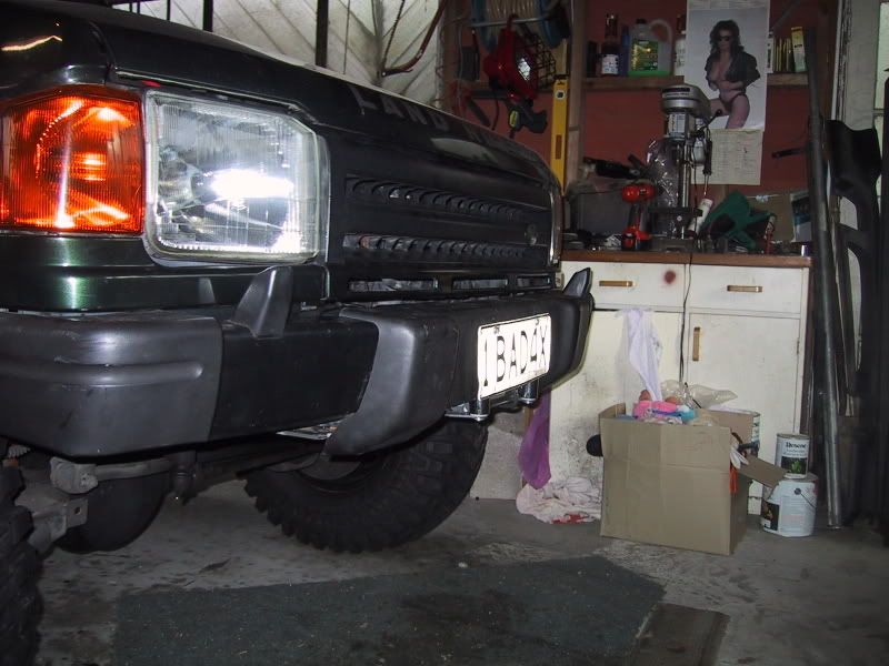

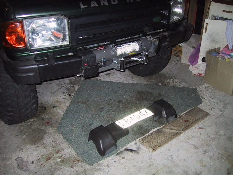

Monday: bloody work getting in the way of building trucks :evil:
Still finished round 3:30 & got it finished 8)
Pic 1: Street mode :?: still tucked up quite nice
Pic 2: Offroad mode :twisted: to tell the truth it's a shame to hide it away so thinking this may be the only Mode :!: :!:
NJV6
Posts: 2751
Location: Southland
Post by NJV6 »
1bad4x wrote:
Pic 1:
Is there a land Rover in that picture??? :lol:
Anyway I think it's great that you can cover it up - very swish job indeed! 8)
Anyway I think it's great that you can cover it up - very swish job indeed! 8)[/quote]
Ok my typing aint that good
OK Ok Yea it sux :oops: :!: :!:

1bad4x wrote:Is there a land Rover in that picture??? :lol:
Ok Ok Yea it sux :oops: :!: :!:[/quote]
Was refering to pic on the back wall... then realised the picutre was of the Disco :D

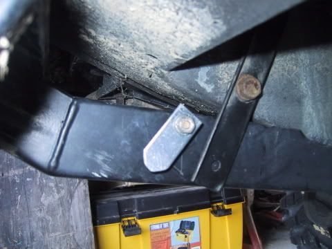

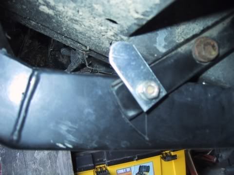

After the little offroad test found the auto rear step not that good..
It made like a spade filled it's self with mud
& when filled with mud every bump I drove over the step would drop down & bang up... solution...
For most Take It OFF!!
but with Kids who love riding in the back the step is great so....
Lock it!!
Unlocked! the silver tab act's as a weight stopping the bolt undoing it's self & doubles as a wing nut :wink:
Locked :!:
