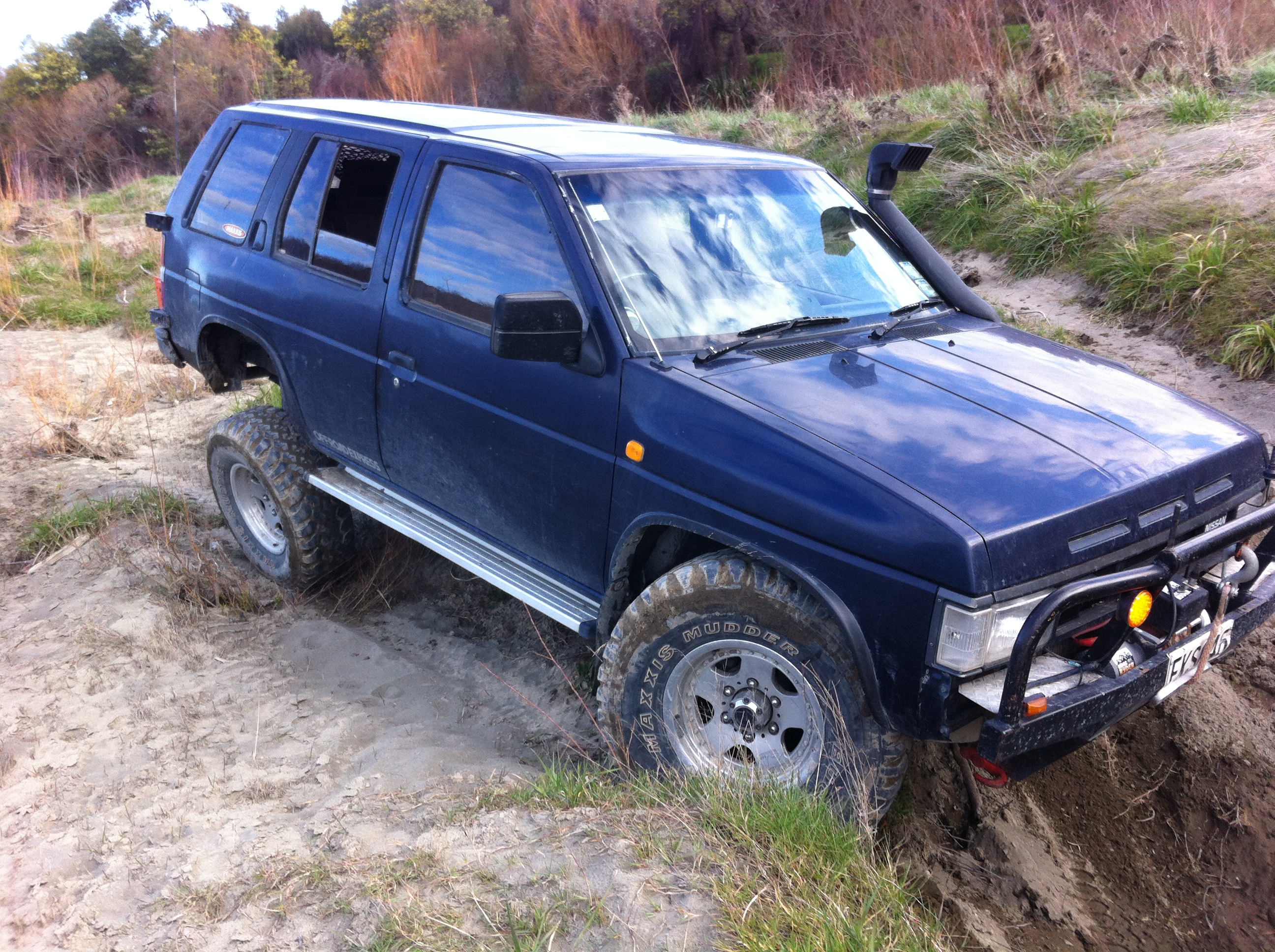

I tested the modified LSD at Rallywoods and its crazy tight, the steering is heavy like a locker at low speeds and it behaves like its locked... fine with me!
I also did the idler arm replacement mod. Good writeup in Hamboys thread about this. Basically since mine is a 1988 it has the older steering box, so it was literally a case of finding another pre-92 steering box, clock the pitman arm, remove worm gear, notch mounting holes and install.
Now the steering linkage looks like a Humvee steering system:
Also put in these fender liners
Made these from an old tube, cut to shape and clipped into the factory holes with trim clips
Also have added EGT gauge and volt gauge to the panel to the right of the driver
If the EGTs get too hot it will trigger the red LED on the main panel
Tyres: My favorite manufacturer and my favorite size: BFGoodrich KM 33x10.5 on standard 15x7 Nissan alloys. These are a true 33" in diameter and a very lightweight but strong combo.
I'm still trying to chase down an Isuzu hoodscoop at a reasonable price, so if anyone knows of one, please let me know

Something for you guys to chew on, this is my flex on approx. 2 1/2 inch lift, no sway bars, hard on the bumpstops front right and left rear
Didn't have a chance to get a pic from the other side
