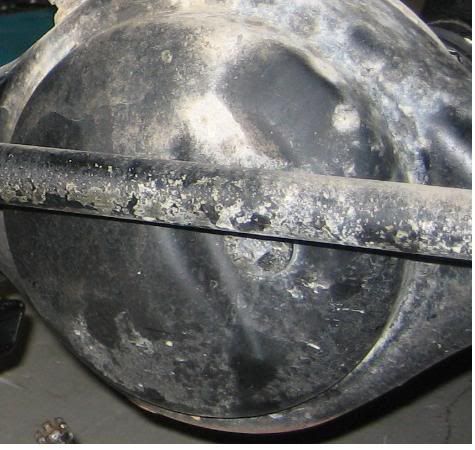

I tried to empty my diff oil out of my samurai last night but cant get the drain plug out, it has a 3/4" drive socket but is so tight that i'm deforming the bolt. Have tried heating the area around but no sucess. Any ideas?

You may have some success by using a hammer to shock the head of the bung.
Two ways to do this
1) Hit the flat part of the hex head 10 times or more. Be careful to hit flat on and not swell the hex so the socket won’t fit over it
2) Put a nut inside the socket, place over the hex and then hit the outside end of the socket whilst applying counter-clockwise rotation (undoing). If possible do as Krawlr says and use a long powerbar ie 450mm or longer and a single hex socket.
Either method may shock load the threads enough to release any locking medium like Loctite.
If using heat you need real heat like an oxy/acetylene plant. Don’t bother with a heat gun nor with one of those little yellow gas canister things, they just don't provide enough heat energy. Heating the diff-casing and threaded boss will expand this external thread and possibly loosen the stuck bung.
If the bung gets rounded off, then weld a long bar directly to the bung. Once it has naturally cooled off, this may allow the bung to rotate. Don't quench the hot bung as this crystallises the hot steel, which significantly weakens it.

Managed to get the filler plug out so I siphoned out the oil/water using my bike pump for suction (decided sucking on the tube myself wasn't such a good plan
Thanks for the ideas re the sockets but its an inverse square bolt so the 3/8th" driver without any sockets on is the only thing that fits,
I thought of using a rattler gun or an impact driver, would this work?
Still cant get the back ones out, I may need to try the real heat trick, i was using the yellow bottle gas torch and the heat was dispersing as soon as I applied it.

First, buy new bungs, then to get the old one out if all else fails, weld a nut onto the outside of it. The you can use a BIG socket/spanne/rattle-gun to remove it. Usually the welding process has assisted in breaking some of the thread-grip anyway.
I've started the habit of keeping a supply of new bungs, so that when I change fluids, if the bung looks at all beaten-up I stick a replacement in.
