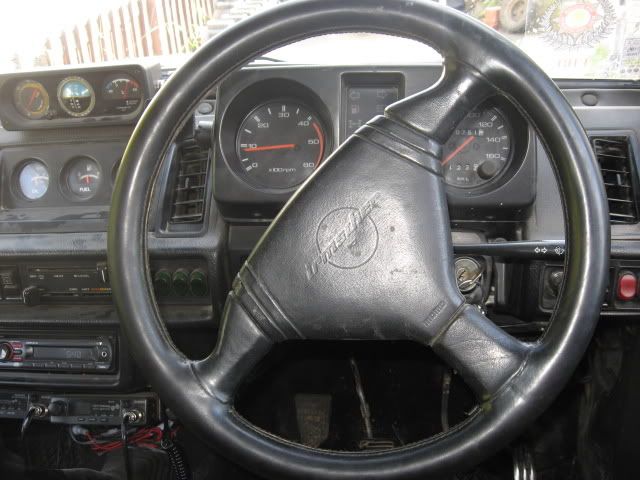

Steering wheel has moved !!!
After hitting something that was buried in the mud I was was driving through at the Slippery forest (see Rallywoods 3day event)
Too fast ... Hit very hard ...
my steering wheel has rotated almost 180 degrees ...
My question how can this happen ???
What is the easiest way to put it right ??

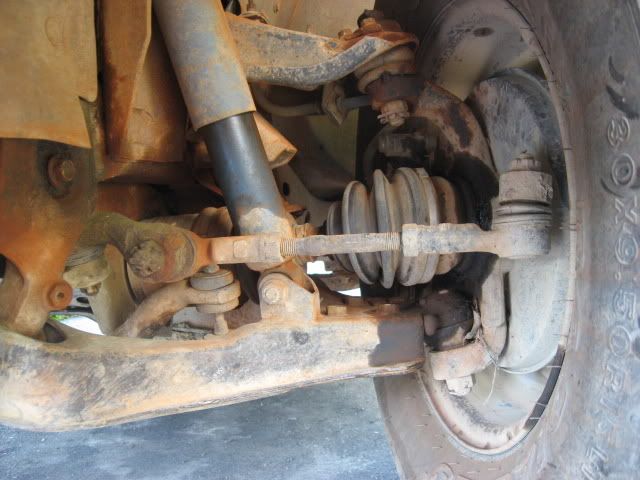

Post a photos of the front end (steering components) and experts on here might be able to spot the offending (i.e. bent) component.

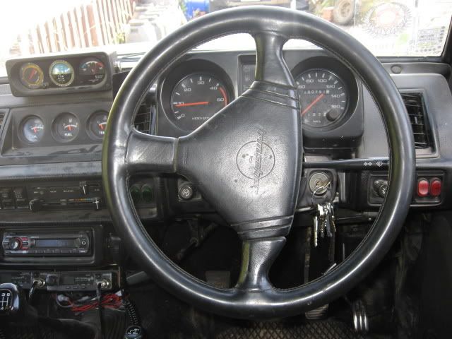

Re: Steering wheel has moved !!!
It was like this
Now its like this
OK so I got under there tonight and had a good look ...
Steering box arm to main link, solid as and the main link is straight
All joints are solid
The short arms on either end on the main link to the hubs are straight.
All the suspension parts are solid and do not appear to be bent
The other thing that I have noticed is that when you turn the wheel the smallest amount in one direction the wheels will keep turning in that direction until you turn it back the other way and the same thing happens
Whats with that ??

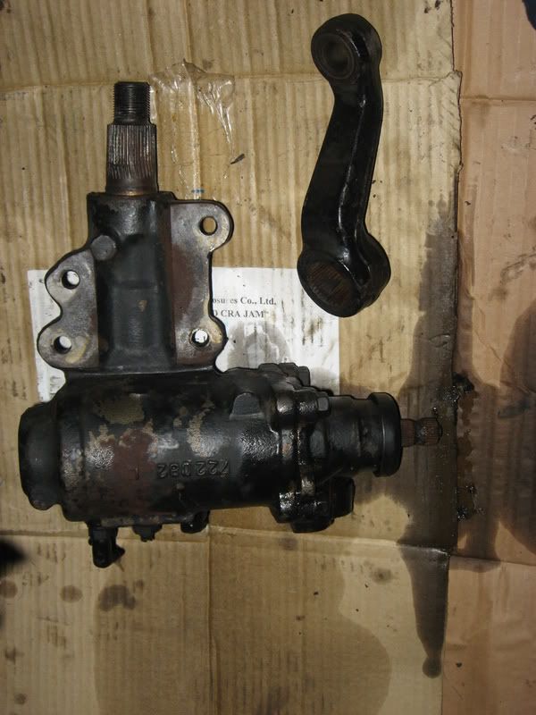

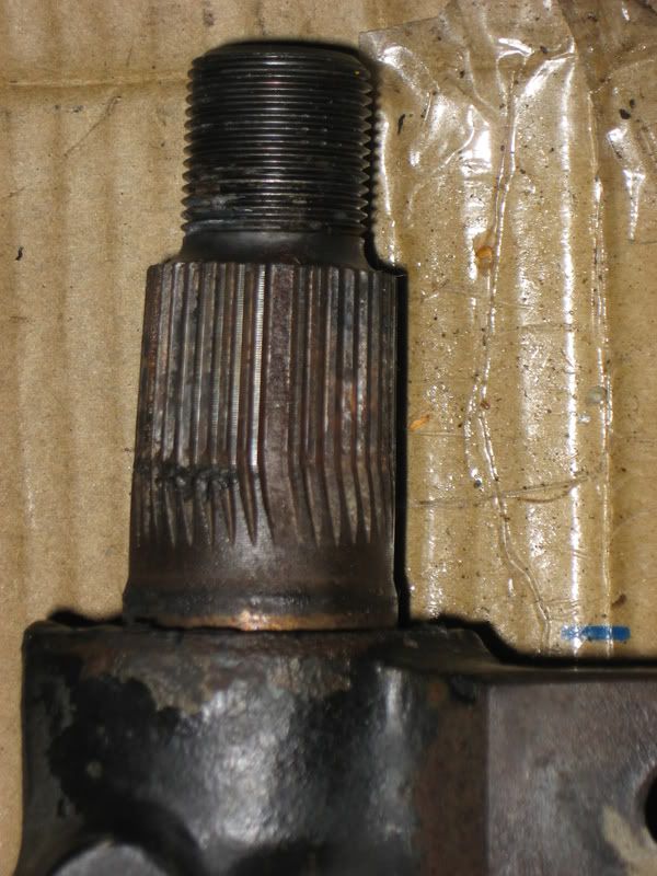

Well NJV6 you were basically right
I got the Steering box off last night, and then tonight I managed to clean all the greese and crud off it.
The first problem became apparent ....
Those splines are supposed to be straight
A friend of mine who also has an Isuzu has had the same problem found that when this had happened the shaft had bent along its length as well and also damaged the valves inside.
This explains why it was behaving the way it was.
Planing on striping it down to see what has happened inside.
Also looking for a second hand box
You know what they say... If you have a spare, you will never need it ... Now there's a Tui ad.
