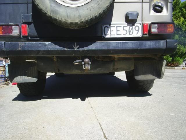

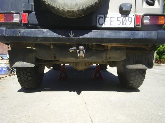

as you can see it sits a little low at the back which is a bit of an issue best seen in this pic
notice how you can't actually see the diff previously when 4wding i have been dragging my tank everywhere

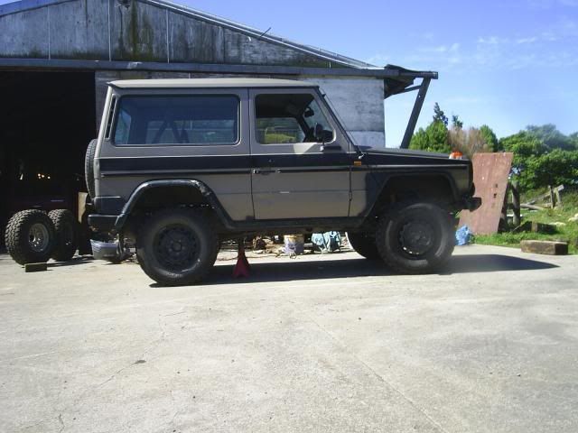

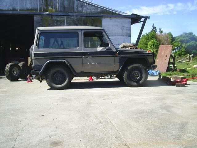

so decided i need some height
about 100mm on the back and 80 on the front looks about right
looks better from the side too
then yorick and i thought wonder what it would look like with 33 inch mudzillas
must admit have finalised the tyre size yet we are still debating that yorick reckons 33s but i think why bother going half way better with 35s what do you guys reckon

There is a little disagreement here I agree so I did a little GIMP modification to the pics and upsized the Paj's Buckshots to 35 for the purposes of comparison
and compare that to the 33s
Now personally I think it's all about proportions and the 35's are too big but the 33's look perfectly matched, obviously made for it.
