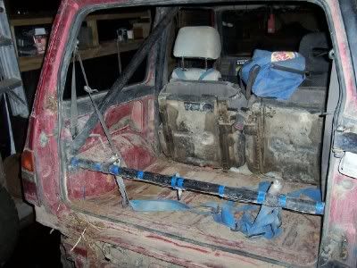

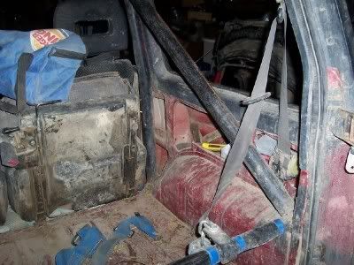

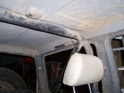

spanky
Posts: 716
Re: Vitara rollcage?
Post by spanky »
i will try to get some pics tonight of mine and put them up, where abouts in auks are you plenty of places around up there that could do a basic rear hoop.
