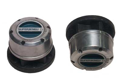

What year is the SJ410? I think some of the early hubs were always engaged... Do you have a photo of the hubs (like the middle bit of of the front wheel when on the vehicle)... It will not have auto hubs, it may have manual locking hubs which look something like these
(although those are aftermarket ones)...
(although those are aftermarket ones)...These suzukis have what is often referrred to within the 4wd community as having a solid axle in the front (although the name does not really describe it correctly) as opposed to many newish 4wd's which have independant front suspension (IFS) or (flipper front). Basically on a sold axle front end the whole diff/axle/housing/hubs all move up and down as one unit, and just need a joint (cv) to rotate for the steering, whereas on a IFS the diff remains stationary and cv joints allow for the up/down and steering rotation.
