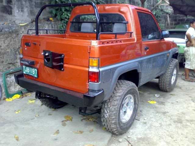

Here are some pictures of my Feroza that has 32" tires and a 2.5" body lift and 1.5" suspension lift.
I hope I was of any help :)
