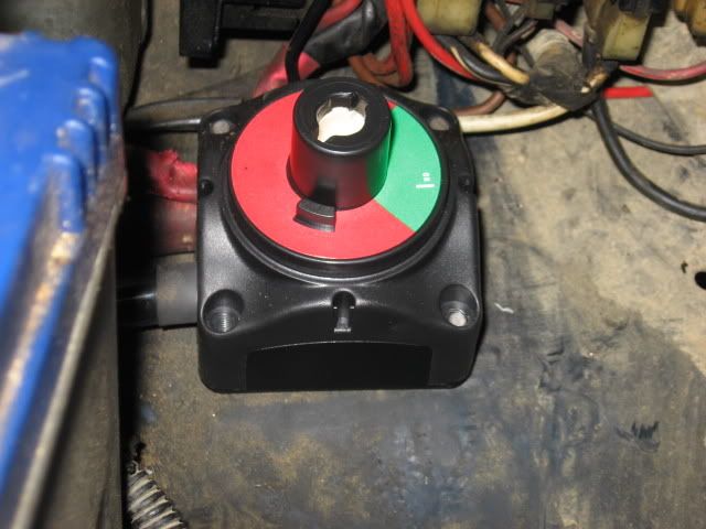

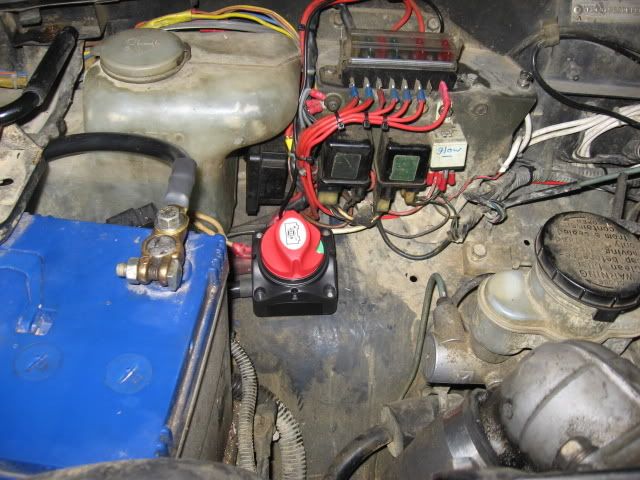

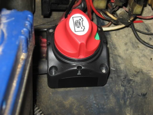

I have been thinking of fitting an Battery Isolator to my truck but all the ones that I've seen have an open back.
This has always concerned me and I have thought about monuting one in some sort of plastic box to protect the terminals from being shorted out.
The operating flag hole looks like would allow all manner of mud and crap in that may stop it working when you really need it.
Any way that's the background because I found a new model that has a fully enclosed back, so I brought one, then I spent a couple of hours today fitting it ...
The way I have wired up is there is a fused feed from the battery side of the isolator that feeds the alarm and the live side of the stereo so that it does not forget its settings
As an upside you can remove the locking key if you are parked in the bush making it a lot harder to start and drive away.

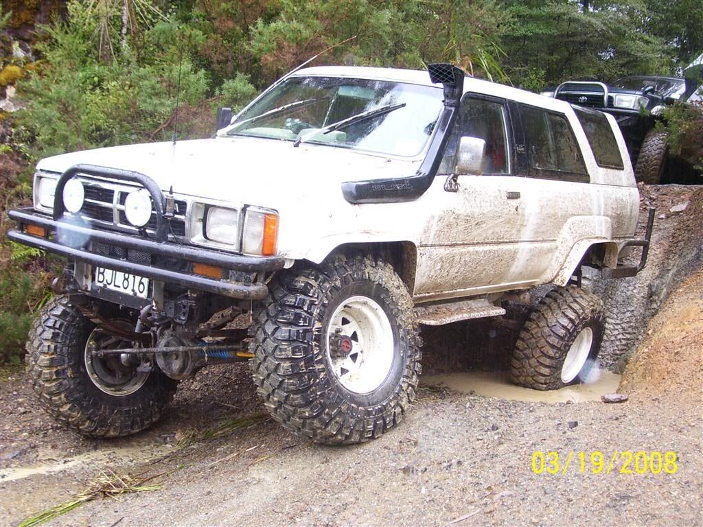

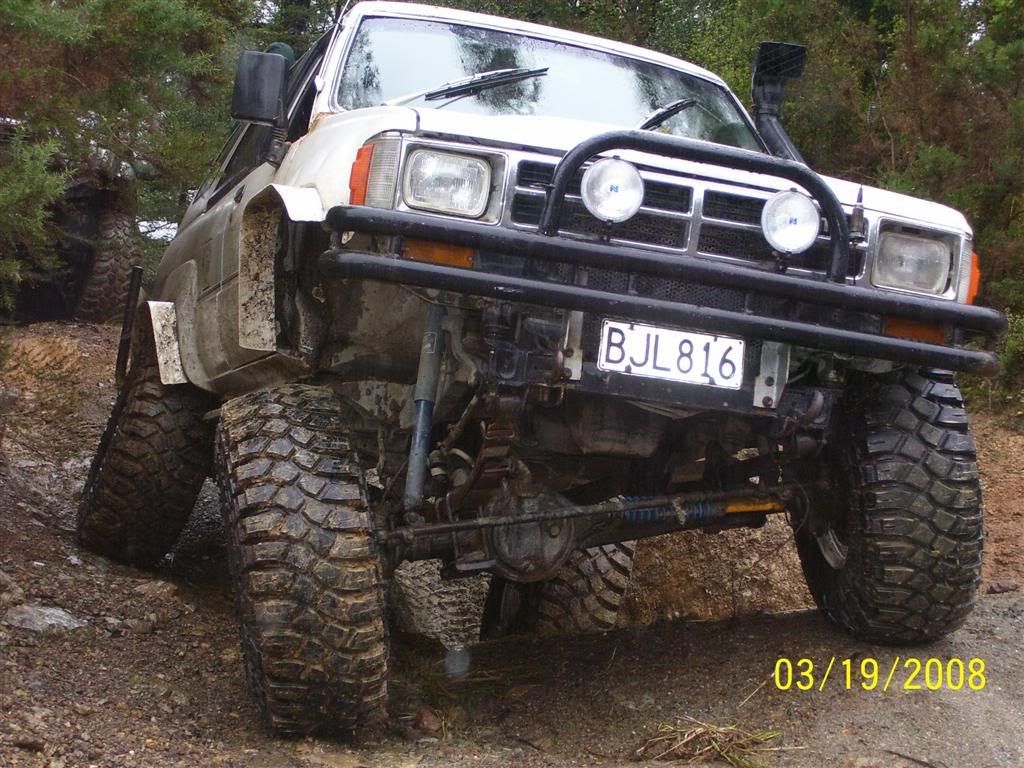

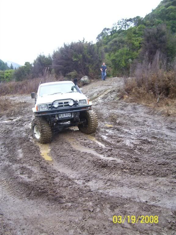

Well with the lovely wet weather we had today we headed up the Maungatapu track in Nelson today rather than hike up to the Porika track as planned.
I played around with the springs in the front of the surf yesterday to try get a bit better road handling, threw another leaf into the pack which raised the front about an inch and helped out on road no end. Found a few spots to try it out.

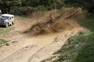

Watched Taz01 trying to destroy the Surf....................again
:lol:
And he succeeded :shock: :shock:

Where did you get the isolator from? Looks just like the thing for my project.

The main track was a bit messy in places but was drivable in 2wd on the way up, the side tracks and the pylon track where muddy as in places. It looked like a digger had been up recently and made a mess in places.
It was more fun than it has n=been for a long time that's for sure.
A Rav4 did drive past us at the bottom of the first hill next to the dam....

Heath wrote:Where did you get the isolator from? Looks just like the thing for my project.
Heath
I got it from a local auto electrical shop, I will look out the part number as I still have the packet in the shed
"Edit
Looking on the Hella site there is now a range of Battery Switches
I got the 4640 model
End of edit"

curly12 wrote: Image
Are you saying there is a Surf in this photo???
Awesome :twisted:
Awesome :twisted:
Yep :twisted:
