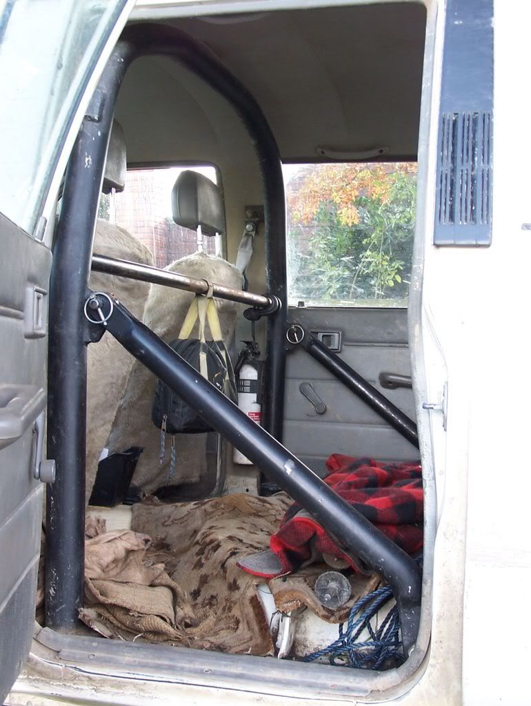

I was faced with same problem. To start with I just had a roll bar behind the front seats. You can view a picture in "bulletproof " hilux spec " under new members.
The Certifier told me this was not allowed because I had to have a 4 point mount with angle braces. The other condition was that I had to remove the rear seat because of impact injuries. I had no choice so removed the seat.
This is probably not over the top as much as it seems.
One day on a 4x4 trip before I removed the seat, a friend jumped in the back. We went through a washout that I did not see from the drivers seat and he cracked his head quite hard on the bar.

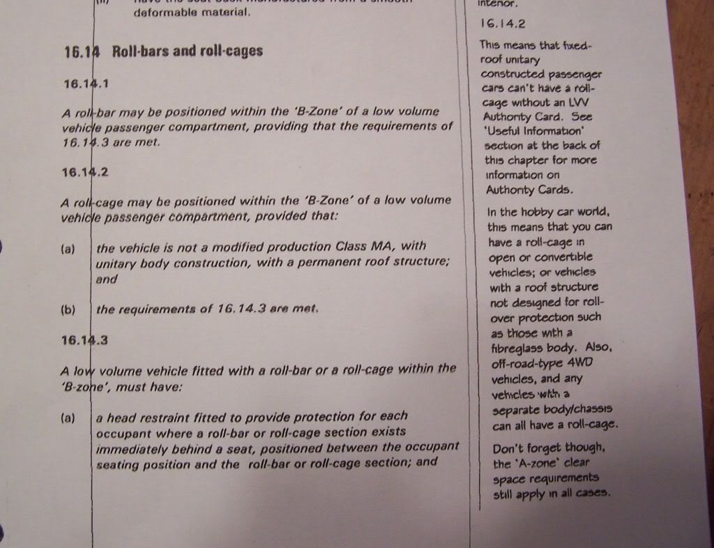

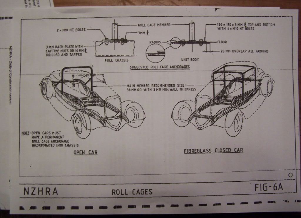

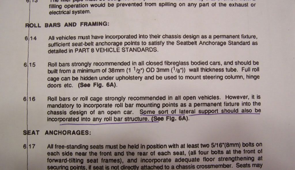

I have just gone in to my certifier and told him I couldn't find any thing on the LVVTA site about roll bars. He said you will not find it there. The standard they use is the one found in the " NZHRA CODE OF CONSTRUCTION MANUAL"
These are the relevent pages photo bucket has cut the sides off. to see full page save as
Also used is the "NZ HOBBY CAR TECHNICAL MANUAL"
This is the section they use over 2 pages
next page
I hope this sheds some light on the subject. I was also made to weld up all seat and seatbelt mount holes as well.
Richard

Unfortunately not all certifiers read all the rules and keep up to date. There is a drawing of rollbars in the old " Code of Construction Manual" but that document has been superseded by the "Hobby Car Technical Manual" which itself conforms to the Interior Impact Standard as found on the LVVTA website http://www.lvvta.org.nz/stdInteriorImpact.pdf
( I have a copy of both the manuals) Rollbars are allowed in 4x4 (MC class) vehicles and how they are built is not subject to certification except in terms of the Interior Impact Standard.
I see I replied at the same time as the old data was posted. That certifier should not be working from that manual... it is outdated!

This is the information my certifier gave me today. I have been through 3 certs. and when my bar was done about 8 years ago the rules may have been different so is probably irrelevant what I say.
Richard

Now, reading the LVVTA info (spec. 16.4.2 etc., in the Interior Impact info above), they are very definitely stating that they allow (adequately padded) roll cages to infringe on the 'B'-zone, which is where the two stays for the main hoop go as they run from the top of the main hoop on each side down past the rear seat passengers' elbows (but obviously with a bit of room to spare...) to the floor behind the rear seat. If this is incorrect, then the whole thing needs clarifying. Cheers.

If you have a look at my picture. I have made the stays so they are hinged at the mount behind the seat which is a lot more user friendly for loading the truck.
I hope this helps and if you want a photo of the rear mount I can give you one tomrrow.
Richard

In my case the reason I fitted a roll bar was because in Nelson we do alot of steep firebreaks that go up 100s of feet and sometimes you end up sideways so i wanted a bit more protection behind the drivers seat.This is not like trials where every bank is limited in height.
So instead of reinventing the wheel , I thought I might as well copy a design that had already been worked out and that is what I did. But had to remove the seat to comply with the LVVTA impact areas.
A friend of mine Paul Delis is the Fire Chief at Kaiapoi and he said that even though mine looks and is strong it would be completely useless after 2 or 3 rolls because as the momentum builds in a roll with 2 tonne of truck crashing on it, any mount will punch through the floor pan. My certifier also said I should have a full harness seat belt but that didnt come under LVVTA.
So it raises questions about why we have a roll bar. I still feel more comfortable with it, but it is probably just giving me a false sense of security and wont be any good if put to the test.
Richard
