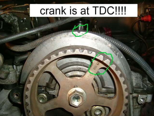

when the extractors went on and it started playing up we adjusted the ignition timing to see if would be any better and noticed that it was on full advance all the time. :?:
i thought yesterday id just check it out and got a timing light and everything set up and checked ignition timing.
spot on. hmmmmm :?:
i thought i would then check the cam timing and change the belt while i was at it.
this picture shows the engine at crankshaft TDC!!! :cry:
fugging hell, i thought the belt must have slipped at some point, :cry: but no.
it turns out the lad i got it off had just had the belt done before i bought it. :roll:
its not been noisy before, only had a slight mis-fire at idle. :?:
i think this will cure my lack of power and a few other things at the same time!! :lol:
ive turned it over and compression tested it and it seems that it will be ok. :D but we will see. :?
WATCH THIS SPACE!!!!

Well that sorts out the position question I had about the e mark on the cam pulley (cheers).
Must make sure I do it right.

the timing wasnt too far off what it should have been!!
they had fitted the cam sprocket the wrong way round last time the belt was done. :evil: make sure the cam peg (it can be seen in the picture) is at the bottom of the cam (not near the top like in the picture), and the outer 'E' mark at the top. then set your ignition rotor on cylinder 4.
i tried to set it up the way that the haynes and chilton manuals say and either i dont read it right or they got it wrong (they both say that the 16 valve is a g16b though, mine is a g16a).
heath, i will take some photos tonight and email them to you with how i did it, cuz its easier to understand. il pm you my phone number incase you get stuck.
its easy to do the cam belt though, i am paralysed in my left arm and i did it myself 8) (along with a full service, remove and refit a front axle mount, fit extractors etc etc).
like spanky says, its possible to turn the crank through 360' by hand and not touch the valves. :shock: mine sounds sweet enough anyway but i will let you know if i need any valves or anything when ive given it a run. ive been tidying up around the engine bay while ive got all these bits off, re-routing wires and pipes, and ive just removed the air-con system. (does anyone want to buy an air-con system by the way?? :D )
weemsy
