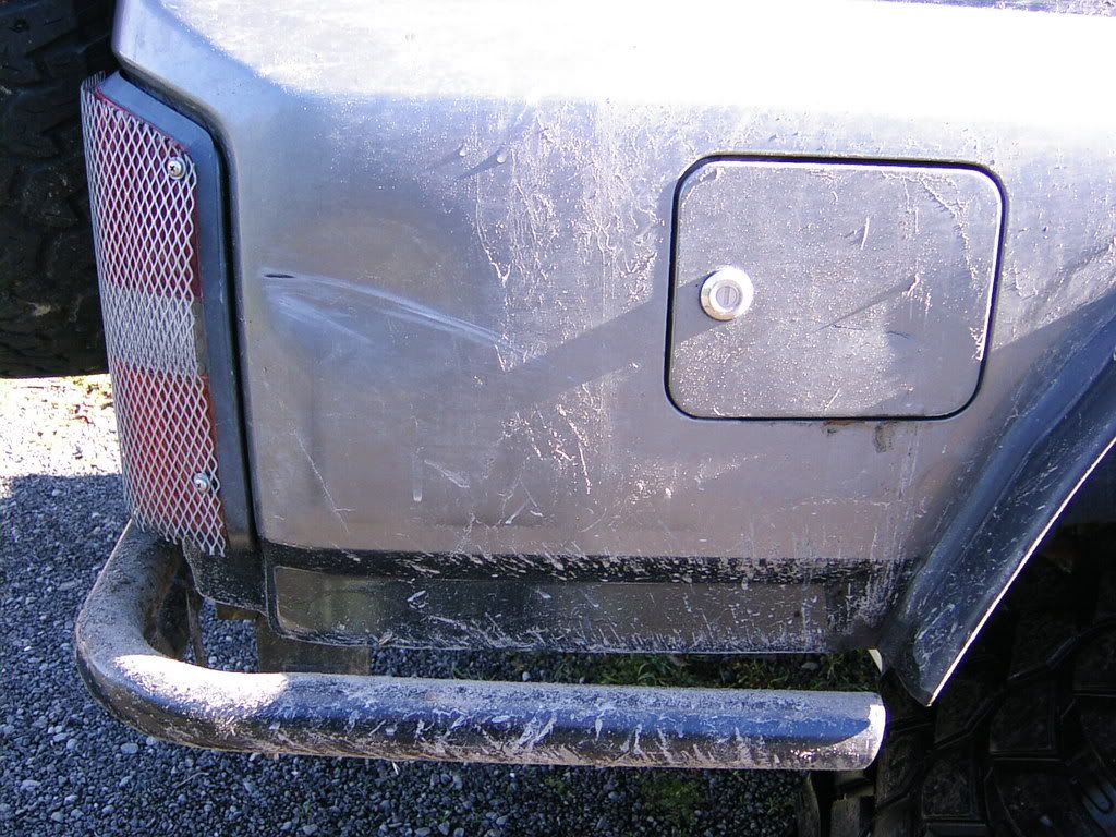

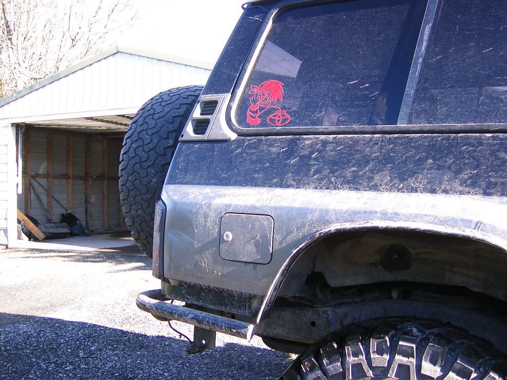

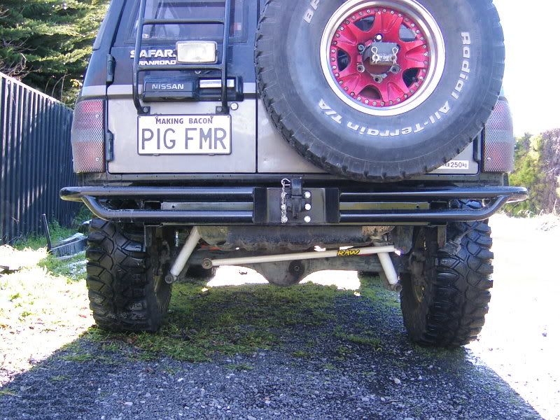

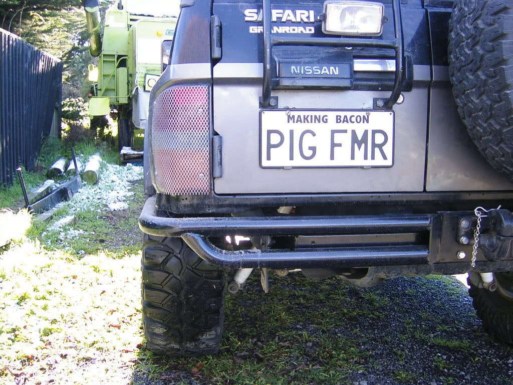

Image[img]
had this done last weekend and a new bumper made up,also will post pics of some rock sliders that were made for me and fitted by steve (supralux)

thats really nicely done vince..looks good.
at the moment i just flipped the bumper mounts upside down and chopped the step out just to lift it up and cover the gap between the body and the chassis :)

very nice work. how is the bottom sealed up?? plated over??

first remove the wires and then got the plasma out nice clean cut then plated underneath with the mig, time wise it took 2hrs and another 2hrs ish to make bumper and mount it,got to the stage where the rear quaters were getting knocked out of shape so decided to cut them off,spent the last 2mths getting mods done on the old tractor shifted the front diff forward aswell,lock up manual switch on torque converter thanks to Shane(whale owner),new shocks all round,rock sliders on thanks to supralux,another rear panhard rod made real strong,and some other stuff that i cant remember,
exhaust to be finshed off and stronger rear raduis arms
next on the list some 4.88 diffs from snake racing
and a turbo dont know which will come 1st
