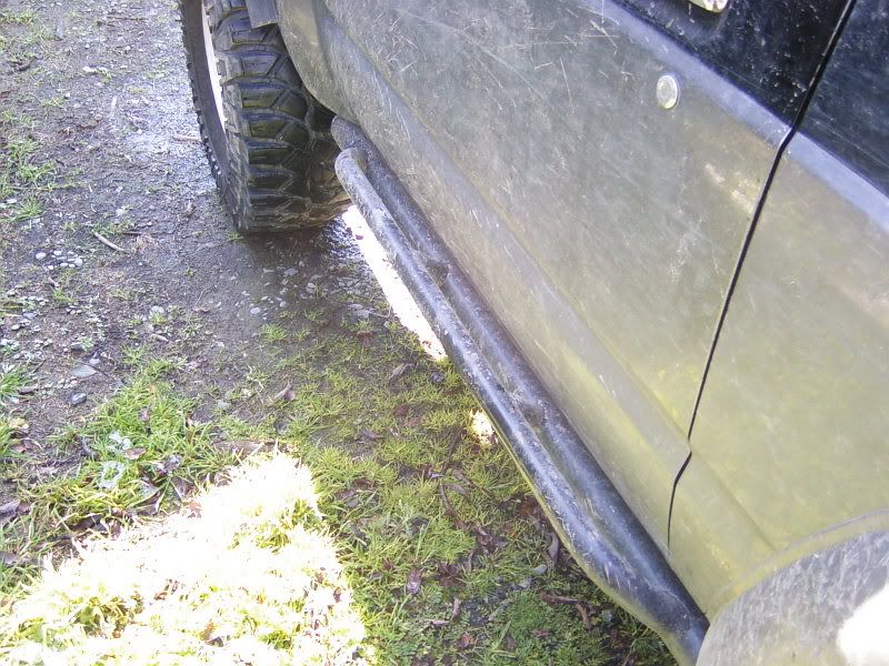

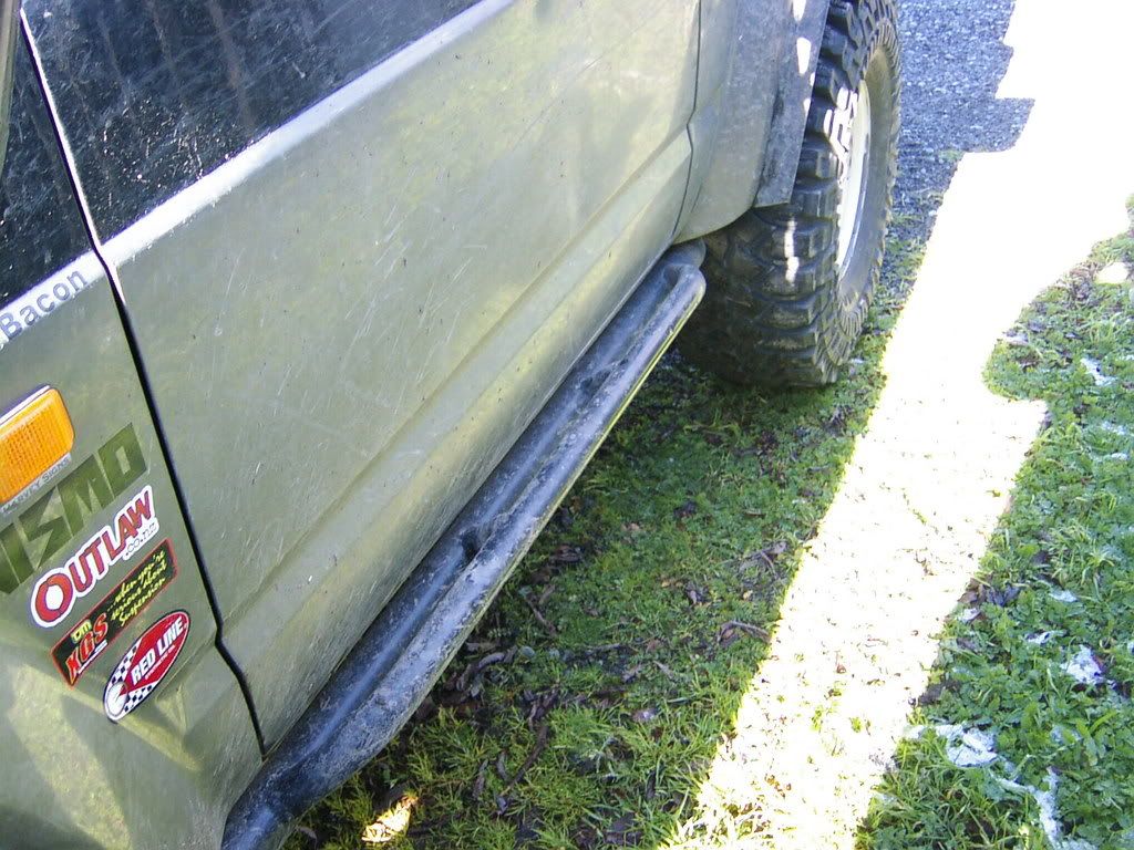

had these on a while now just i did not use photo bucket
anyone keen just PM supralux and he sort you out,,

Sadam_Husain wrote:Sent my truck down to stinky's workshop on Monday and Taz01 made up a few bars to protect my straight doors and sills![]()
