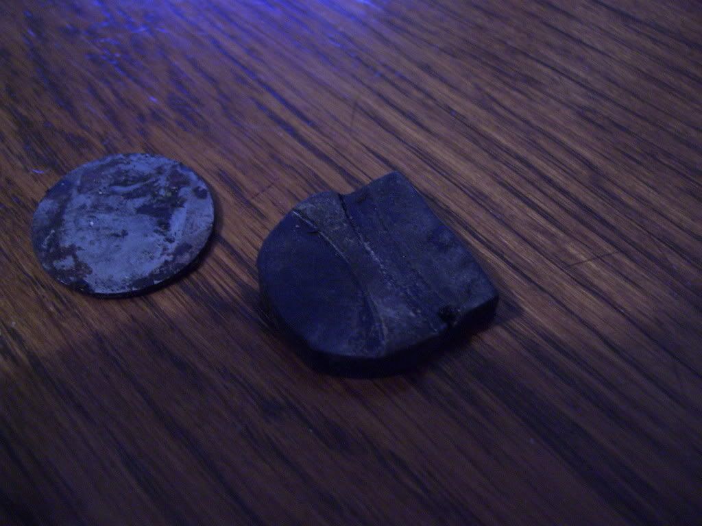

well got the bugger off just fine, took the motor apart cleaned all the parts put back together tested before i got it into the truck and works perfectly. put in truck then turned key starter motor runs but doesnt make contact with the motor or whatever it should contact with. then found a missing peice on the floor not sure where it goes though hope someone can shed some light on this for me.

Pretty sure it goes in where the lever that slides the pinion out. It will be why it is not engaging on the fly wheel.

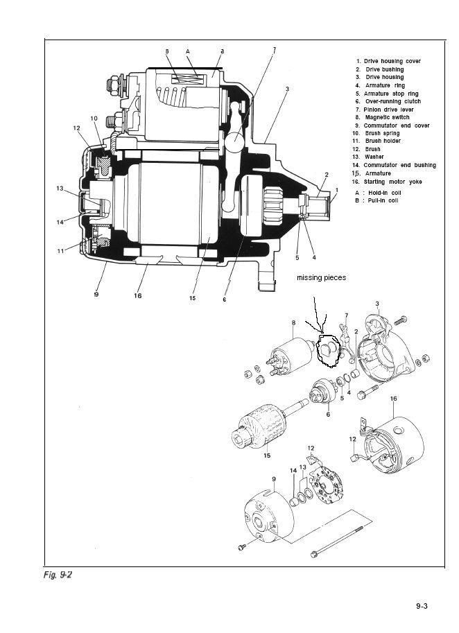

few pics here from the factory manual but can't spot that piece... also some of the test stuff...

and these are the pieces here:presume it goes into the solonoid somewhere oh and yes i got a manual but doesnt show much in there just shows outside of motor unless im looking in wrong page

Haha they looked a bit bigger in the photo :) Unless its what the level pivots on maybe...
