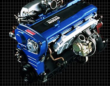

one of these

I've also heard of guys running the RD28 block, with the RB25 heads etc, might try to get more info on that. If it works, it would save a lot of time and effort I guess.
Would love to throw the RB26 in just to be different, if only I had the $$$

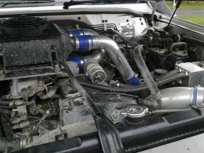

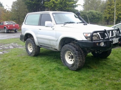

that's one crazy truck that one a wee to much grunt when i first had it,
I done all shocks and coils panards bushes etc, snorkel, and airbox which is out MU ,35's,manual lock up,front and rear bars,read heavy duty trail arms ,fan on intercooler,dropboxes, this your first 4wd ? just go real steady wiv it its still got heaps of bhp ,
I had it de turned from 480bhp it used to run avgas and 98 when I first got it, 15 to 18 litres per 100 k depends how u drove it,and I drove it from auckland now it runs 95 and dnt put 91 in it
its got
rb25 neo
glink ecu,
spiltfire coils,
1000 bhp bosch fuel pump u can hear it buzzing in the back,
760cc injectors,
gtx garret turbo worth big money , prevouis guy paid $2500 for that
greddy intercooler
greddy dump valve
internals have been done aswell stronger rods etc
2 stage boost switch on the dash
gearbox been re built,
motor dne less than 70000 ish k,s dnt knw what trent dne in it
4.66 diffs
rear factory locker
and shit loads more when i can remember,sent you pm with cell number
