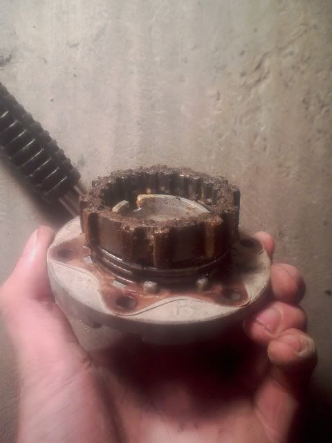

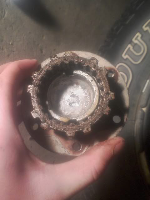

Im currently having this same problem, although my hubs were really hard to put into the lock position (used a hammer and screwdriver to turn one of the hubs).
If the hubs weren't greased properly would this be the problem?

I would always be very careful about checking out the hubs thoroughly before stripping down diffs. If one of them isn't engaging it can be very difficult to corretcly identify and isolate the problem. In the past my front-drive issues have all turned out to be related to some form of locking hub failure.
If you need excessive force to engage the hub (hammer and screwdriver) I would suggest that it is definitely time to strip, clean and check your hubs!

I second the need for a strip down, clean and regrease.

Pulled my hubs apart tonight, found the problem......
Cleaned and greased them, working fine now

dean zuk wrote:Pulled my hubs apart tonight, found the problem......![]()
Ahh, Yeah. That'll be it!!
