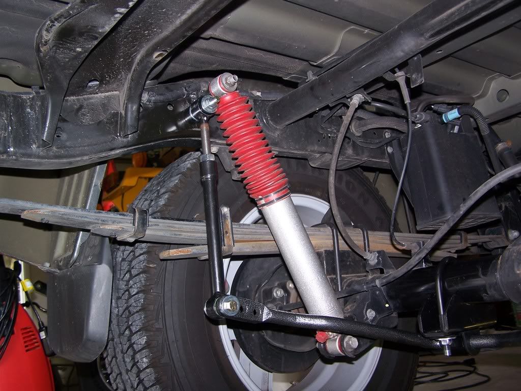

a few AU guys are looking at getting a batch in from USA. mostly D40 but it looks like they do D22.
i don't know if any are advailable here allready.
we don't do hard core 4x4, just light stuff. but we carry a lot of weight and do a fair bit of towing. rear sway would certainly help. the sway bar is U bolted to the axle tubes. i don't really like the way it sticks rearwould but they may be ways around that.
a pic of D40 install.
