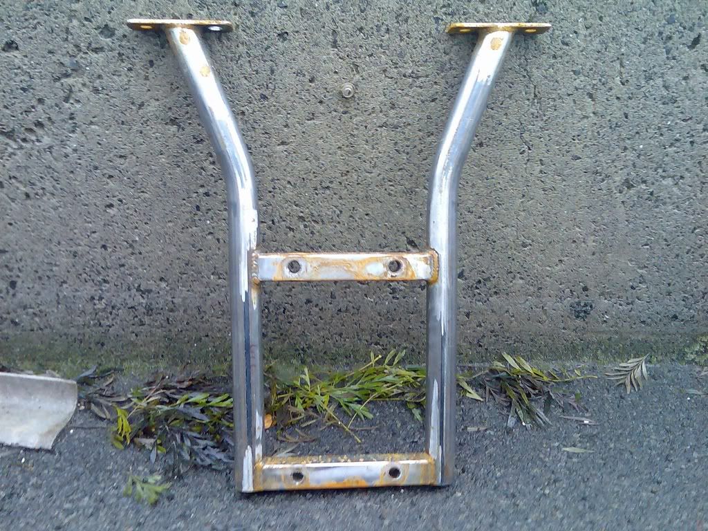

I have recently had made a mounting bracket for the UHF aerial and reversing spots/work lights behind the spare wheel carrier, and am just wondering whether to get it Galvanized then Powdercoated,or Zinc plated then powdercoated, or just powder coated....? Could fill up the tubes with some form of coating then tip it back into the tin, then just powdercoat the outside I guess.....
Spoke to the powdercoater and he can go over Galvanizing no problem, but he said it doesn't adhere to the galv as well as raw steel, and will potentially chip if hit hard. Not so much a problem for this bracket, but the next mission will be rock sliders and rear bars, so will be more important then.
Not really a huge cost either way with this small bracket, but just wanted to do it right and wondered what the 'correct' method would be.
Any suggestions...?
Thanks :)

mayby its just the photo....it looks like its made from stainless ??
easiest is proberly just spray on galv, otherwise hot dip galv. painting and especialy powder coating tend to rust under the coating.

Not Stainless, just mild steel - Roll cage tube and a bit of square box......
