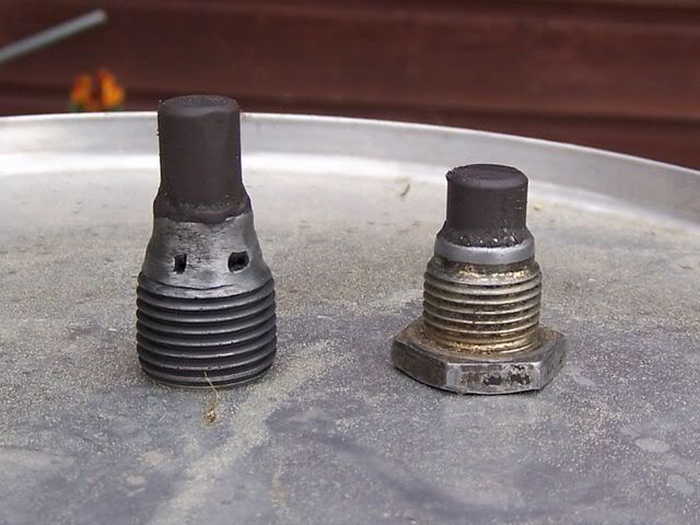

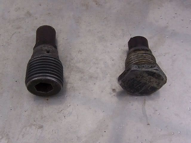

A very bad design of cruisers and hiluxs is the bung in the diff. They have a straight thread and the moment you do rough 4 wheeling you lose all the diff oil.
The hex only needs a sharp rock to loosen it and the vibration of the motor winds it out. Up the Rakaia I drove about 10 ks with no oil in the diff. After it happened 3 times I decided to modify it. All the tractors and trucks on the farm had TAPERED plugs and they never gave trouble.
So I went to the truck wreckers and found a suitable Tapered plug and then taped the hole out.
The plug on the right is the std Toyota and the tapered I replaced it with is on the Left.
Never had a problem since
Cheers Richard

hosehustler
Posts: 2051
Location: Brooklnands
Post by hosehustler »
I've had the same thing happen and seen others as well.
These are available for the Toyota's through Jafa.

Post by nstg8a »
is it the reduced profile that makes them better? ie less susceptible to getting smacked with a rock?

nstg8a wrote:is it the reduced profile that makes them better? ie less susceptible to getting smacked with a rock?
The reduced profile certainly helps but with a straight thread the bung only has to unwind 1mm and the bung is loose. With a Tapered thread it takes nearly take 2 complete turns to loosen it.
With the tapered thread you dont need the protection ring welded to the diff which only restricts diff clearance . Quite often when the diff is dragging an imprint is left in the ground where the ring is dragging .So removing this and fitting a tapered thread is far superior to a straight thread and makes the truck more capable.
Cheers Richard

Do these just wind into a std tap Richard? And what tap did you have to use? Like many others here, my front bung has been removed totally (diff shave) and you drain it through the bottom diff head bolts, but the rear one is still the ugly std unit. And although it has never come loose, that is only because th ring is flattened over the bung :roll: Draining it is a real mish!
I think we should call the Nissans BUNG trucks because that is the only good thing about them, and secondly they certainly fill holes up well. :lol: :lol: :lol: :lol:
On a serious note now. The tapered plug is a std half inch BSP tapered which measures a bit over 21mm where std plug is about 18mm. I didn't drill at all and just retaped it with a tapered tap with grease on to stop metal getting into diff.
I then mig welded part of the old plug holding the magnet on to the tapered plug as the picture shows.
Cheers Richard

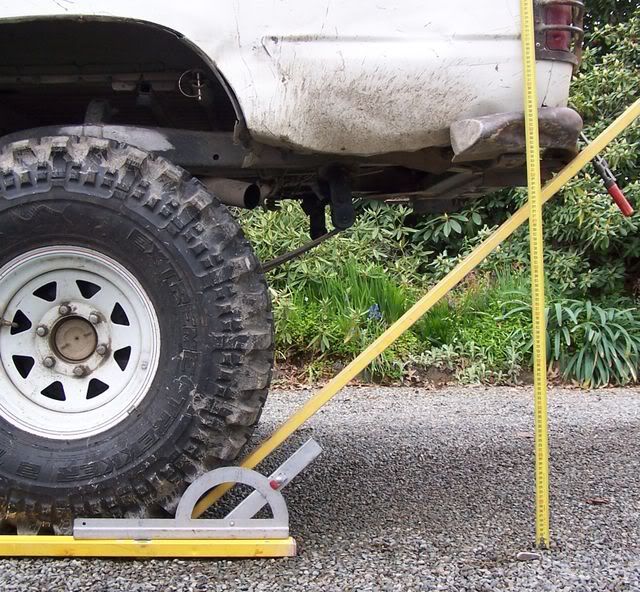

To get back on topic, here is another pic of Hilux
Richard
Never say die, up man and try

Post by Dace »
Bulletproof wrote:To get back on topic, here is another pic of Hilux
Richard
Have ya ever considers shortening the deck to improve ya departure angle?
Bulletproof
Posts: 1775
Post by Bulletproof »
I have mentioned on this thread before a hilux with the back cut off doesn't go as well as one with the overhang.
Having the overhang on a hilux is a huge advantage because with weight in it right at the back the suspension works much better and there is miles more traction on the rear wheels. Also it lifts the front and helps in bogs and climbing banks. Just like a see-saw.
We used to have Nissans ,hiluxs and cruisers come for our enduro with the back cut off and they just didn't perform
In all my years of 4 wheeling the overhang has never made me get stuck.
The picture shows my specs and you will see the rear bullbar is 850mm high with the weight on it. As the suspension drops the rear wheels are still touching the ground if I go over a vertical drop over a metre high.
Cheers Richard

Post by haynzy »
Bulletproof wrote:
Cheers Richard
That shackle angles steep cant have too much down travel on those springs
Bulletproof
Posts: 1775
haynzy wrote:That shackle angles steep cant have too much down travel on those springs
Hi Haynzy
You are very observant and brought up a point I dont think I have mentioned. The shackle angle is not exactly true because there was no weight on the back at all when the photo was taken, not even a spare wheel so it does move back a little bit more but not much .
Over the years I have had arguments with people about wheel travel . I have been out with many people who have massive articulation but on the track don't cut the mustard. Most of these have Coils. There travel up is 50mm and the travel down 300mm.
The problem with this is ,that as the wheel drops it has less weight on the wheel and therefore less traction and I drive past them nearly every time.
I work the exact opposite as you have observed and nearly all my travel is up. Therefore the traction on the wheel increases.
The leaf springs on the side at the back have no overloads and are quite flexible and the spring in the middle of the diff at the back stops it sagging and at the same time puts positive pressure on the side that is dropping and pushes it down as the other wheel is forced up.
The system works really well as many have observed.
Cheer Richard
