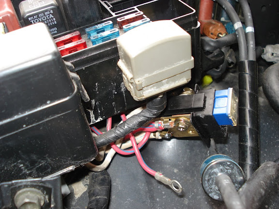

Then, for the first time, I used my brain and went down to supercheap to buy a replacement so that I could get a good look at what it looks like and check it for hidden catches, trapdoors etc. It was only then that I found out about the difference between male and female fuses! I also found out that instead of pulling, you have to release a catch and then push the bloody thing out through the bottom of the fuse box where you then find that it has two bloody great screws holding it in place.

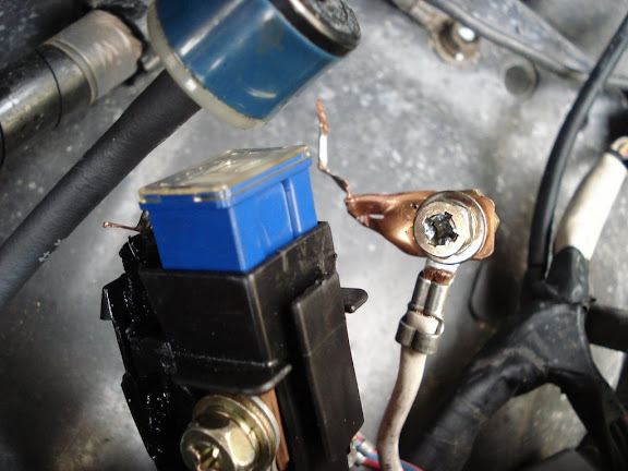

You'd think this would be the end of my exploits but no, one of the screws was fixed solid and I had to apply such a great turning force to it that it finished off the rest of the fuse as well as the fuse housing!
Not much left of the fuse holder on the left, behind the blue fuse:

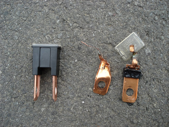

On the right is what remains of the first fuse:
