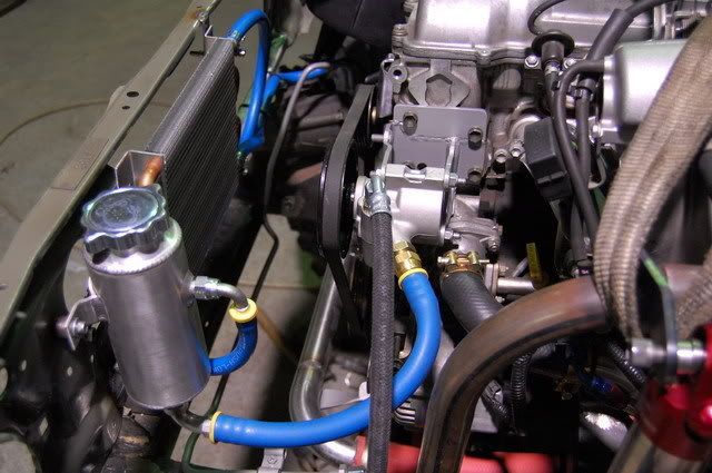

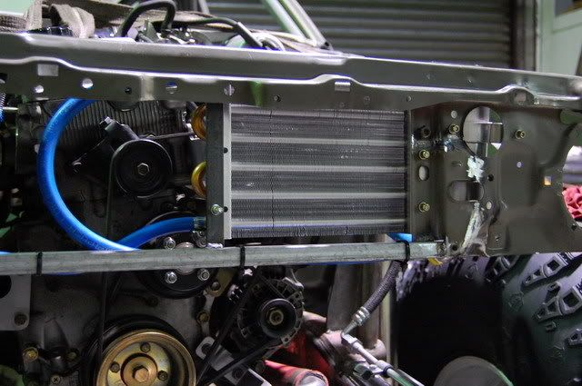

Not much done tonite...But I did get the PS cooler and reservoir mounted. Plumbed it all in, filled with PS fluid. Bled it by going from lock to lock 20 times with motor off, topped up the fluid then did the same with motor running. Seems to be good

You fitting a small fan to the cooler?

probly

Damn nice detailing Jafa.
Is the swirl pot reservoir of your making or part of the PS kit?

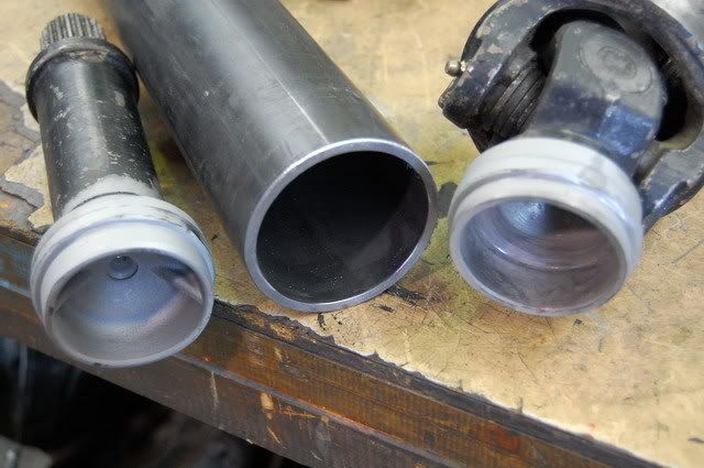

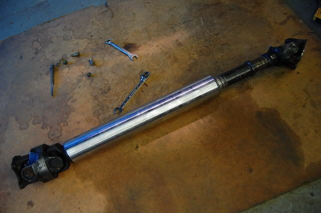

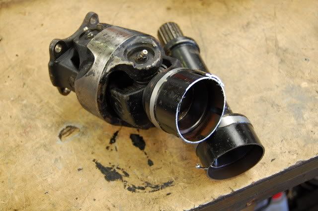

Front driveshaft has to be lengthened and strengthened, so its into the lathe we go.
Here's the bits before...
During
And after
Strangely enough the rear one will look the same just a fraction longer :lol:
One of the advantages of linked suspension is the lack of driveshaft slip required 8)

If they are that close you could spin up a spacer for use in case you break or bend one altho they look strong enough to put most to shame :lol: why does my ute not look like that :lol: oh yeah thats right knowledge, time, tools and money but looking bloody good

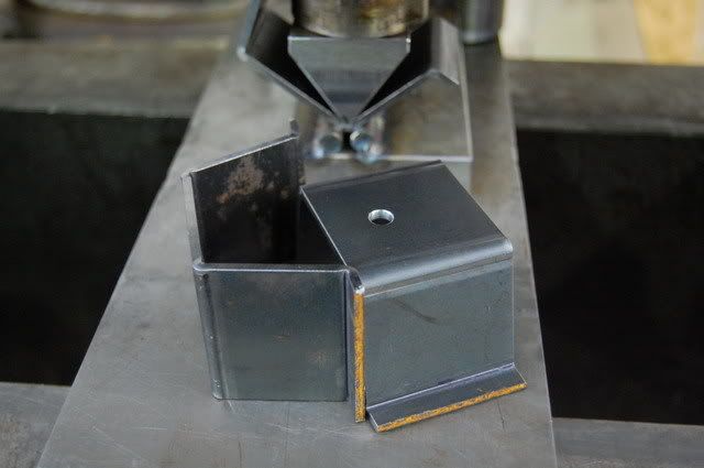

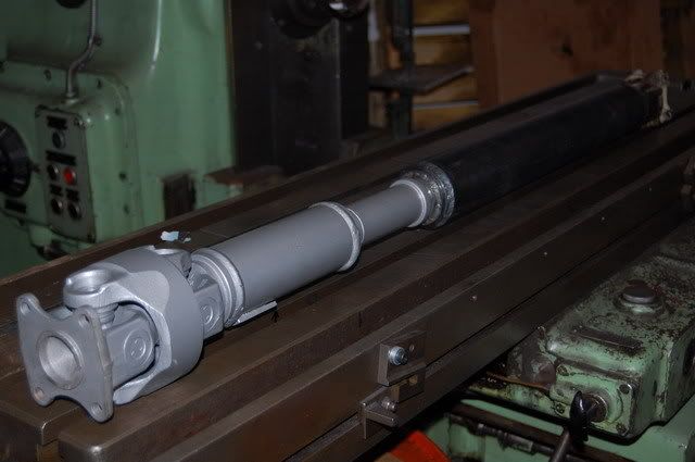

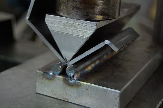

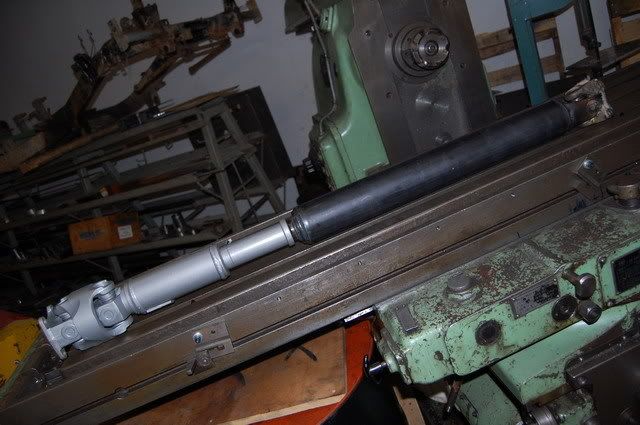

Finally got my rear driveshaft finished, had to machine the guts out of it to give me more angle, still cant get enough for max droop, so I'll have to run a centre limiter, its fine so long as its not on max droop with both wheels. :x i changed the shaft around when I re-tubed it so the slip joint is at the top, not at the diff end down in the rocks and shit, tube is 5mm wall thickness :twisted: :twisted: Double Carden joint is fully rebuilt with new bearings and crosses.
Made a hokey little bender for our press :D :D
and bent up some seat mounts
and fawked them up too, they are too low. They might become the passengers side ones :lol:

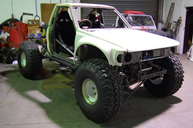

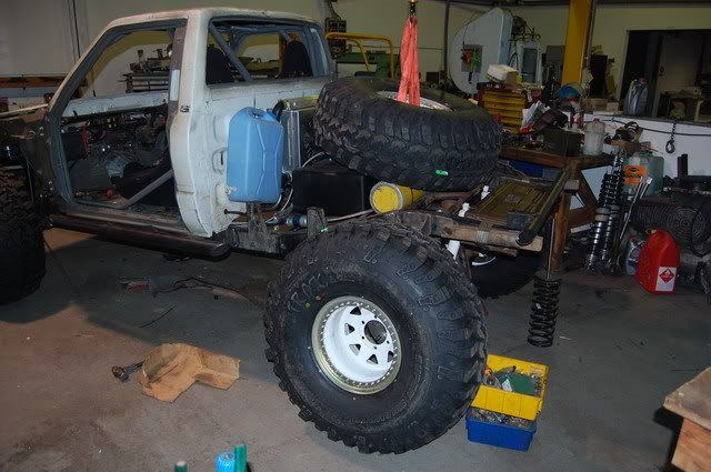

Mocked up some outside stuff tonight after spending an hour trying to find my clutch pedal.....still aint found it :x
Seats are in, got a tunnel coming from my laser cutting man this week.
Lookin like it means business 8)

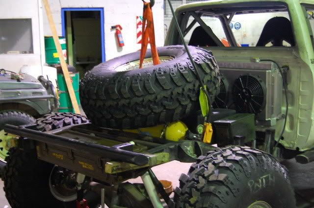

tryin to sort out what will go where on the back, mite make a little deck with cutouts for the air tank, fuel cell, and radiator.Really want to keep that fawkin great spare as low as possible :roll:

Are those fibreglass front guards?
Matt.
Re: "Jafa's Jalopy"...3RZ-FE and on 40's:)
so so sweet... mite have to swing by again see how those tires measure up... im sure the pic isnt doing them justice aat all! :mrgreen:
Jafa
Posts: 1307
Location: Katikati
Post by Jafa »
Mattman wrote:Wicked setup.
Matt.
Yes Matt they are, imported from US, but soon to be available from Mike at 4wd Fibreglass :D :D

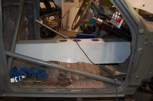

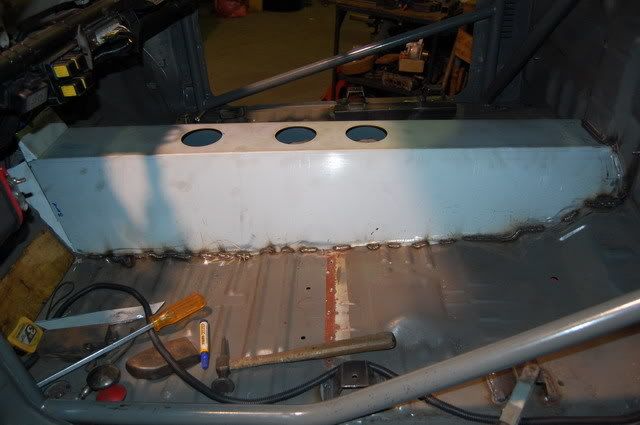

Did the tunnel tonite, its made out of 2mm, which is much thicker than it should have been, it was a real pain in the ass to get in, but with a floor jack and ratchet tiedown, it all worked out.
Battling with it
Finally in and welded pass side
All done, seats mounted properly. I dunno if there's enough room to fit the sticks to g-box and tf's yet, might need some trimming.

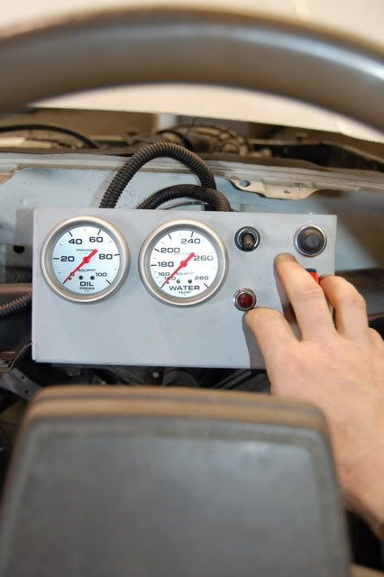

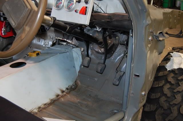

Nah seriously, its going to be cool to see what you do with the shift leavers and the pedal box, i see the steering wheel shaft is extended back to the right position for the seating, the pedals look like they are gonna have to be waaay back in the dor opening some where, and the front shift leaver is going to have to be a lot further back so you can reach it with harnesses on.
Which brings me to another point, how are you gonna reach the switches you have mounted on the dash from way back there with harnesses on??
I reckon seeing as you've got the monster tunnel, you should mount all the switches between the seats on the tunnel :lol:

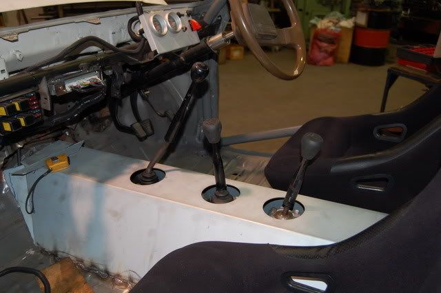

I've already checked all that out DB, I'm 6'4" so a Hilux cab is too short anyway :D The steering column is stock length, what you see as an extension is jut a collar that replaces the ignition key barrel etc. The pedals are stock with the exception that the brake m/c is tilted up a little to help clear the shock hoop with the longer FJ80 m/cyl. Oh, and the clutch pedal is a shortened zook brake pedal coz it bends away from the tunnel. Heres some pics of my sorry ass in place :lol:
The shift levers, if anything, are further back than stock as the engine is moved back about 50mm
Pedals
Dash is easy to reach
I do fit :lol: :lol: :lol:
Shifters

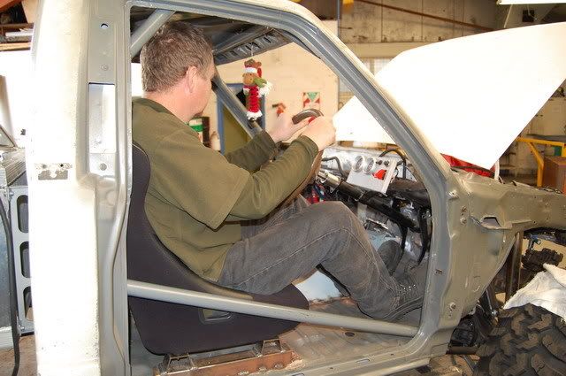

DieselBoy
Posts: 4568
Post by DieselBoy »
Jeeeeebus!!!!!!!
It actually looks kinda cozy in there when you see some one sitting in the seat :shock:
Photo's are so good at distorting things, it all looks sweet when you see someone sitting there!!!!!
