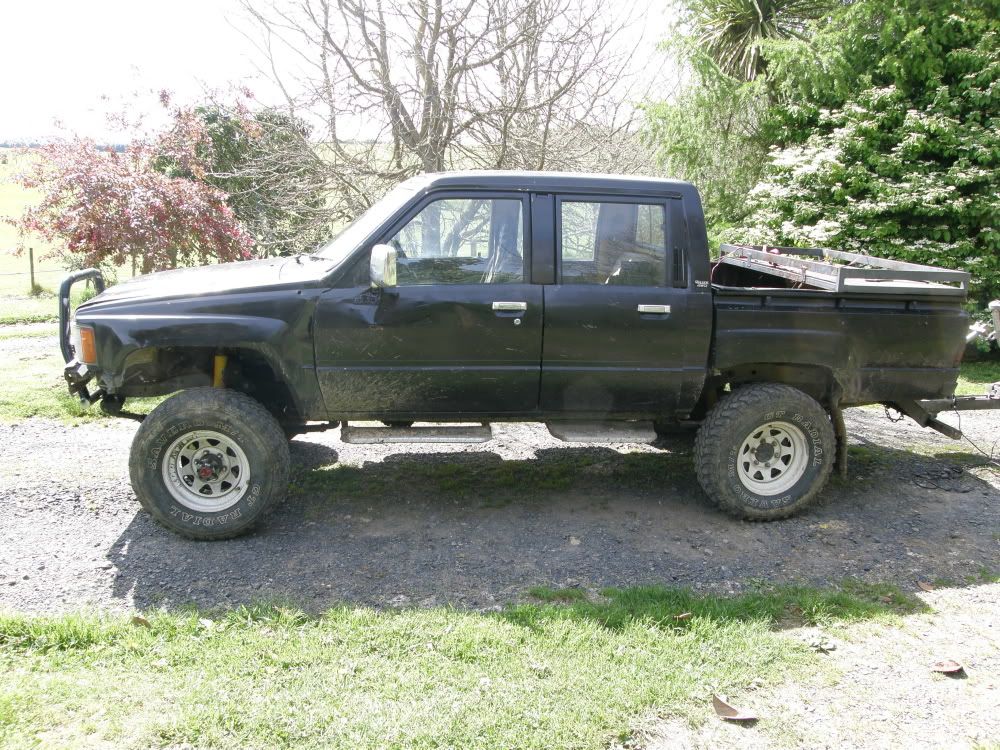

I brought a Ln 65 hi lux less than 6 months ago with the idear off doing it up. It start out as a stranded yellow d/cab with a transplant 2.8 out of who knows what with a rear LSD (tightened of course) with servos that were wearing fast.
First mod all be it a little 1 was the fitting of a nudge bar and two front tow hooks made the truck look much better 8) . Then it was on to things like the brakes whole new master cylinder then the steering box decided it had done enough and kicked the bucked so that was a total over hall.Then to get more articulation i had to get ride of the old monrow air shocks and the pencil thin front shocks and put in old man emu shocks all round with much improvment.And on top of that throw in 3 second hand doors a paint job and lots more really little things (and a lot of cash) and thats a bout it.and i cant forget a fully rebuilt front diff with a LSD as well makes this truck much better off road.
I am open to ideas on how and what to re power this little beast with and what sort of winches are other people using on luxs around the country.

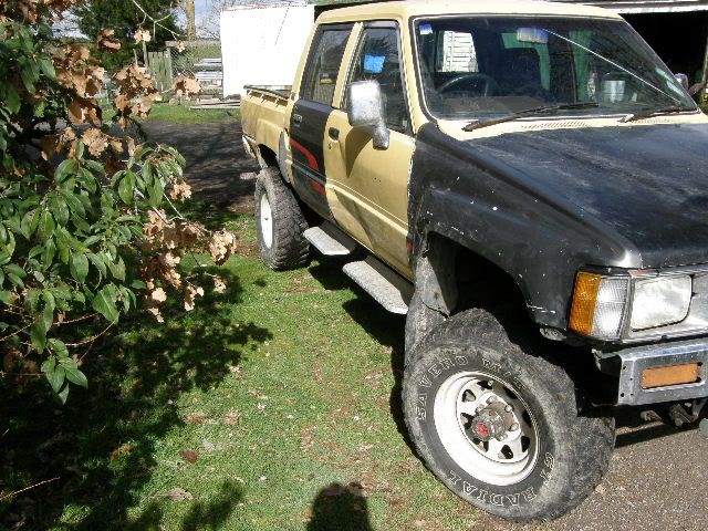

well i decided that i better update my post to date i have decided to keep the 2.8 so i have decided to do all the little jobs that seem to add up i have finely got round to instilling a battery tray as the battery has a bad habit of jumping around when 4wd driving got a new radiator to fix the over heating problems that i was having as the last 1 was all blocked up. so the next few things to sorted out are the snorkel 1 piece rear drive shaft as i have buggered my hanger bearing and then get the rear tow hooks sorted out. well that's me for now i will post sum pics soon.
