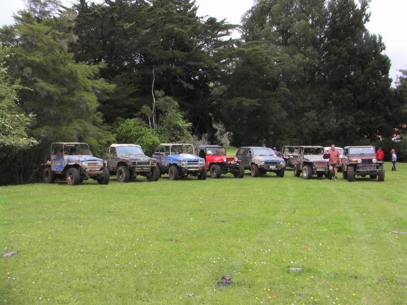

Did a fun Trial on Sat with the club. Good turn out, even better venue!!!!!!

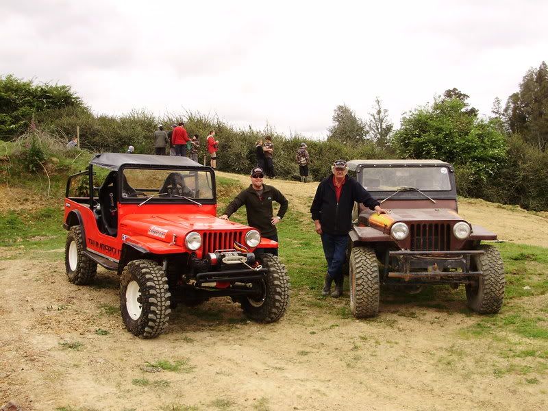

Thunderguts met one of it's 5 sister trucks:

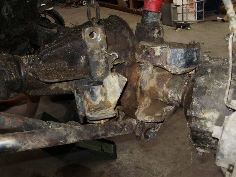

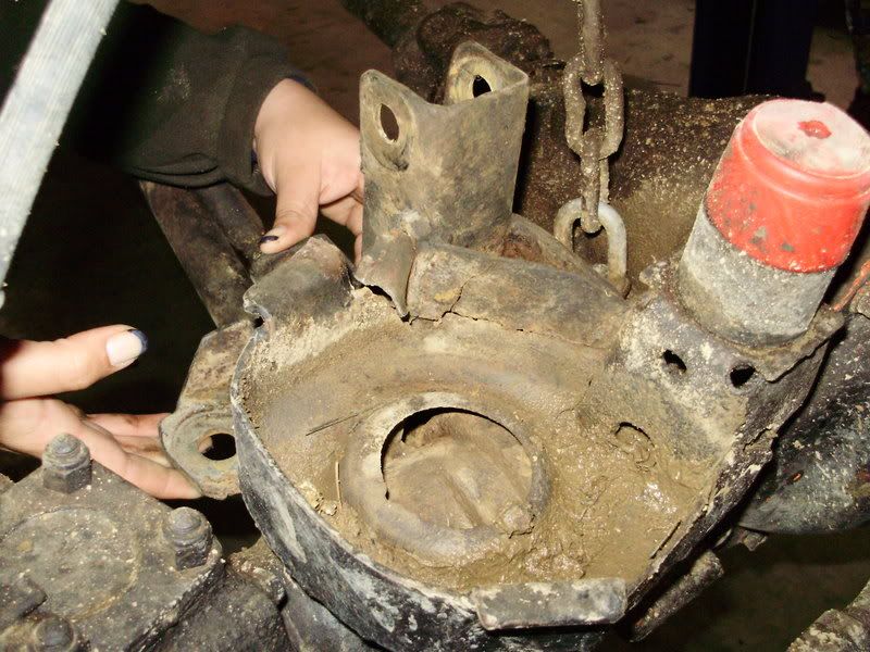

Then fell apart on us deep in the bush on Sunday. Must have driven it to hard the day before....
What you are looking at is the front top radius mount to the diff. Its ripped right off. In the trucks defence, it looks like it has been broken for a while, and then it finally decided to let go.
When it broke, the whole diff rotated, and i lost the steering and the front UJ bound up. I had to wrap the winch cable around the diff and pull it all down onto the bump stops to get it mobile-ish, then drove out in 2wd with limited steering so the wheel brakes :lol:
Steep slippery clay down hills with bugger all steering in 2wd are fawken scary!!!!!!
I'll beef it up a bit and it should last while i make up my mind as to whats going to end up underneath it in the future :D

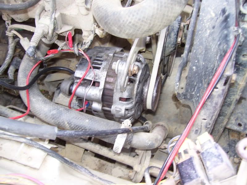

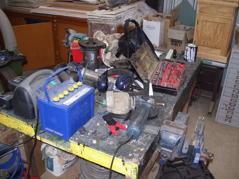

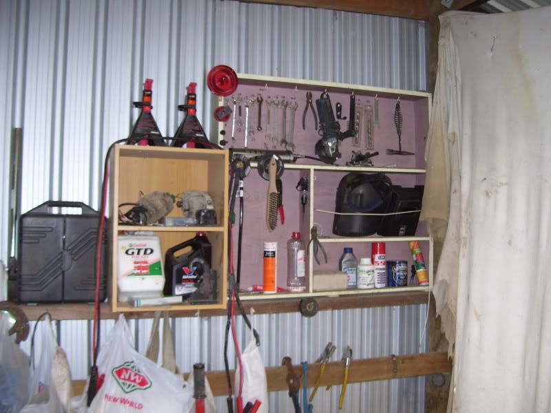

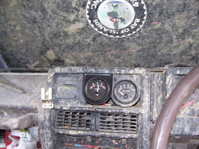

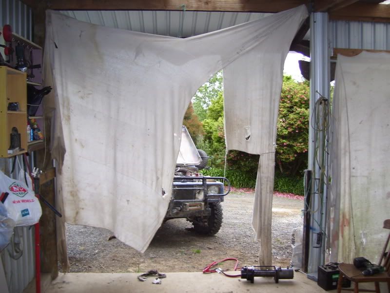

well i fitted my 100amp falcon alternator and bought a 680 cca battery for my winch to complete the duel battery setup (which doesnt go yet) and fitted a volt meter so i know when to stop winching. also cleaned up the mess in the photo and put up a cabnet for me tools and as you can see in the last pic the great security doors we have aranged to stop my stuff going missing.

new2zukes... that securtiy door looks like it belongs in the hokianga.... you sure youre on the right coast?

yep im on the right coast but havent got round to making some wooden doors yet. it will come, we have been talking about it for some time now but it will come (hopefully)
