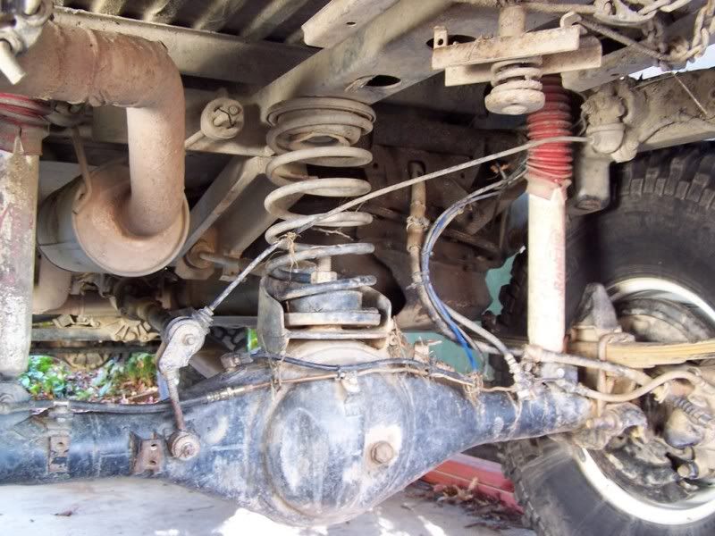

On the back of the rear diff head there's a bolt which has a line going to the proportioning valve which is on the chassis.
You should just be able to give the nuts a couple of turns and that should change it a bit.
stolen from bulletproofs thread.
Wouldn't have thought you would need to adjust this on stock standard suspension though.
