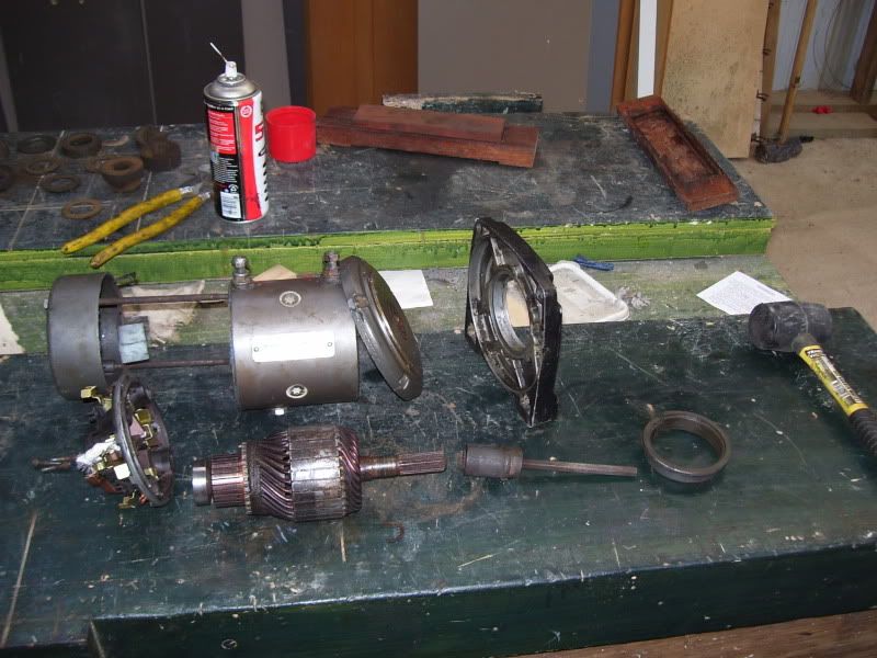

first is the motor assembly.

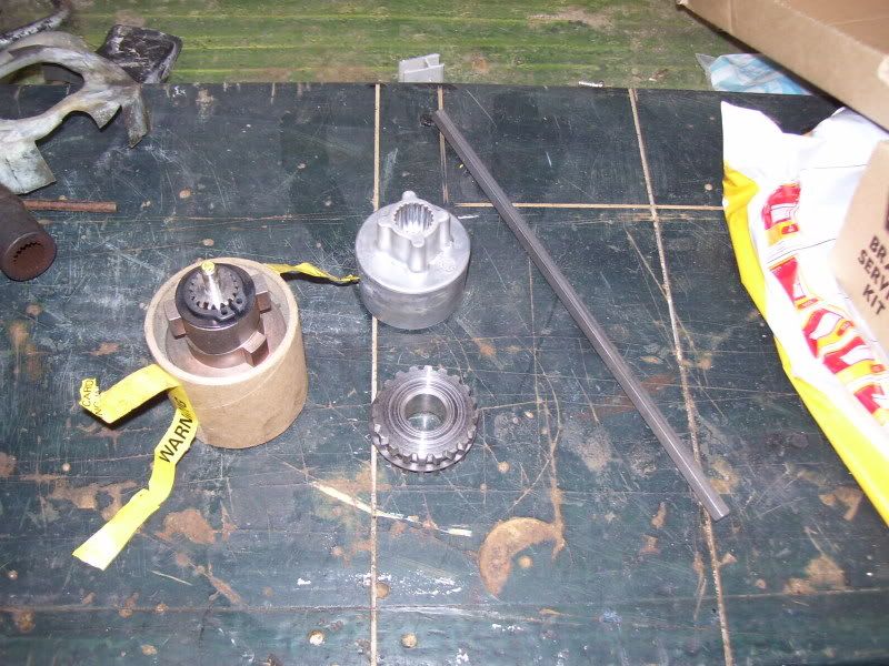

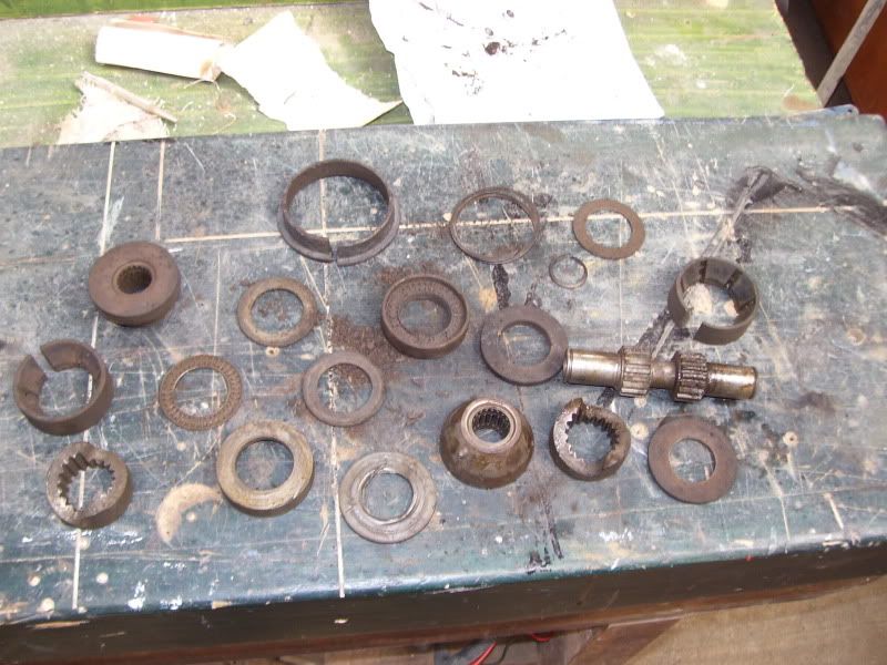

then its the break assembly all in bits but NOT IN ORDER as it all fell apart when it came out and most of the brake assembly is stuffed so its time for a new one.

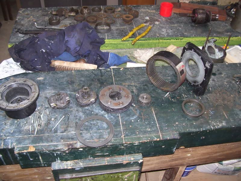

now is the gears which i will finish cleaning up tomorrow as there was a ton of water in with the grease which is usually not a good sign. so il re greese tomorrow too.
