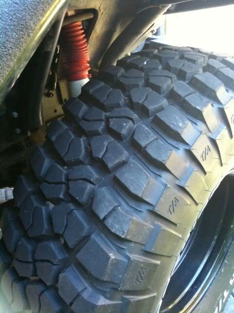

I've only had these new style BF Goodrich KM2 35's for a week. yeah yeah, they will probably never get muddy but. On the road I've found them better than the Goodyear Wranglers by far.
They were around the same price as the Wranglers too.
gary_in_nz
Posts: 636
Location: Hawkes Bay
Re: What 35" tyres shoud I get??
Post by gary_in_nz »
cool, look good pete, how many kms did you get out the wranglers?? like to know how many kms these will do on larger trucks.
petefj40
Ms Daisy
Posts: 4218
Location: The Mainland
Post by petefj40 »
gary_in_nz wrote:cool, look good pete, how many kms did you get out the wranglers?? like to know how many kms these will do on larger trucks.
I couldn't be 100% on that Gary because my speedo registers slower than the actual speed. But at a guess approximately 60.000ks with around 6-7mm tread left.
