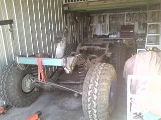

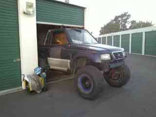

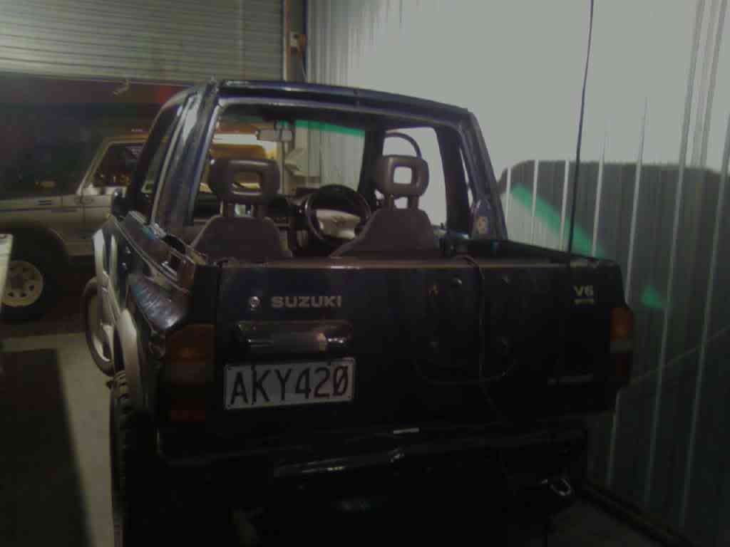

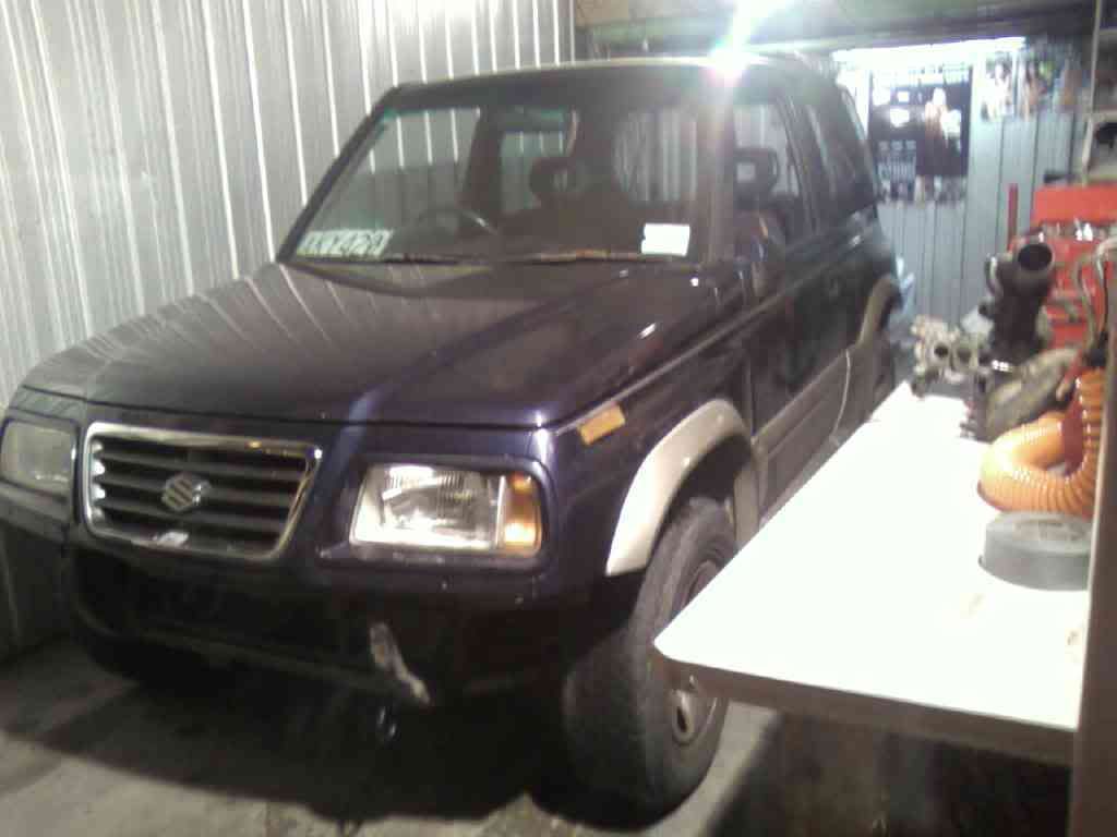

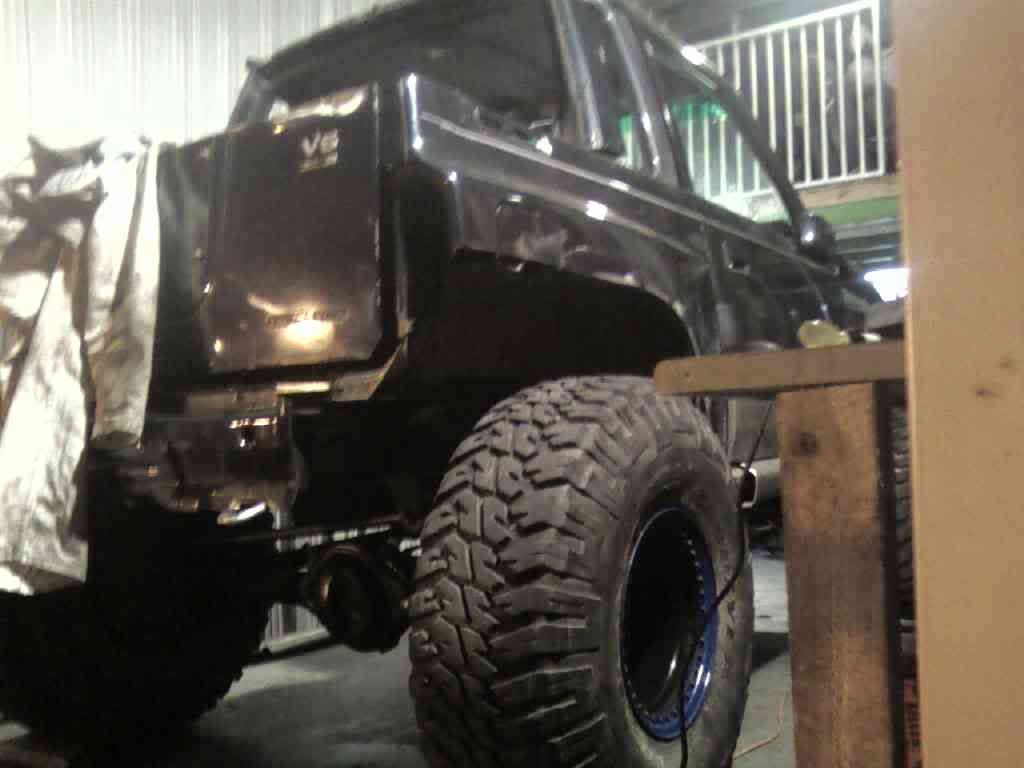

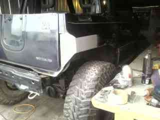

As i bought it, a bog standard 2L v6 with a farked engine (as they do)

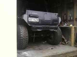

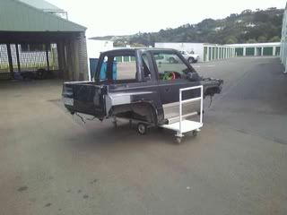

some chopping began (ute chop)

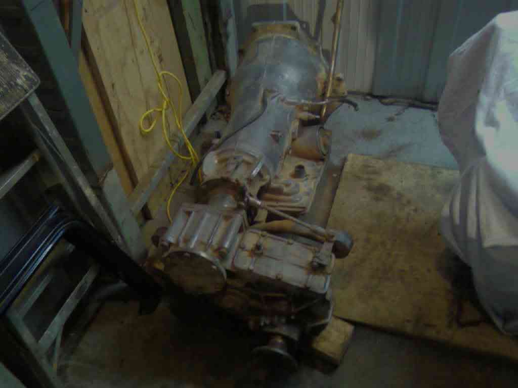

The trans assembly arrived, its a holden auto adapted to a cruiser transfer case with a lower gear set in it (thanks pedro :twisted: )

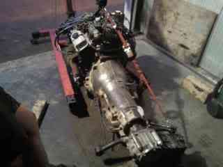

then a motor turned up

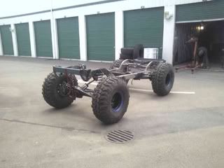

Some more chopping and welding happened as we put some prado diffs under it and extended the wheel base front and rear

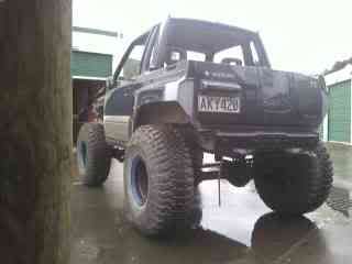

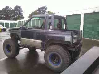

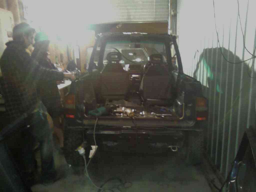

The most recent efforts, body off the chassis to mount engine and trans etc. took off my 37" MTR's as there sold to Rokhound and put on my new 36" iroks on my 10" beadlocks
In the shed
Updates to come as more gets done providing this thread doesn't get filled with dribble :D

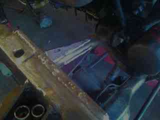

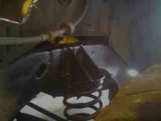

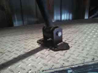

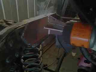

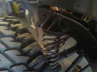

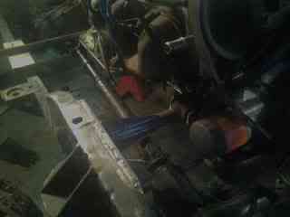

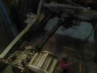

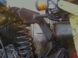

couple pics of what I did get done.....one engine mount :lol: and got the other side sorted just gota fab it glue it together and bolt it on.....got my drive shafts sorted (know what i need to do....and figured my trans mounts so will get them done when i get around to it :lol:
Drive shaft angle isn't looking to bad....i thought it was gonnna be really bad but it turned out ok. and the trans and transfer is totally flat bellied and at the bottom of the transfer its 600mm off the ground :twisted: and my radius arm mounts are 510mm off the ground so i dont think i should get hung up on to much stuff :twisted:
The engine side of the mount
Chassis plated and beefed up with mount glued on
Gusseting :twisted:
:twisted: :twisted: :twisted:
and the front d/shaft and engine mount
Please excuse the crap photos :D
My driveshafts are exactly the same length which is how i wanted it so i only have to carry one spare and it fits front or rear :lol: :twisted:
