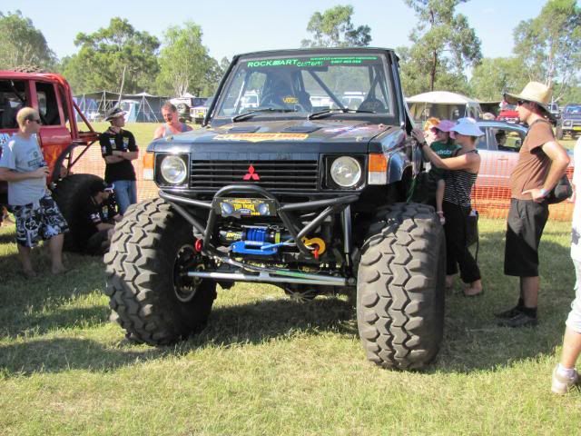

Some pics of the work so far. Some things still to be done.
Add nudge bar and brush guard mesh on the front. Bash plate on the back. Set up winch mounts on the front for next batch of chinese winches.
Exit angle without the bloody great bumper and long towbar and extraneous pieces of steel. One weirdness, inside the bumper was a bracket with a solid lump of steel about 100x80x80 rubber mounted inside... I have no idea what it was
Entry angle is now what all Landcruiser owners wish they could aspire to. For Cruisers, thousands toward drastically modded suspension... For a pajero 5 minutes with a disc grinder and cut off disc! Sweet!
Add some 33x12.5x15 Buckshot Mudders
Hooks (Rated of Course) front and rear
and it starts to look the part and becomes a very capable wagon
And just to prove the point, next day take it to the Laurie Sanson and win Second in Class!
And do it in comfort... I left the suspension seat in of course!
Brilliant!
