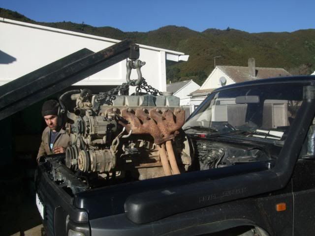

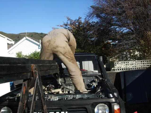

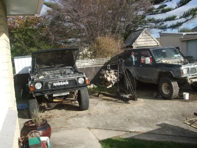

Yeah, yeah I know it's not the weekend but for me this whole week has been my weekend. So on that note, it was time for me to swap my motor and box into a new body, chassis and all.
Must be flintstone power... :roll: :roll:
Old body on the right, new one the left
Just a small donk going in :lol: :lol:
Get in there ya :beep: :beep: :beep:
There ya go, new home!
More Photo's are here, will add more once it is finished and running.

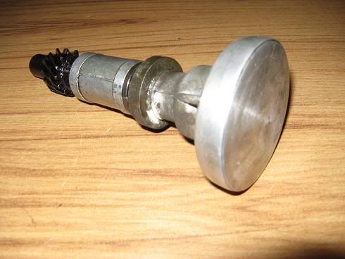

Hopefully get round to fitting this distributor
well whats left of one.... :lol:

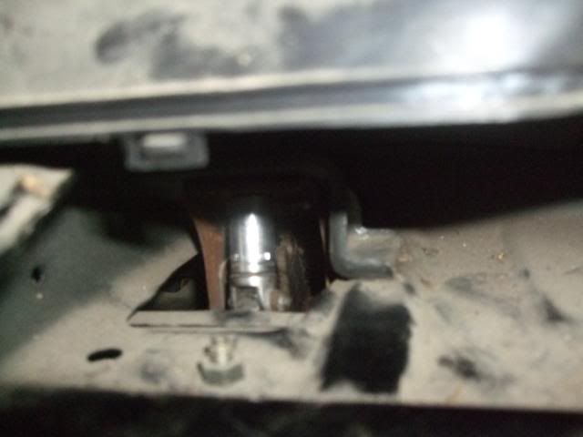

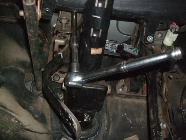

Just posting these pic's for Sadam and Skid, hehehe managed to get a socket on there and didn't have to remove the whole dash!
8)

Yeah um..... sorry about that Reece.... will only be a few screws to put that dash back in :oops: :oops:

that looks like the clutch pedal in a safari,I've just fitted pedal in my one(was auto) but not done that top bolt yate.looks like fun

You would be correct there, and it is not easy to get in there, remove the speedo cluster and use a magnet to get the bolt in there, then go up from underneath and with a socket and universal... best of luck!
I had help to get it started though hehehe in the lines of a your fellas hand!

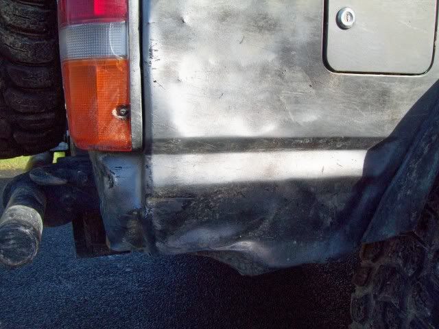

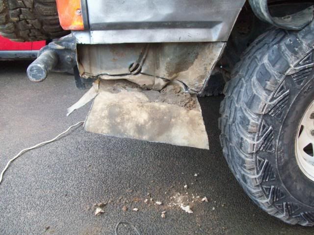

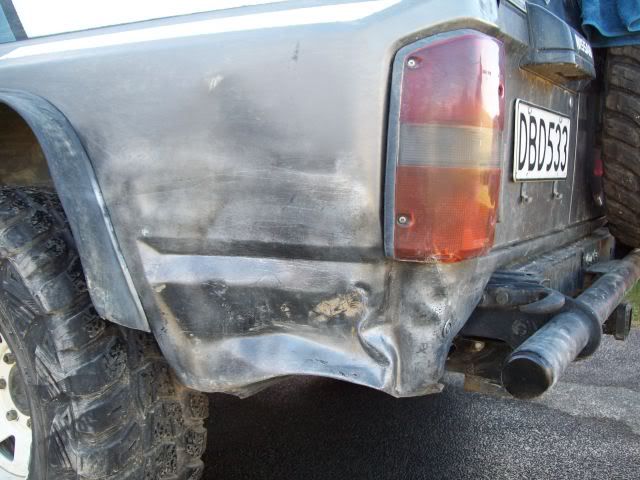

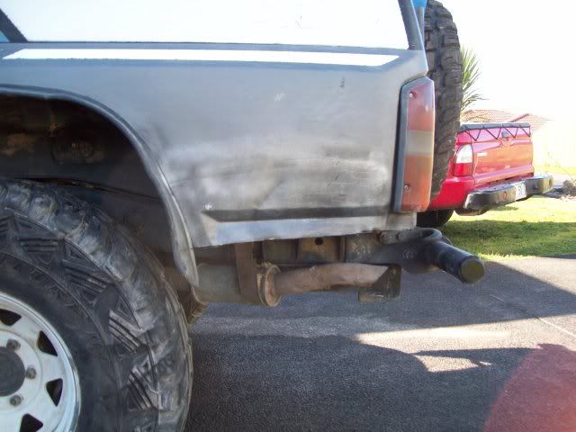

with a manual safari the joys of first low and slowly wander down steep hills is so nice
today a little cutting
where did that lot come from
done

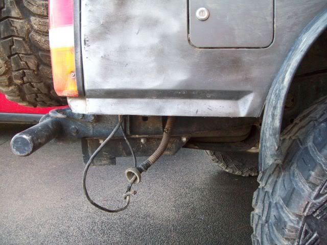

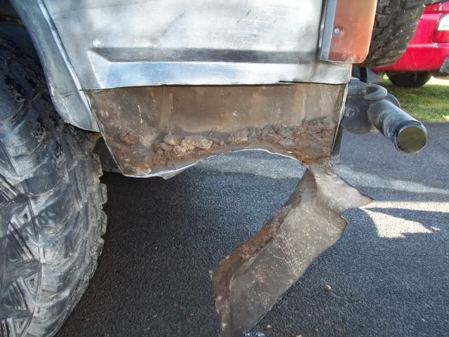

Re: 6th & 7th June
otherside
more crap inside
all cut plus the cable

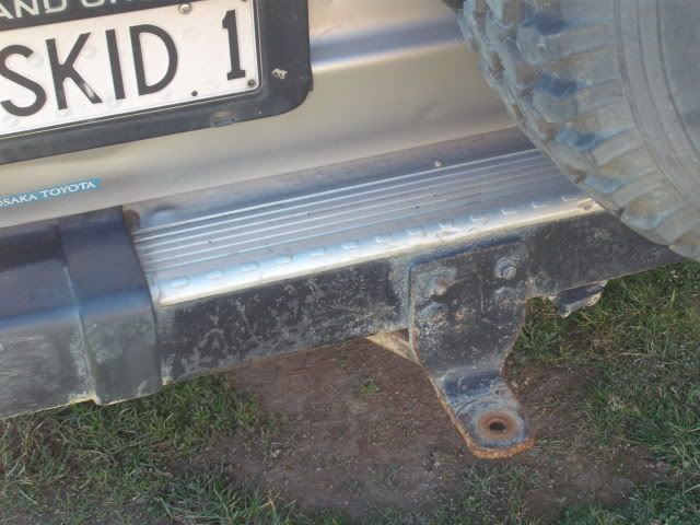

went to work for half a day and then was clearing up the shed and found my old racing wheel, so decided to chuck it in the 80. cruiser wheel 395mm, racing wheel 330mm. so quite a difference.....................
also took the towball off the rear as per the request of the organisors of next weekends safari. Was going to put a shackle and rope on there, but the hole was smaller than the shackle, so it didn't happen. I can see a pintle hitch reciever coming very soon I think.........................
didn't really have any plans for tomorrow, other than more cleaning and a small job involving putting the cruiser wheel back on. :oops: :roll: Bloody small racing wheel is cool but impractical. sits too close to indicator stalks, kept flicking high beam on, horn dont work and indicators don't return. I knew that would be the case, as I've tried it on other cruiser before. :oops: :roll: :mrgreen: :mrgreen:
