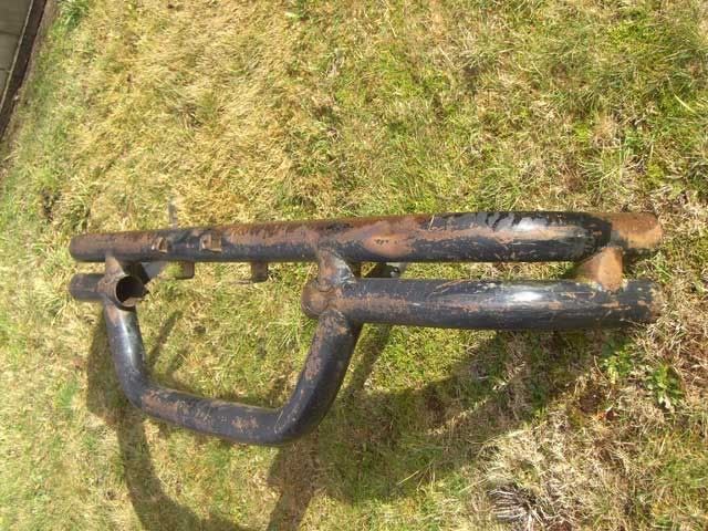

Right-o they came looking like this^
And after 2 weeks in Taupo I finally have some decent weather. So I took to them with a cheap repco wire brush (which broke :roll: ) and some elbow dust!
After a brush/sand and wash they still look a touch rough :lol:

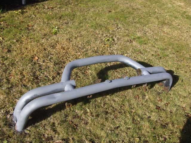

First half coat of Primer.

Post by haydgq »
I would of used a Rust convertor on that bar before applying Primer and a top coat as that rust looks though it will keep on coming through eventually, Tergo Black Guard from Mitre 10/Bunnings is awesome stuff and it converts the rust to a hard black finish that you then primer and top coat. :D
