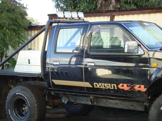

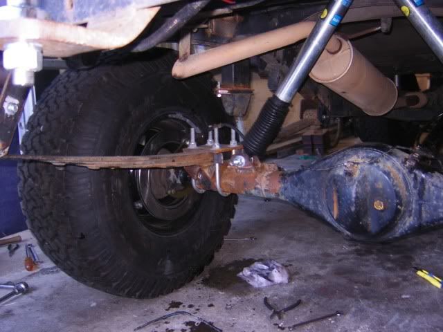

well more of an update,been a good weekend id say,worked on truck yestaday and today,got the front plate mounted and idicators put in aswell as mesh leaving the front looking alot better off
have now 90% sorted the fuel filler pipework,just gota weld a 90degree bend onto the straight pipe which screws onto the deck the shes sorted
have fully welded up all the leaf mount brackets (are yet to add extra plates for strengh but have started cutting them)
also the deck edging has been cleaned up and straightened plus have cut up the angle iron pieces and painted them,will be picking up bolts and they will be bolted on wed / thurs morning,have also cut up some more garden edgeing for the rear flares and also the clamping plates which will hold them

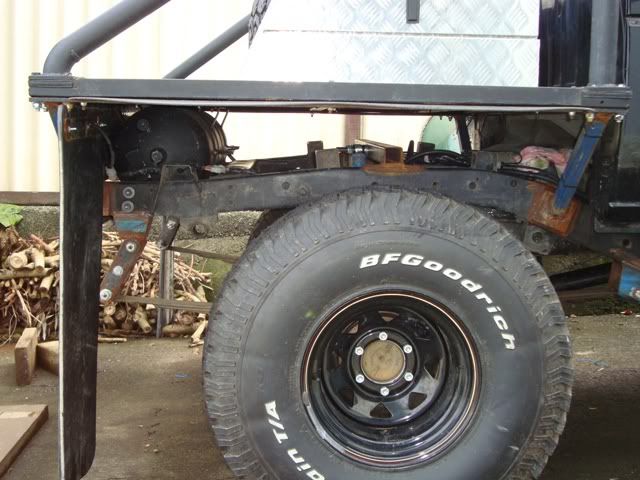

rear mudflaps have been eyed up :lol: so will be getting some material for that this week aswell and are planned to be on by the weekend

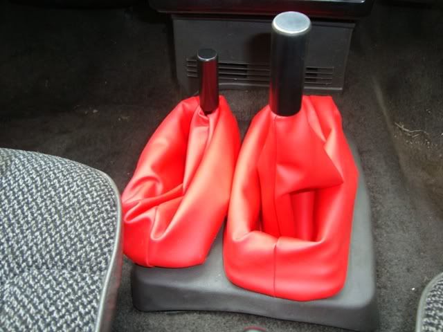

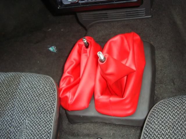

what else,original gear stick boots have been cut off and replaced by a pair of material boots made up by the mother n law :lol:
so yeh,not a bad weekend,think it was anyway and forward progress has to be better than backwards :lol:

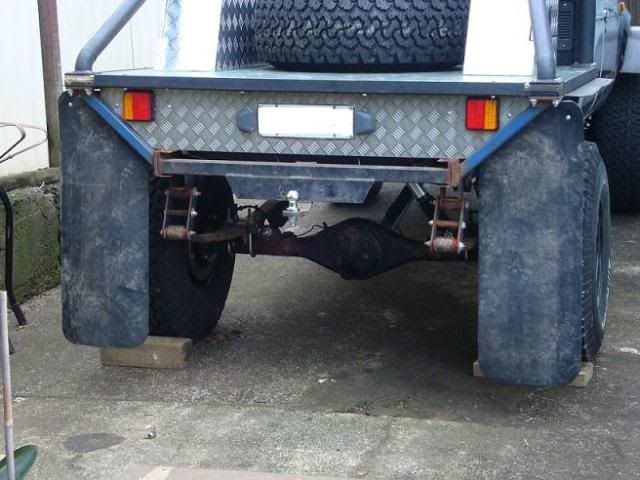

well more of an update,had a couple of weeks where nothing happened due to ral work getting in the way but we have now made good progress again
rear spots / reverse lights are on and working

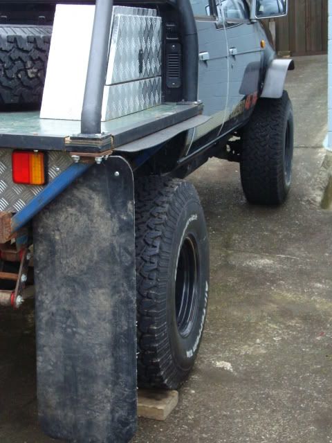

rear mud flaps are on and complete
rear flares are now on aswell

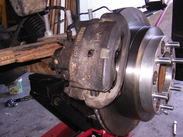

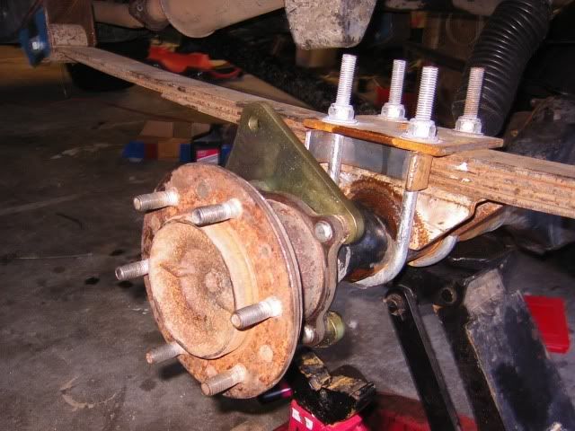

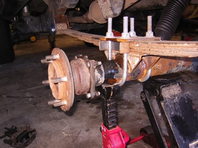

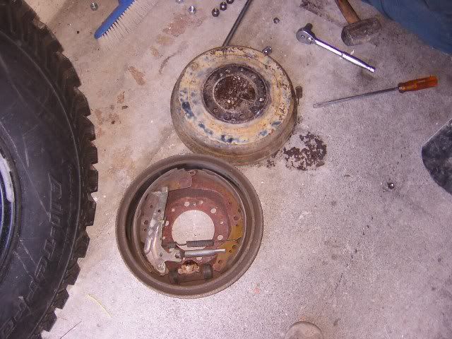

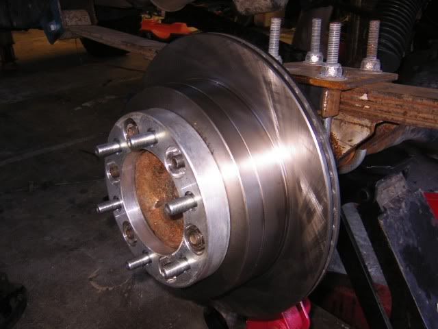

rear disk conversion has just been done this past weekend,below are the step by step pics(kind of)
drums removed
axle ready to begin the bolt together process
new mr2 plate attached
disk on
spacer bolted on
caliper on
and the final product

have to make up 2 new gear knobs

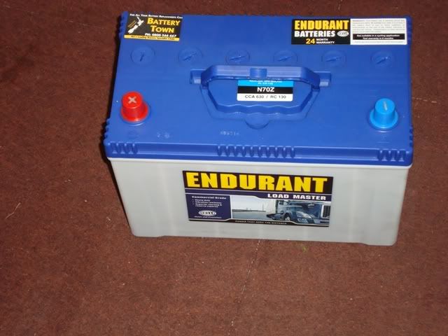

well next update,havent got a huge amount done as ive had the flu for a week and then just been in hospital for a week getting my gal bladder removed but my brother n law has been moving forward well,new gear knobs i turned up we put on

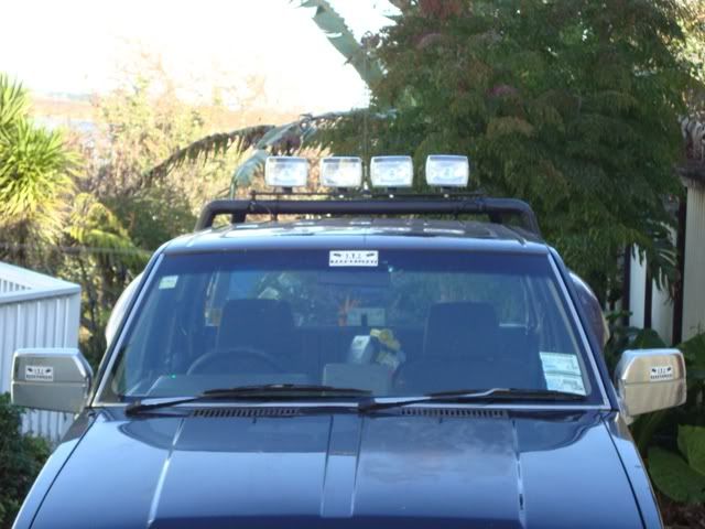

also had some new parts arrive,big arse ns70z battery as the current battery is dead

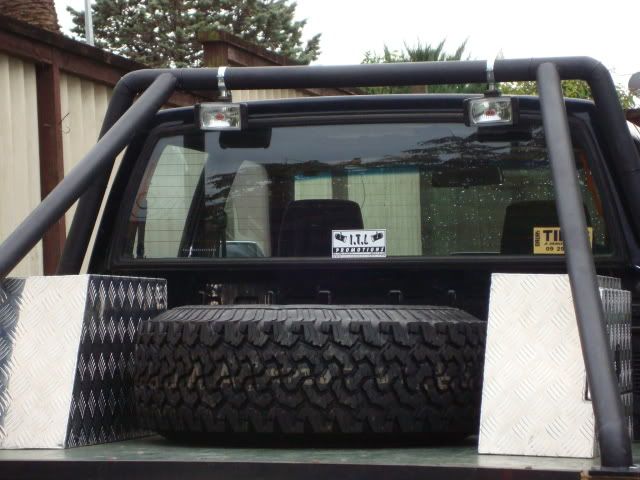

new spot lights arrived,decided to go for the narva 160/115 broad beam and a pair of 160/115 pencil beam to get a good light coverage
after getting the light we got them mounted up on the roll bar bracket along with the cb aerial

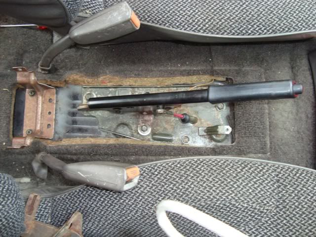

well more of an update as promised,heres the cb that oscar set up the other day

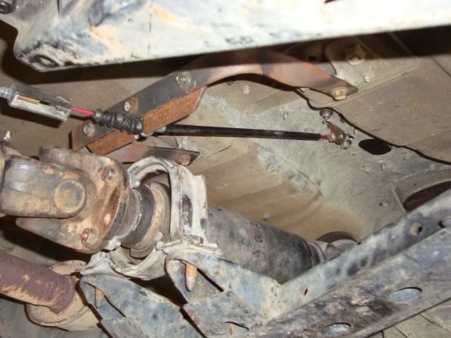

also heres where the air tank is finally positioned which one of my mates pointed out you couldnt see,oscar also got the air hose and fittings in place and attached so the on board air is ready to charge as soon as its all wired up which is good and anuther step forward

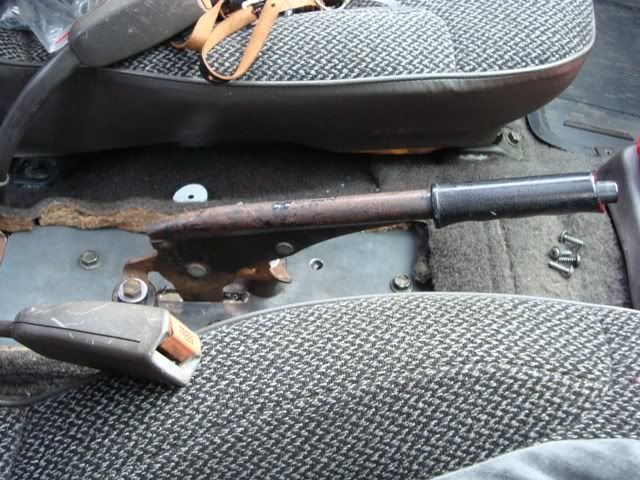

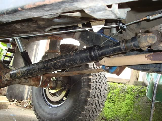

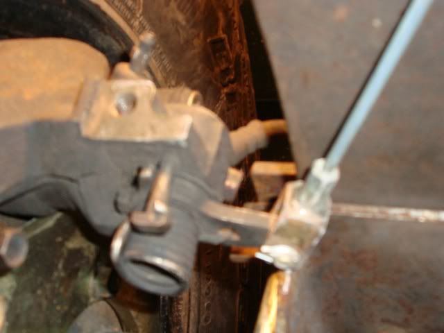

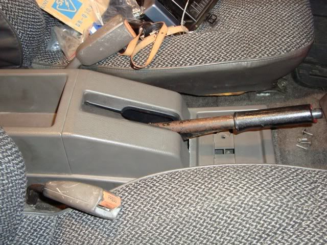

and as for the handbrake we measured up the cables and got the 2 to 1 made up which cost us $150 from auto stop
from there we conected and tried but unfortunatly due to the design of the original handbrake cable going forward then looping back it had too much friction on the inner edge of the curve as you can see in this photo

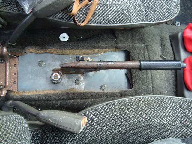

from here we went to pick a part and got a through the floor stait pull handbrake for $7,a 150x350x3 plate for $7 and put it together to get this
we then modified the original cable at auto stop for $50and put in a bracket and got this
now the handbrake works mint in all positions,depending on weather your on a hill or not its one click more or less but that means nothing,the setup is right up out of the way and for about $225 all up where both realli pleased ae

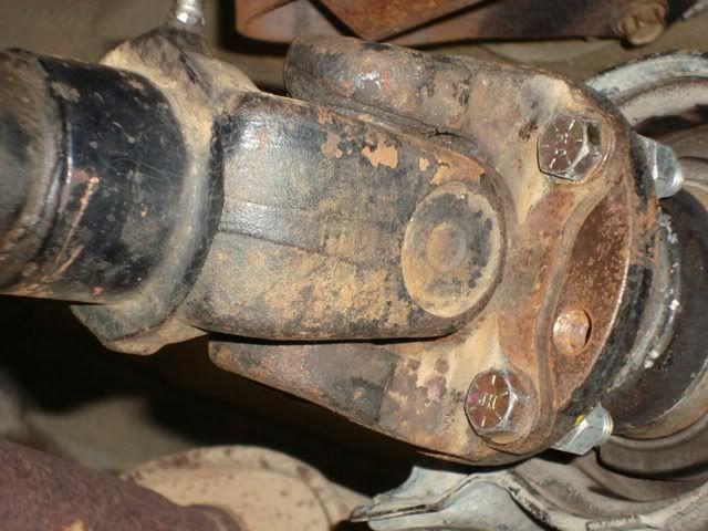

also heres a photo of the modified driveshaft flange that we got redrilled to suit the toyota PCD

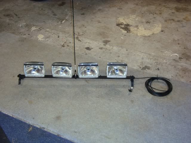

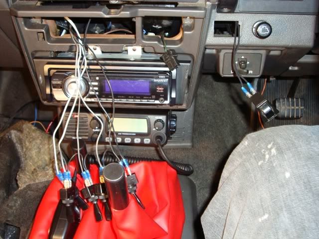

well this is the most updates ive done in months but it shows works being done :lol:
last night we got the new batteryu in,also got the light bar mounted
we also ran all the switchboard wring and put in the fuse box
we also modified (cut) the original handbrake surround and got that fitting nicely and looks pretty standard
we also removed all the original air intake plastic piping in preperation for sorting out the snorkel and also looked into and made drawing of new box section that were going to make up to straighten up the rear shocks a little as we have time,not a hole lot of work but every couple of hours add up

well anuther good day yesturday,got all the wiring done for spotlights and dam they are mint,so bright compared to what either of us have had in the past,also got last 2 goles in tow bar drilled and now thats all bolted up nd sorted,cut to length a hole lot of deck bolts aswell as the shock bolts so the threads dont get caked with mud of damaged,also sorted out cb aerial and tested that,goes bloody mint,also got extra bit of 5o box cut to length and reflexed the truck and are now ready to drill holes then will stick bar on top of current shock xmember and straighten up those shock angles,quite a resonable amount actually and will give alot better performane,thats most jobs we got done so both very happy and still moving forward,oh we also got parts list sorted for snorkle so will be getting exaust bends etc and getting that welded up and mounte hopefully by end of this weekend,of and also double checked bolt tightness on shackes and greased them all up :lol: small job but a very importand one if we want good flex and dont wana be replacing bushes al the time

How do you find your hand brake?
And what type of pads are you running?
Well done on the build m8! Looking good.

hey mate,yeh its not too bad,on the flat its couple of clics,up hill its a few more than on flat and down hill it a few less but it does hold,with the angle we have it aint all perfect,im considering making a couple of brackets to get a better line of pull but it does hold on all things weve tried it on,also with all lines being new they aint got much stretch in them so were waiting for them to stretch some more then itll feel more like a normal handbrake,pads are the ferdo,ferado? ones from repco,the box said they were supposed to be the turbo ones with the chamfered edge either end but they actually the non turbo ones with square edges,seem to stop the truck quite well but weve only done short tests,once its on the road we may finsd theyre no good and upgrade to some higher performance type,bit of a wait and see game,
and cheers mate,were both pretty pleased with how its turned out and performance wise its alot better than we expect so definatly cant complain :lol:

Re the pads. I had pads that were great once you got a bit of heat into them. But when they were cold they weren't as good as the standard set I have in now. It's a bit of a trade off.
As for the angles and leverage points for the handbrake? The MR2 rear calipers that we had installed are one complete unit. No angles to have to play with. It's all there, just bolt it on and go!

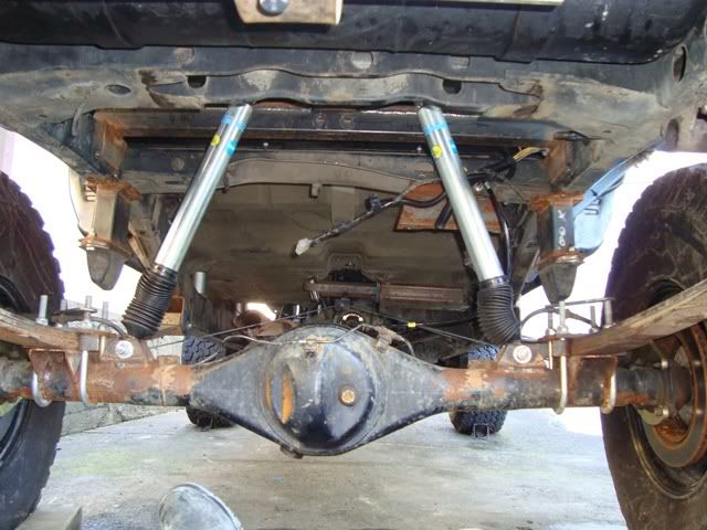

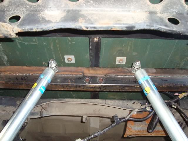

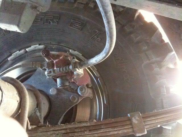

ok well heres a bit more of a close up of the cable and caliper without the bracket attached,like i said in my last post where more than likely going to add a modified version of the bracket and get the cable slightly re routed to give a better line of pull
and update wise weve finished moding the rear shock xmember to how we wanted it to be in the end,heres the xmember
and heres the new shock angle which is alot better than what we first set up as a dummie to get it moving

quick question,what rotors did you use?terrano ones or somethign from a different vehicle?any reason you used the mr2 calipers?
as far as doing the mod itself,any tips or tricks you learnt on the way you wish to share?

hi nav2NV,we used prado rotors,can get more details if u need them,and mr2 calipers as we purchased the adaptor kit from jafa,his kit is designed to go with hilux / surf axles so it was the easyist way to do it rather than redesigning our own thing,as for tips or tricks,um cant really think of any major discoveries we came accros sorry,all went to plan,taking your time to set up the shackles at the correct angle is the main thing really
