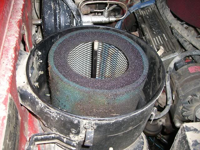

I got one of these of Rob (Naenae Tyres), washable filter...
the leading edges of the filter will need sealing but this is a 2 min job with a finger and some sealer, the pipe you can get from a place in the hutt road....(otherwise I may have a bit left)
I also run a "snorkel sock" at the top of the snorkel ....which Rob has as well

Thats quite cool Jerry, I have a use for that on another car! But for the cruiser I want to keep the big factory air 'box' to catch any water or wild life that goes into the snorkel so need something to fit that.
I did think about cutting a hole in the side of the air box and welding in a 3" steel tube then mount a K&N pod filter inside. But would be hard to make the lid seal since I wouldn't be able to use the centre bolt/wing nut because the pod filter would be in the way. If that makes any sense!

Jerry wrote:I got one of these of Rob (Naenae Tyres), washable filter...
We've spoken about your starving filter before, but for your benefit and others, I will repeat myself and add a little more.
There is No Way that your engine will be able to flow anything like the airflow it needs through that black, I assume carbon fibre, air-box. If it had no filter in it, it may but probably not, and what's the point.
Think about the size of a typical filter on a V8, about 50 to 75mm high and about 350 to 400 outer diameter. (air flowing from outside filter through filter) That is a cylindrical surface area of between about 55000 and 95000 mm2
Your set-up looks like 130 high by about 75 inside diameter. (air flowing from inside filter through filter) A cylindrical surface area would thus be around 30500 mm2
Therefore your filter is about 30 to 50% of the size required going on a cylindrical surface area.
However the above does not include the depth or thickness of the filter.
In the case of a normal style V8 filter, about 50mm
and with your bling thing about 15mm
So V8 actual filtration area is between 2750000 & 4750000 mm2
bling thing filtration area 457500 mm2
So really your filter is between about 9 to 16 % of the filtration surface area that you require!
More to come on other installation bits later.
Jerry I would suggest yoy go buy a filter that will not reduce your torque HUGELY nor richen up the air/fuel ratio massively.
Cheers Johnno
