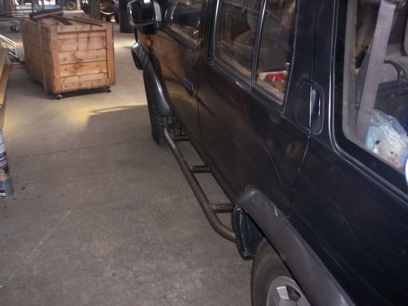

sliders to suit torranno

coxsy wrote:sliders to suit torranno
I see you have made two left hand ones. :shock: Maybe when you make two right hand ones we could come to some sort of deal? :wink:

na left an right just sitting side by side :D
do i have to remeasure them and make a drawing incase i have to make another set, then again not sure your torran is the same as these are for

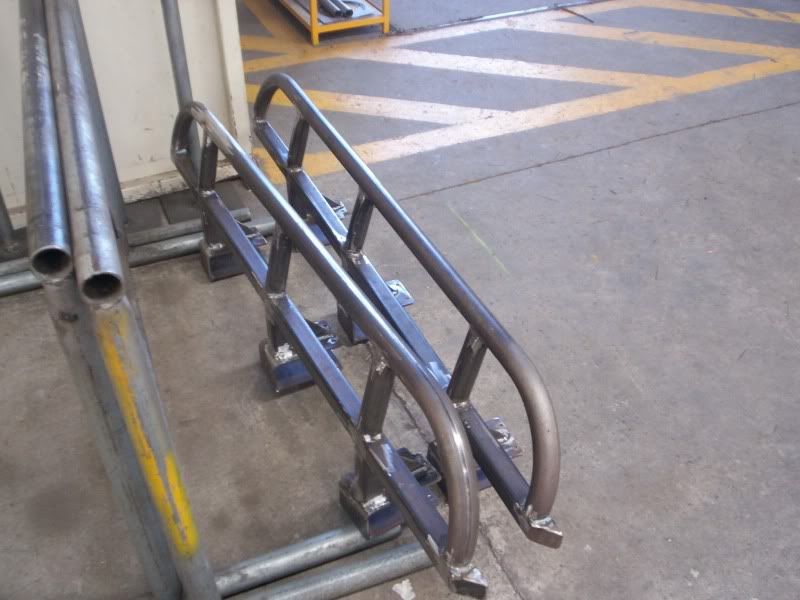

what dimensions are the pipe and box section, was gona go 4mm wall on my ones but thinking again might be an over kill, but then again, no problems with over kill in the engineering business aye!!

Re: knocked these up
they are 3mm wall, the trucks heavy as now , hes not a tuff truck so anything is better than stock running boards :D

I assume that the 25 x 25 is also 3mm or is the whole thing is made out of 3mm wall tube and RHS and the bits that attach to the chassis etc.

coxsy wrote:na left an right just sitting side by side :D
All Terrano chassis should be the same, its just the running gear and bodies that are different.

my guessings are chassis size 135 x52 , from chassis to pinch weld 135mm total lenght of the slider 1600mm
there is no 25x25 in these, 40x40 + 40 od pipe and few bits of 6mm plate
yes we have pipe benders threaders and all sorts or engineering tools , hans is coming down south a xmas wants to come and see you with his modded steering have a look then :D

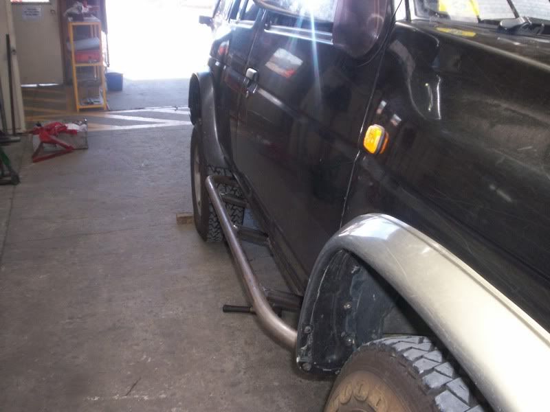

What are you cladding them in?
When they are wet, open bars like that are just waiting to snap your legs and ankles.
I have open steel grate on my 'lux and have just finished some with alloy checker plate for the prado.
Other than that, they look real nice. As I have said before, I honestly believe that a good set of side bars and sill sliders are the most useful protection addition you can make to any 4wd.

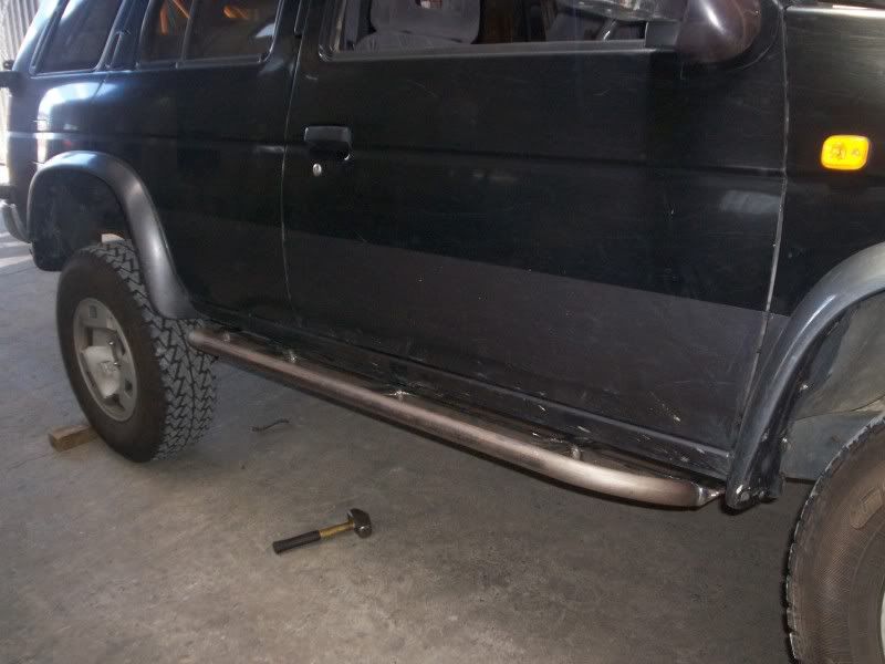

wasn't intending to clad them, 12 bolts and nylocks hold them on , falling off is not on the plan :D

coxsy wrote:wasn't intending to clad them, 12 bolts and nylocks hold them on , falling off is not on the plan :D
Think he was meaning slipping off the bars when you put your foot on them and having your leg slide through??
people think slipping is a proplem with these sliders never slipped off mine, nor my son or wife who sits in the back of my swb saf, its a small step , nothing more,

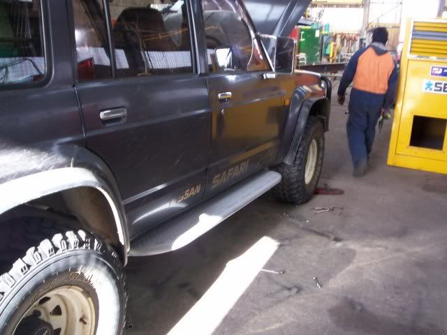

add 3mm checker to these ones man they were heavy but on a lwb safari.
a day on my back under the dam thing to get the u brackets to fit, you measure the chassis hight but nissan add a ridge that need another 5mm on top of what you measure, its got me twice now . also no room on top of the rail to get a bolt and have steel to retain the bolt is a interesting job
the rhs or box section is 50x3mm pipe is 50mm OD plate is 6mm :D
Post by Hombrey »
yeah they look pretty cool. got a set on the safari but the pipe is 85mm :shock: OD. Top is covered in checkerplate. Big but man they have hit some stuff. Also keep small trees off the panels as well as clay banks! Just have to lug a little more weight.
