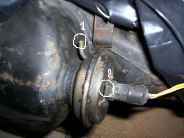

constant vacum on the inner tube 1, an
small puff on the outer tube 2
Re: diff locker
so think the valve not exhausting the vaccum to let the locker disengauge

coxsy wrote:so think the valve not exhausting the vaccum to let the locker disengauge
swap the vacum lines round see if it unlocks?

all lines were clean its the mac valve i got to control it swapped hose over open now , will see mac next week for a better valve no addmit didn't check out just bung it in , :D jees i can be ruff

went and had a chat with the MAC valves guy,got some ideas cheched them out , plumbed the valve wrong will finish tomorrow and see if its a goer :oops:
Re: diff locker
SORTED :D :D
