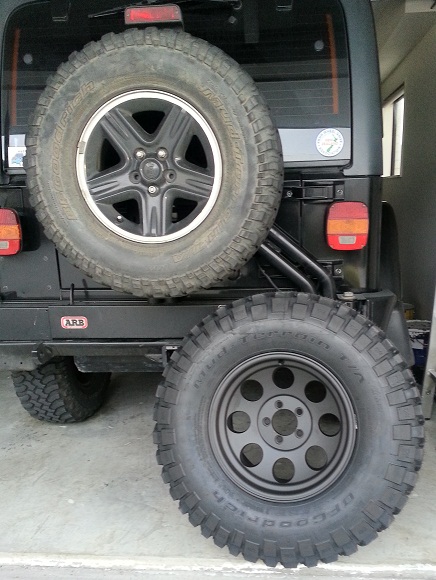

Last weekend I had picked up my new rims. They are Pro Comp alloys (16x8").
Considering which tyres to go with. Thinking between two options, Silverstone 117 Sport (nice cheap) or Mickey Thompson Baja Claws (pricey).

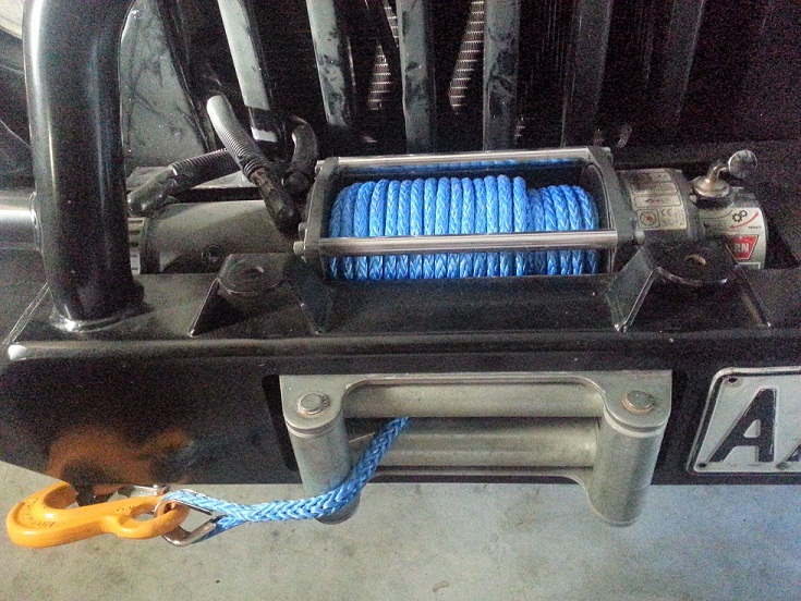

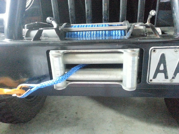

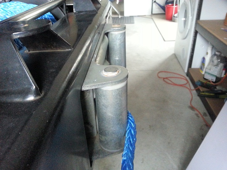

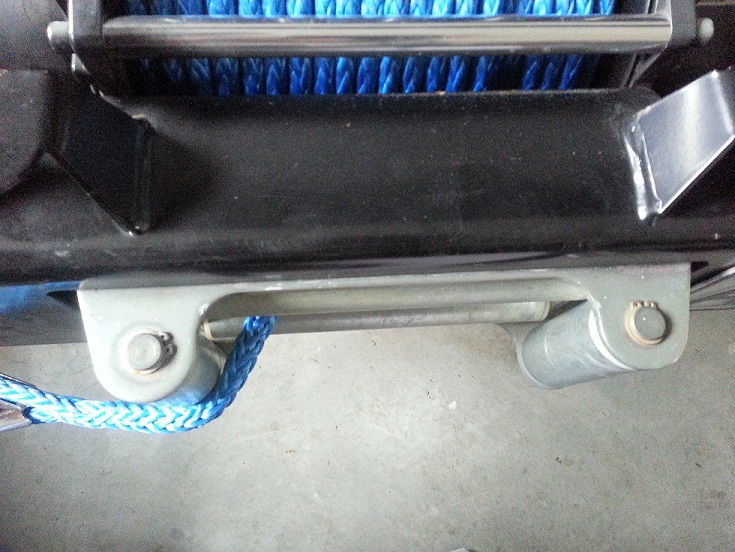

Swapped the wire rope with Amsteel Blue synthetic. For the time being I have left the roller fairlead on, but I am looking for an aluminium one. The problem though is that ARB bumper mounts the winch in a way that the fairlead is recessed by 1 3/8" inward. The thickest aluminium fairlead I have found so far is 1 1/4" thick. That would lead the rope to rub on the bumper edges when used at angle. Yes, measurements are in inches (its a Jeep after all).
I have put up a few photos for ideas.

Unless the rollers are chaffed from wire rope, I'd just keep them, they are far easier on the rope if you are pulled at all sideways as the radius is greater.

NJV6 wrote:Unless the rollers are chaffed from wire rope, I'd just keep them, they are far easier on the rope if you are pulled at all sideways as the radius is greater.
Rollers aren't bad. But if I can find a better solution with less parts to go wrong, I am open for ideas. Aluminium fairlead 1 1/4 inch thick looks workable with some spacers behind.
Re: TJ Build
as above that fairlead looks in pretty good nick and should work fine so long as theres nothing for the rope to catch or rub on TJ :D

Sadam_Husain wrote:as above that fairlead looks in pretty good nick and should work fine so long as theres nothing for the rope to catch or rub on TJ :D
Ok then, I'll leave them alone for now. These look like another alternative:
These are Daystar's Synthetic Winch Rope Roller. You just take the steel roller off and put these in. Converts the old steel rollers.

Finally got new tyres fitted on the rims. New tread design is so much better at braking in wet conditions, its like I have completely different brakes now.
