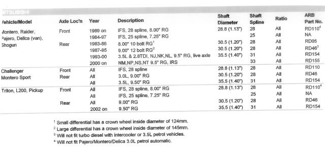

Morning guys just wondering if someone can help me with info or a site where I can identfy diff and axle codes for mitsubishi pajeros. Thanks

Look on the plate under the bonnet, it tells you the diff ratio under trans axle.

The plate says V5MT 1 5285. So what does that mean?

sounds like a swb diesel 5.285

v5mt1 is the box code, 5.285 is the diff ratio.
