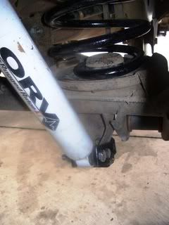

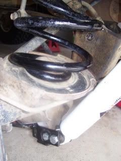

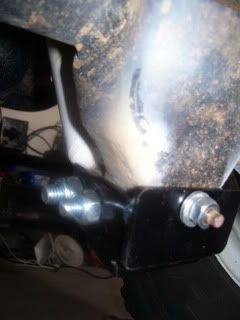

2.10.09: Removed rear springs and took them to "springtown" to get one retensioned and to have the top coil put back where it was supposed to be. While taking them out i noticed that after fitting the adj upper arms on the rear, that the shocks now rub on the bottom spring mount.... grrrrr
3.10.09: Made up some shock relocation brackets (damn site cheaper than buying them!) and fitted them along with the springs (not alot of improvement with the springs... might be time for some new ones)
Springs and new shock mounts

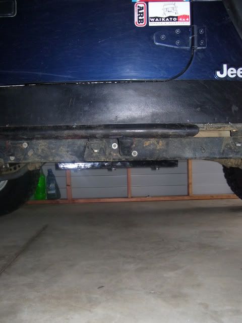

Just had to have a tutu and emended the tummy tuck by taking off the top 2x1in box-section.
Aside from having to apply some pressure to the exhaust pipe to get it off the heat shield it went in all good. Theres now a "noise" and a slight vibe coming from somewhere but buggered if i can find it. Feels and sounds like when i first fitted it and the exhaust was in contact with the chassis and hence vibing up through the body. Cant find any unusual contact anywhere.
So....... finally finished the mods. Now its time to actually drive the thing.
