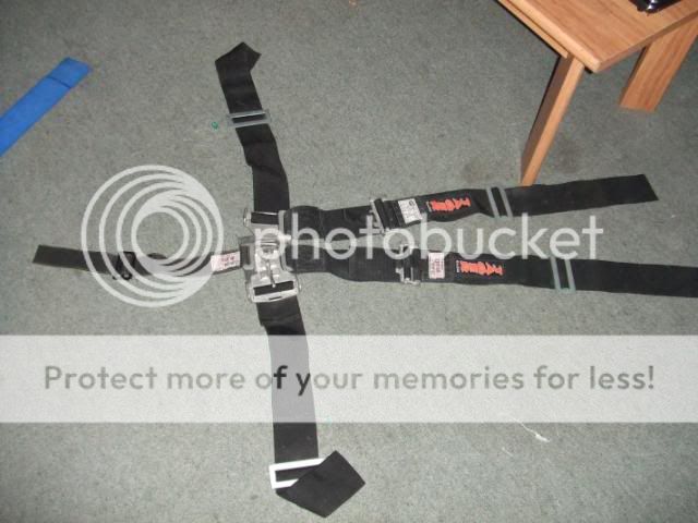

Also scored a pair of 5 point harnesses of a mates old man. Theyre expired ones out of his sprint car, will do nicely in my 40 :wink:
Didn't barbie drive a jeep??

New 2nd hand harnesses

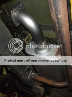

Got the new ehaust made up. What a mission getting it to fit where I wanted it (Higher than the chassis rail, protected by the rock slider) Give me a truck to work on any day. But got there in the end an it worked out pretty well.
2 1/4 pipe with flexi an flowfast muffler
Just got to put it back on tomorrow an see how it sounds
