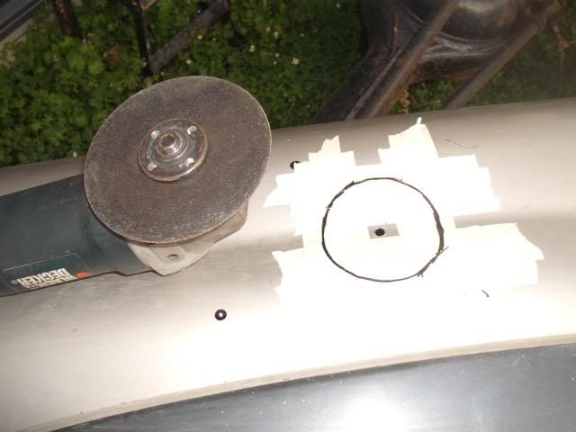

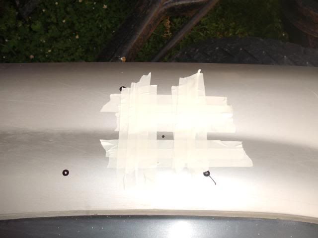

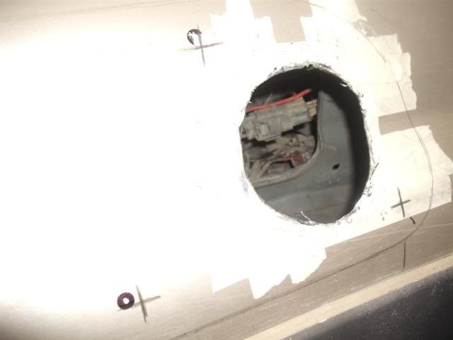

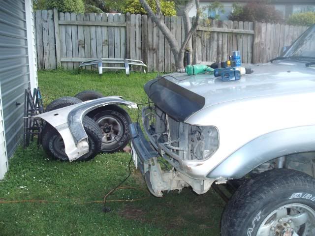

righto then, I caught up with Sig today and borrowed his hole saw, then got home and spent a few hours drilling, cutting, cursing, drawing and generally getting faaarked off the further I got, but I made it.
It started with an empty canvas and a few tools......
all taped up and ready for the holesaw......

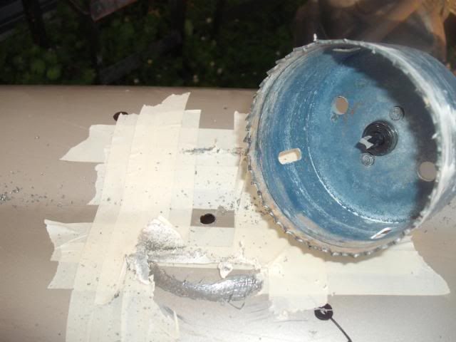

Bloody holesaw moved around too much and made a bit of a mess before the drill bit broke.....
So I taped it back up and drew another circle and then remembered how good I have cut circles in the past and the method I used.....
not a bad effort.....

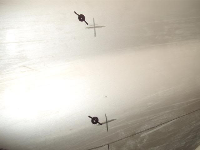

Trial fit in hole, perfect fit, so check to see how the holes lines up from the pissing around with 2 templates.....
The holes were a wee bit off. Original holes were the vivid circles and the actual locations needed to be where the pencil crosses are.....
So after drilling the holes and stretching them all a teeny wee bit, we have a snorkel that fits, without too much carnage.....

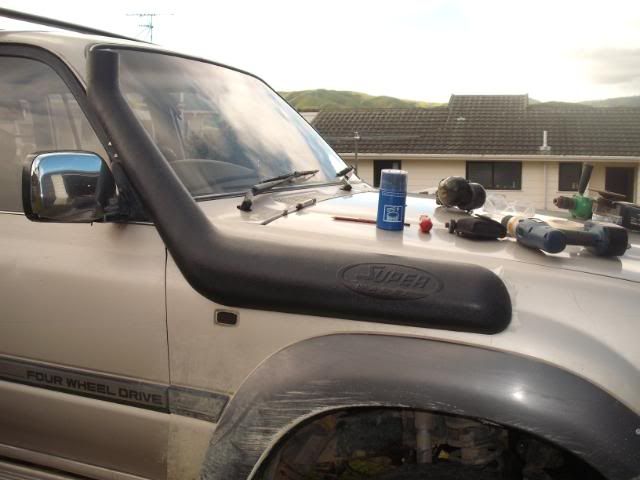

So there ya go, I now have a new template that I will send to the supplier so that the next 80 series snorkel they sell will not have the owner tearing thier hair out like me.
Its only bolted in place at the moment, I still need to fit the little plate that bolts to the A pillar, which is looking like another mission and then pull it all apart and clean up any bare steel and fill holes with sealant and put it back together and the attach it to the air box.
Its been a mission, and for those of you who know me, you will know how non-mechanical I am and how tricky it would of been for me.
So I'm chuffed its done with no noticable damage to my guard
:D :D :D :D :D :D :D :D :D :D

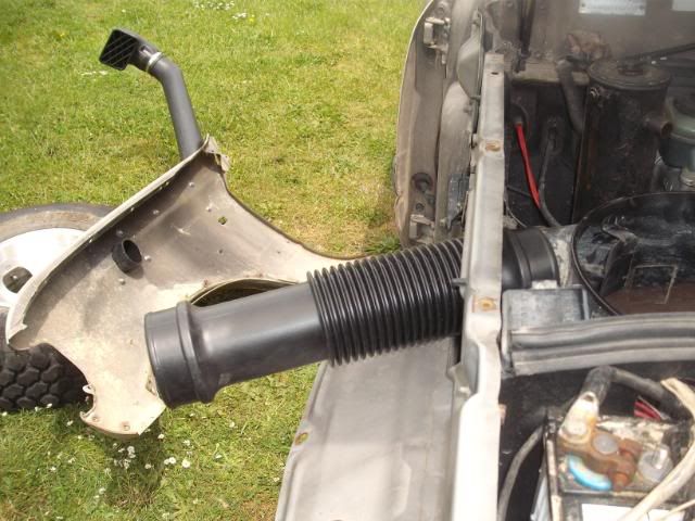

stoooopid faaarking snorkel is wrong yet again, this time the joiner is way too long for the gap
some complete fuktard must of designed this and not trialed in on a 80 series
coz theres no way its gonna work with thier bits they supplied in the pack

thanks heaps to Reece and Jerry
the snorkel is now fitted and functional
sucks air bloody good, just ask Reece :lol: :lol: :lol: :lol:

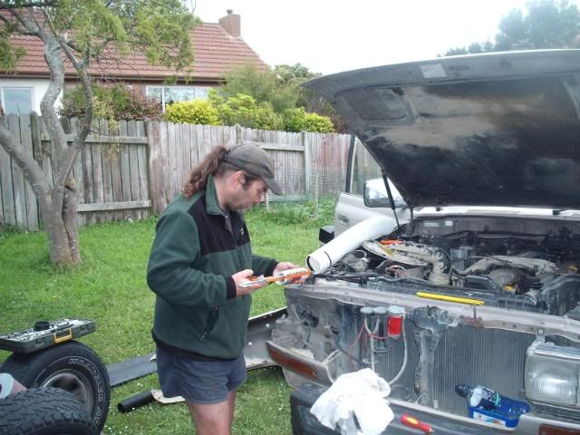

I will post some pics up later on, but all I can say is that unless, these guys can show you pics of the snorkel attached to a vehicle a give you an assurance that the template is correct and the right amount of bolts/screws will be in the pack and the joiner will be the correct length etc etc etc, then I would steer clear.
Unfortunately I have been the guinea pig test for this particular snorkel, and once I can be bothered, I will send the suppliers back a correct template for an 80 series cruiser.
You will have to pay more, but a reputable brand would be my choice in the future.................

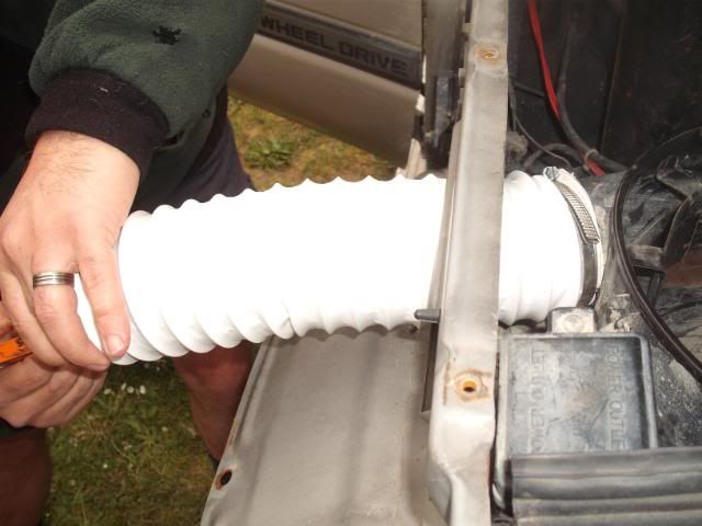

this is the joiner that was in the kit, it compresses down to 300mm long, the gap it had to fit into was only 200mm long.WTF........
Reece piecing snorkel together with the hose that Jerry bought along........

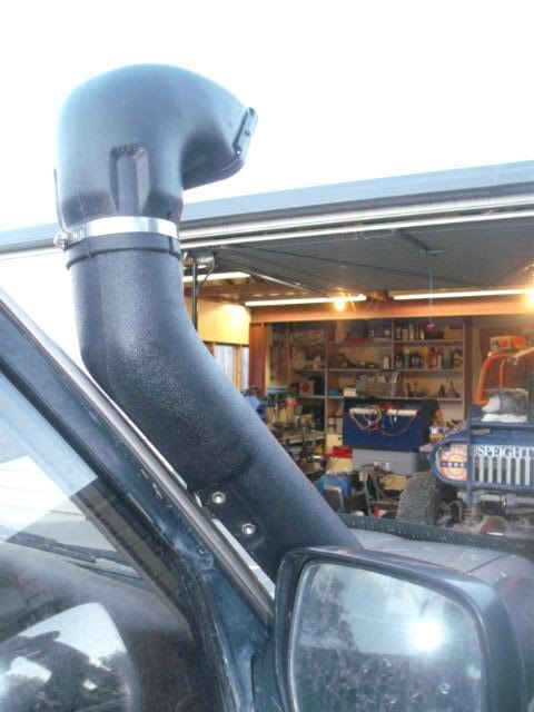

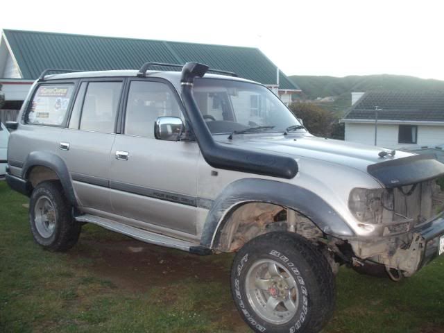

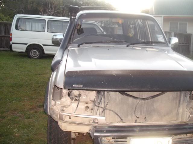

so there it is, finally all bloody done.........
