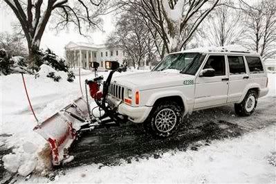

Re: xj cherokees
sorry to you jeep guys but thought you may like this

And.... your point is?

Re: xj cherokees
its a good idea for a 4wd in heavy snow in a city

Oh you were being sincere, my apologies. I read into your opening "sorry" comment that you found some kind of piss taking humour in the pic. Seems I was wrong.

Re: xj cherokees
its ok get that all the time the joys of being me :roll:
